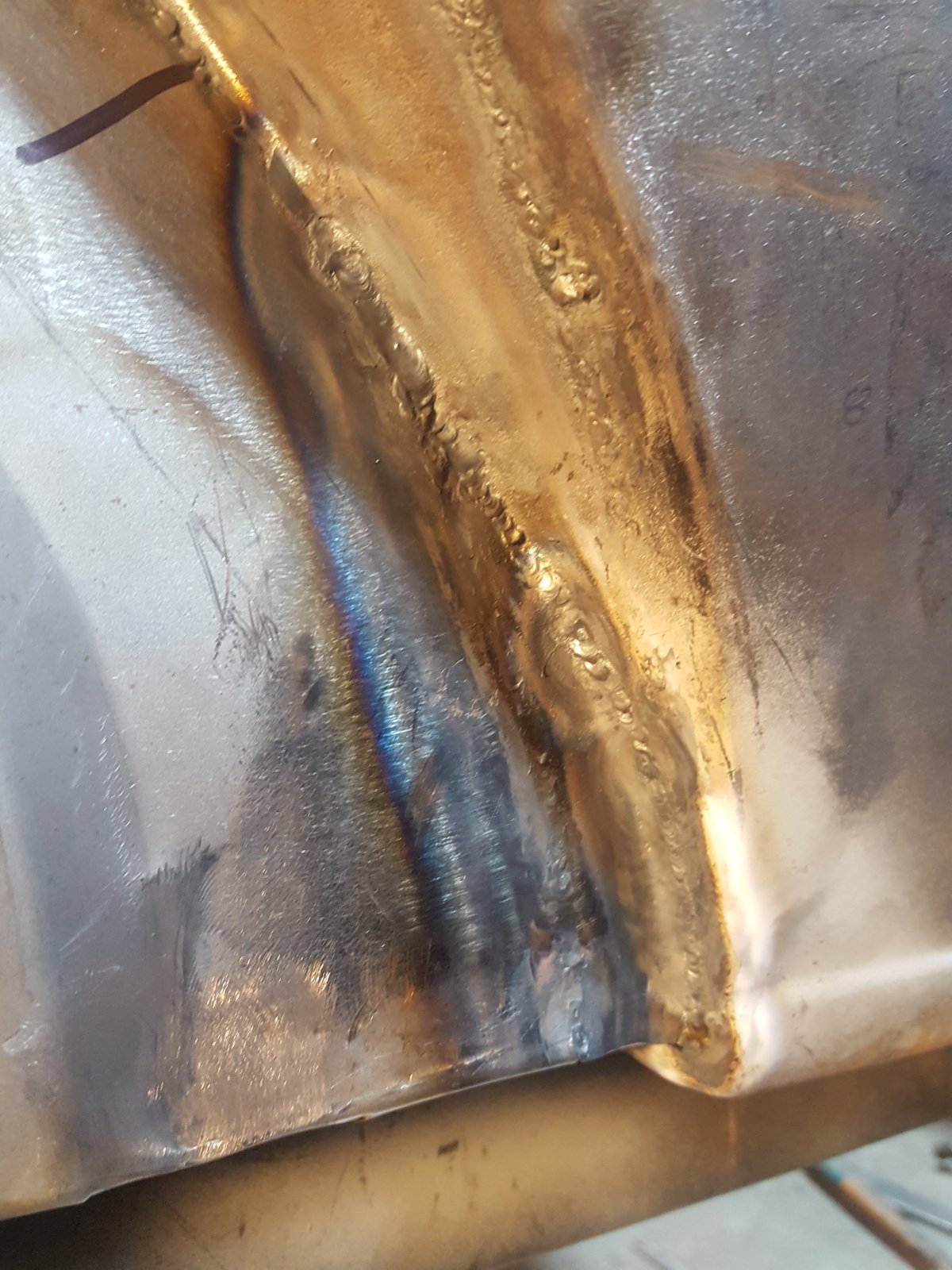

    A side note about welding sheet metal.. personally I like to gas weld sheet metal together.. at some point I was turned on to the Meco Midget torch. It's small, compact and packs quite a punch. A no. 1 tip is perfect for 19 gauge. The downside is the torch body gets hot on long welds. To solve that problem when the torch body starts to get hot(or starts to pop) I dunk the entire torch in a small bucket of water. By the time it takes to planish down a weld the torch is cool again-
    I've since become more proficient at tig welding thin material, however at the time felt way more comfortable gas welding. I'm a bench jeweler and have many years of experience in using a torch for the fabrication/repair of jewelry. Plus I find that in have much more heat control, and can run a slightly carburizing flame to get a smooth weld on steel that was at one time rusted.

    I lucked out that whoever welded in the replacement wheel wells did so with a cold weld.. this allowed me to carefully cut them out and preserve some of that area that has the radius that I was so concerned about.
    The quarter panel corners were not in the best shape.. one side I attempted to use a brookville corner patch panel, but it fit terribly and i ended up just fabricating a patch panel myself. Dealing with all of this was a nightmare , so much so that for the other side I just welded up the pin holes.

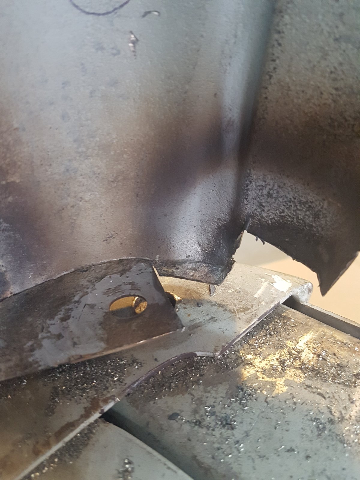

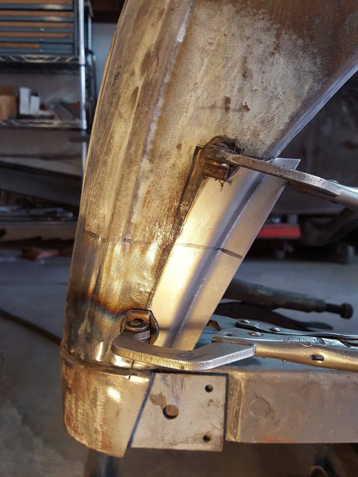

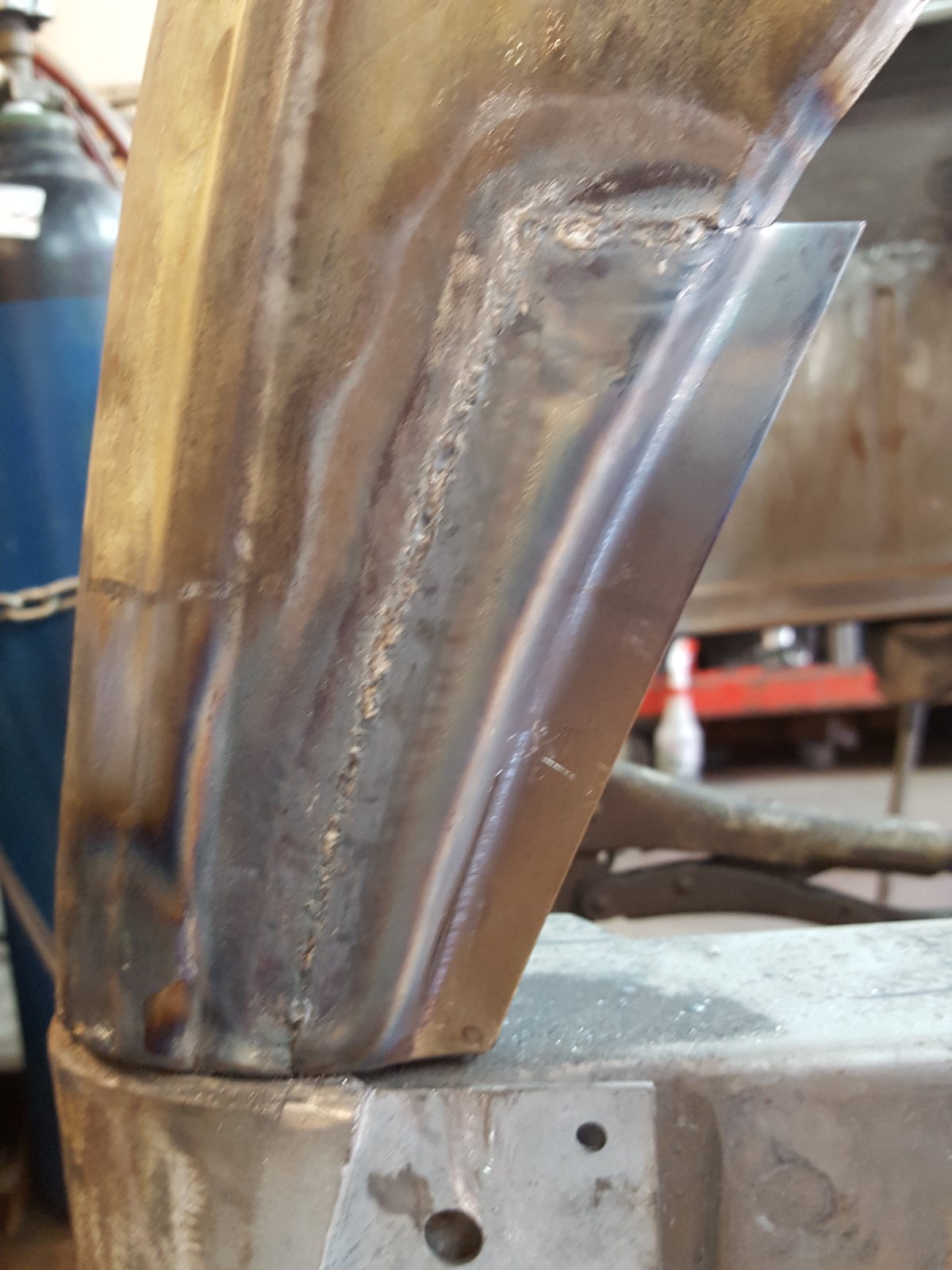

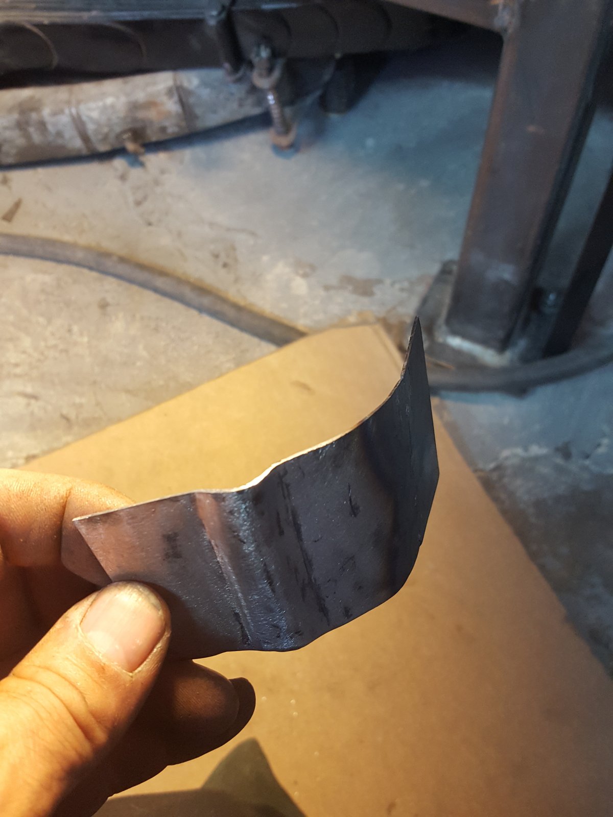

    both cowl panels and cowl posts also needed some loving. the cowl panels had some rot in the usual places, and the tops of the cowl posts were broken off. i was also missing the cast iron bracket that is riveted to the inside of the cowl post. the part that the windshield stanchion bolts thread into. Luckily i had a broken one that i JB welded back together and made a silicon mold , and cast a pair in bronze-
    Again the patch panels that are available for the cowl panels are garbage.. by the time you get the shape into them you may as well make your own, or better yet find originals that you can cut apart.
    personally i found that welding in the patch panels for the cowl sides pretty difficult, and it took me a few attempts to get a something i was happy with. Those panels are a tricky shape, and i found that those compound reverse curves towards the bottom of the panel were a nightmare to get right. Patience and not being afraid to **** **** up went a long way-
