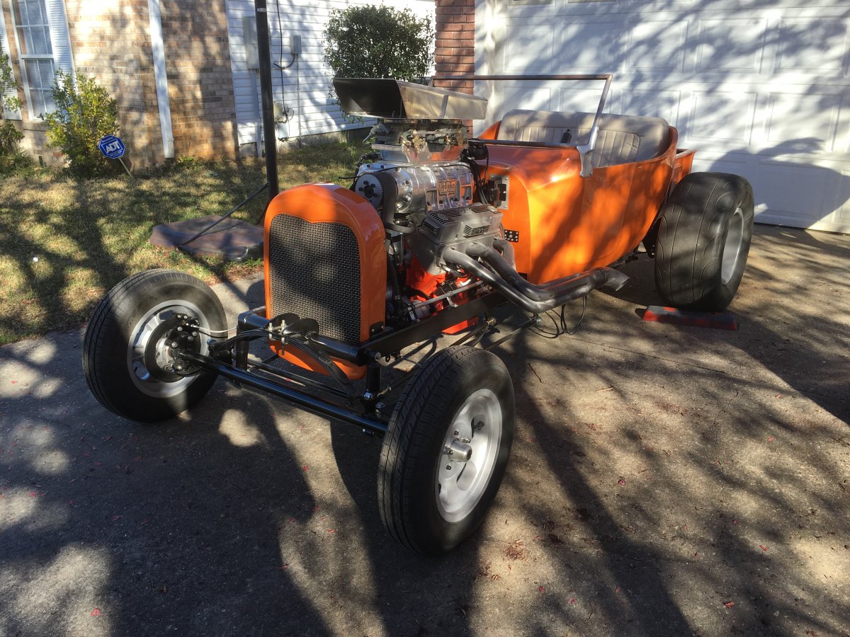

    Rfraze, you are correct, feedback has been very helpful. I think I will go with a stainless mesh for the grill on this one. And it will be street driven until I can decide how to use a period style roll bar that will still p*** tech and still be visually "right" for the car.
    As far as the spring (read here http://www.jalopyjournal.com/forum/...e-spring-shackle-angle.1007851/#post-11376512 ). I'll stick with this one. I get 39 degree shackles and 4 inches of down travel with no contact. My shocks only give me 2 1/2 inches up and down so I can't get down 4 inches anyway.

    Well, I went with a stainless mesh material. HAMBer Bert Kollar had some left over from a project and made me a fair deal on it. Let me know what you think. Oh, I added color too. Seat back is just mocked up, it will go down a few inches.

    Yes, most louvers are beside or behind the engine to let heat escape. Having them on the front would restrict airflow considerably.

    Looks good.
