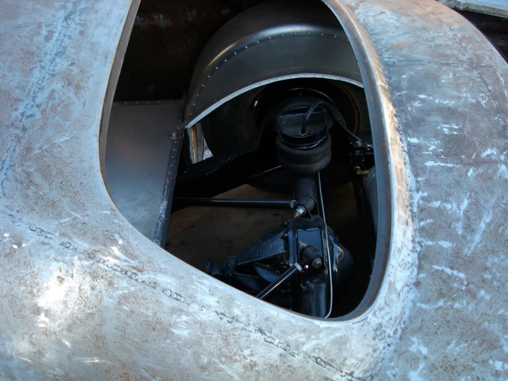

    I couldn't agree more. Also learn to hammer weld. It is provides fantastic results.
    I hardly ever grind anymore. on sheet metal. This was hammer welded and 90% of the "grinding" was done with a file. Took about 5 minutes to go around the whole window.

    Here is a 47 hood I chopped up and am almost done hammer welding back together.
  24. 37 Ford guy
    Joined: Jan 19, 2008
    Posts: 14
    37 Ford guy
    Hi. I couldn't help but notice your wheel tub. Do you have anymore pics of that. I'm building something similar for my 37 Ford this weekend. I purchased a couple of raw trailer fenders to fit into place and some sheet metal for the backs. Yours looks really nice. Would appreciate any advice. Thanks
