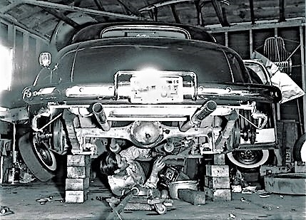

  22. jnaki
    Joined: Jan 1, 2015
    Posts: 11,424
    jnaki
    Hello,
    Without raising the car off of the ground in the rear, to check the rear end suspension or the rear axles, plus the 3rd member gearing, the sound will continue. Raise the car on jack stands and move the rear tires. If the sound comes from that section, you have isolated it. It is probably a worn our axle bearing or something else happening with the axles.
    Hopefully, the ring and pinion gears are not chipped or loose. But the moving of the tires still hooked up, will give you an area isolation sound. Metal on metal sound is definitely a noticeable sound. The rear axle takes a lot of bruising on any drive, let alone full acceleration runs.
    The 3rd member gearing is also meshing and one little thing could make that noise you hear. If you do have a Positraction rear gear set up, remember to put in gear oil specifically for a Positraction unit.
    Jnaki
    Having taken out the axles, drums and 3rd member unit plenty of times in our 1958 Chevy Impala, I was always checking the teeth, the machined ends and fit when reinstalling everything. We never had a metal on metal sound, but others that abused their sedans did have some, which turned out to be a chipped gear or something re-installed in a hurry, that led to some mistakes. YRMV
    We all have to do this checkup on our hot rods at one time or another. Doug Cook working on a 3rd member problem in his 1937 Chevy Coupe for the C/Gas Cl***. Jack stands must be holding up the frame out of the picture. (top seen on the right side behind the blocks)
    LOU WELLS likes this.
