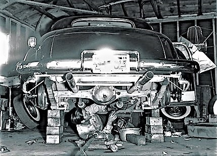

    upload_2021-5-10_10-20-30.png The small space available for our axle removal and 3rd member exchange was done in a very small narrow driveway surface. On one side, I had plenty of room. The other side in a normal parking angle, was barely enough room to take the wheel off. So, I had to angle the whole 58 Impala so there was enough room to remove both sides in one jack up, stands, attach the removal tool and pull them out in one sitting.
