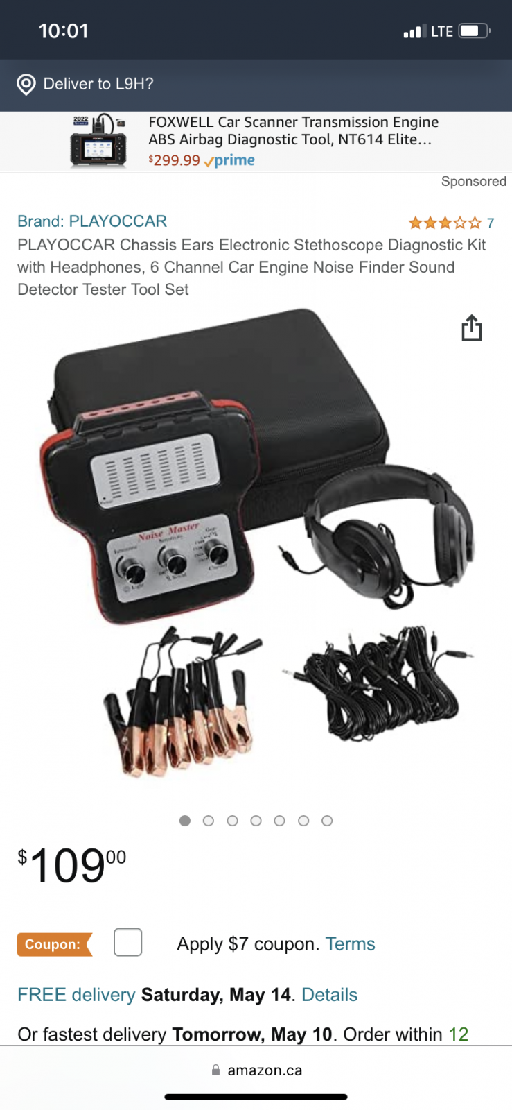

    Buy or rent on of these . It’s a ch***is ear .
    this thing saved me so much time when I worked at Jaguar looking for strange noises .
    those cars could have a rear strut making a strange noise and me and every other tech in the shop would swear it’s coming from the glove box :confused:!!!
    Sound travels and transfers and can do crazy things .
    the alligator clips have mics in them you can hook up all 6 at the same time on different parts and switch between channels while driving .
    it might even be part of a loan a tool program .
    Stop throwing money at this issue and diagnose it.
    Noise that happen only when driving are a pain in the *** to find.
    good luck! Keep us posted .

    man i saw this on a youtube channel. pretty damn neat. at this point im going to try that.

    I ain't NEVER seen no sh*t like that before. And for $109 it isn't really stupid spendy. Did you ever use this rig for chasing down wind noises?
    VANDENPLAS likes this.
