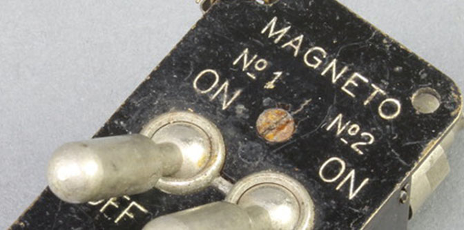

    During the recent mag refresh did you juice up the output so you might need a higher amp switch than many period pieces? I actually like the dual switch you pictured that could be wired redundant for a single mag. Having the mag switch fail ****s.

    What is currently in the car for an ignition switch? If you are running a 40 ford column drop and factory on off switch with a push ****on start, I don't know why that on/off switch couldn't be used to ground/open the Mag circuit

    I'm not against aircraft stuff at all. I'm just against themes. Some of the more subtle mag switches from WWII could be rad, but I don't want anything that dominates the dash.
    I really like the switch you linked to and it's one of my leaders for sure.
    Killer... Wish the red were more maroon in color... and it was a tad more beat up. Stupid, but it matters to me.
    I love this switch... And actually, it's period... In fact, the So-Cal Lakester had this same switch in it at some point. If I could find one for less than a few hundred dollars, I'd be interested for sure.
    Currently, have a keyed ignition switch and a home made steering column... So no column drop switch.
