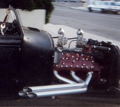

  18. 57tailgater
    Joined: Nov 22, 2008
    Posts: 910
    57tailgater
    from Georgia
    Seeing how you're going with those headers - couldn't help but think of these and how they're cut on the ends... :cool:
