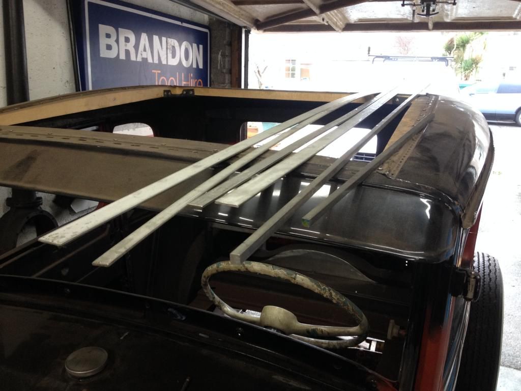

  12. In between messing with the motor i've been making a stainless steel windshield frame (pre-chopped 2" obviously) which is about halfway done.
    Starting with these lengths of stainless. 30x3mm, 20x3mm and 10x10mm.

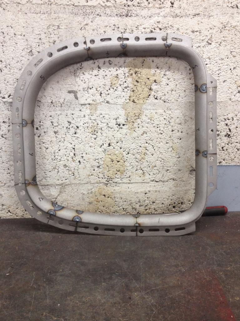

  14. Heres the main frame after hours of filing and sanding, ready for a damn good buff.
