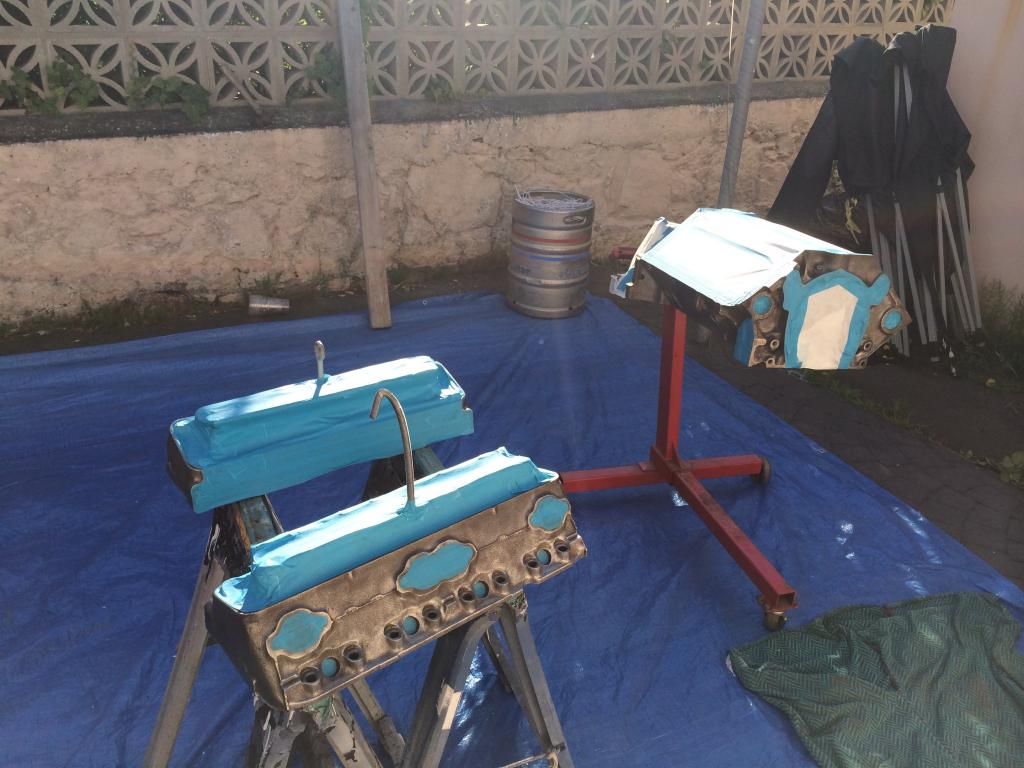

    I've also been busy painting my recently bored out block and rebuilt and skimmed cylinder heads for the 283.
    9 of the valve guides were cracked so i had them milled out and new bronze guides fitted with new Comp Cams valve springs and hardware.
    They all got 3 coats of primer and 3 coats of gloss black 2K epoxy paint in my back garden on a sunny evening.
