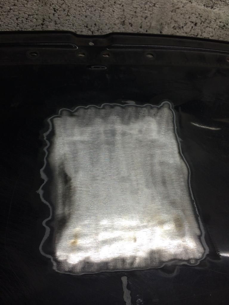

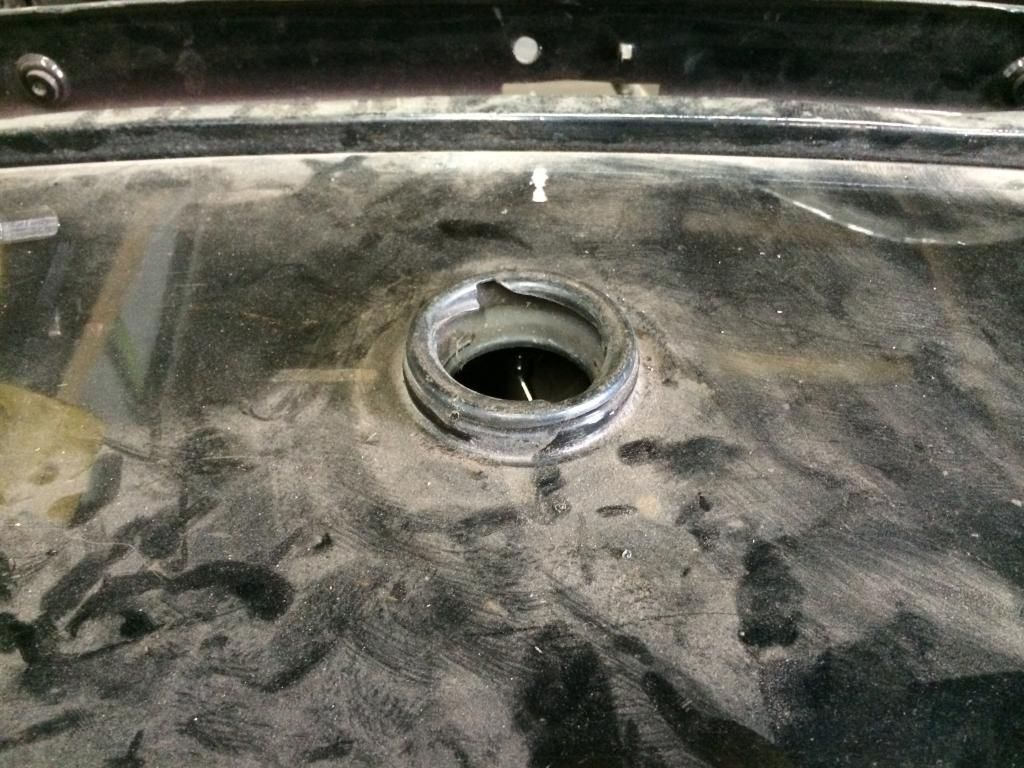

    I think a few of you are over estimating my skills a little and thinking of me as some sort of wizard or something, so it's about time i gave you an example of something that i ****ed up haha (I'm still learning, and quite often things don't go my way).
    That thing was removing the old filler neck on top of the cowl.
    I removed the old one with a 3" hole saw

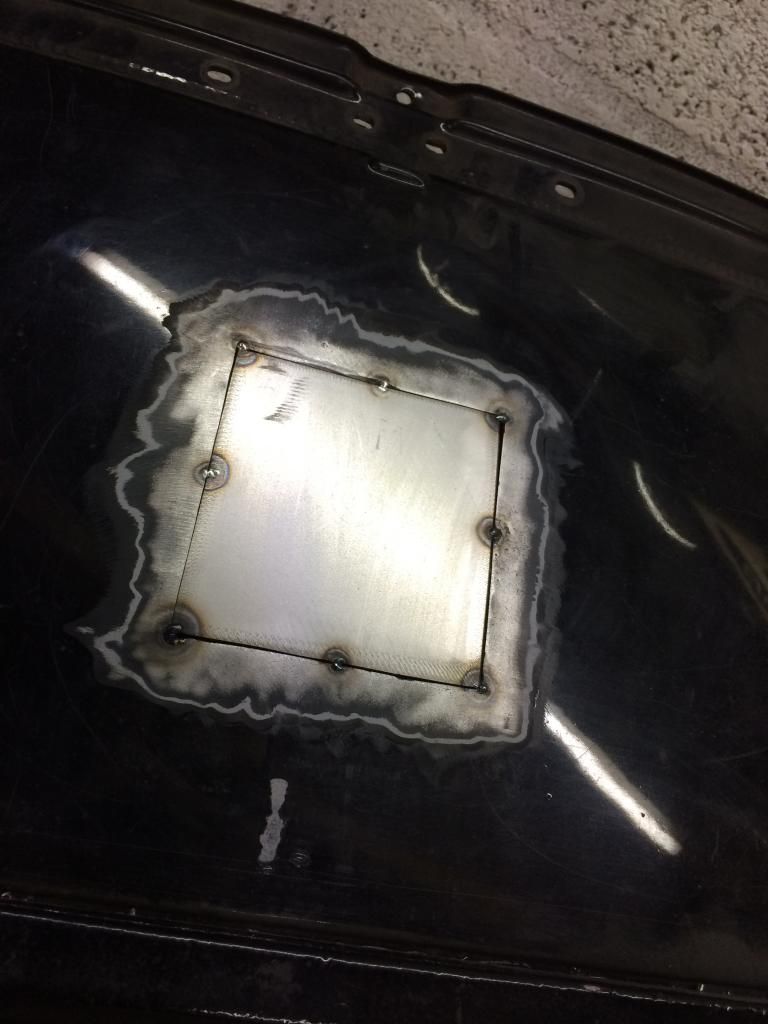

    I then cut a disc of steel the same gauge as the cowl panel and tacked it in, here's where things started going wrong!
    It just wouldn't weld nicely, it either popped and banged or cracked as soon as it started to cool. I finished it as best i could but still wasn't happy with it so i cut it out and did it again. It still ****ed.
    I'm not certain why it wouldn't weld nicely but i put it down to either the inside of the steel being contaminated with lead from ****py old fuel, rust, or maybe some dodgy tank liner or something. Either way, i decided the best thing to do would be cut a 4" square hole big enough to fit my hand in to clean up the back side with sand paper and brake cleaner and it seemed to do the job.
    I ended up with a little bit of warpage from welding the same piece 3 times but it's nothing that i cant m***age out at a later stage. But hey, none of us are perfect!
