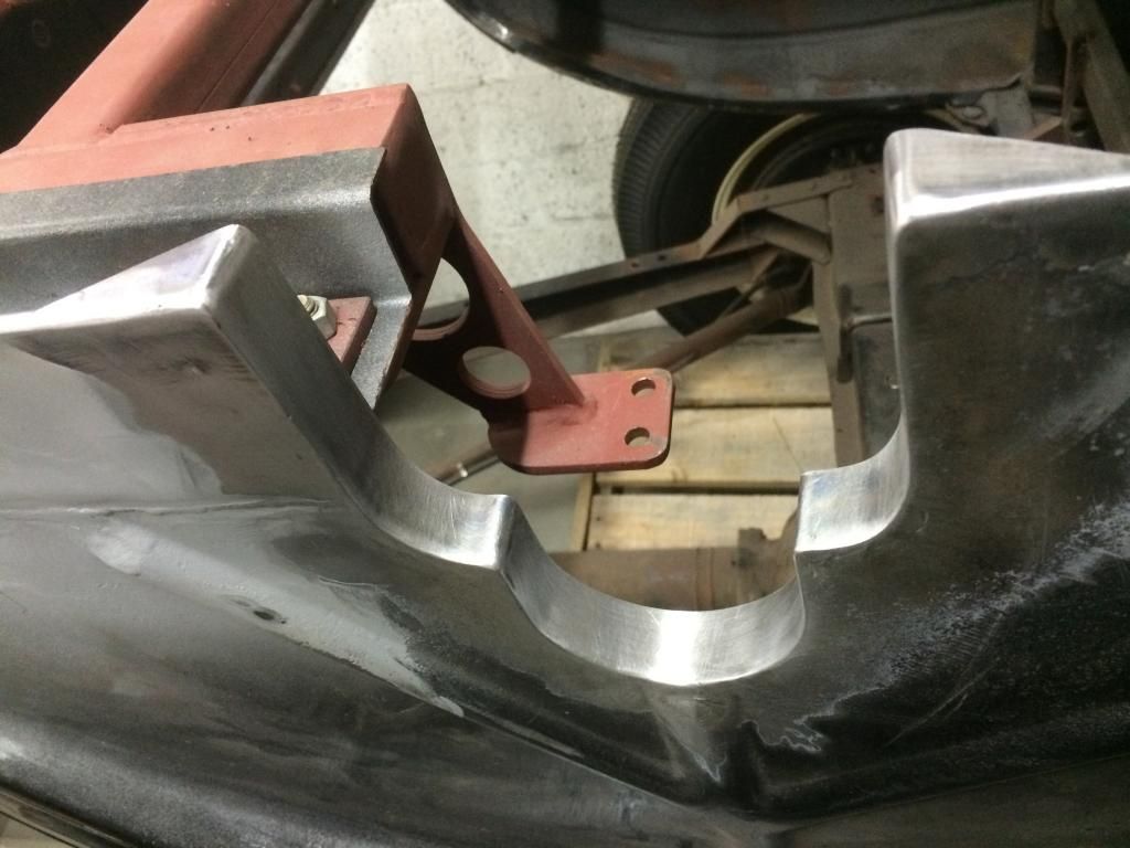

    I pulled the body off the frame (hopefully for the final time) and flipped it upside down with the help of my brother and my mate Steve (thanks) to tidy up a few loose ends underneath.
    first job was to fabricate a 1" return lip on the cutout i made to clear the rear axle and spring.
    It would have looked weird if i'd have left the raised rib that ford pressed into the wheel well like that so i cut a small pie cut in it, and beat it flat with a hammer and dolly to terminate the rib a few inches higher up.
    One side done, one more to go!

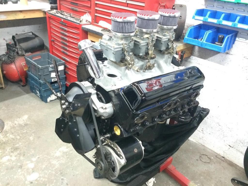

    Great Project, a lot of great work. I'm after an alternator that will look right on my 40, what have you used for yours?

    Who's alternator is that? I like the looks of it!

    Think Neil used a powermaster alternator but took it apart and machined the casing down have to go back a few pages to see it. (Page13)

  20. Its a long GM style powergen that i took apart and shortened.

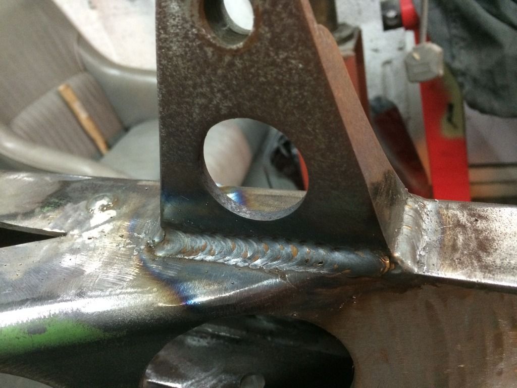

  21. i took my ch***is for a drive to my mate nicks place for him to sand blast so i could finish weld modifications.
    One of the wishbone mounts finish welded
    After i'd welded up all those pieces and god knows how many redundant holes i took it back to nicks for a good thick coat of black epoxy primer. Once i had it back at mine i spent an age flatting the primer back and putting a very light skim of filler on the rails to correct a few slightly low spots.
    I made a make shift paint booth for a few topcoats of black 2K (after priming the filled bits)
    Sneaky peek at the topcoat-
