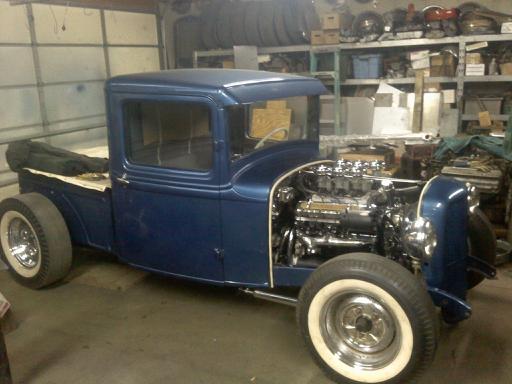

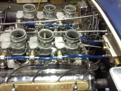

    Been kinda hopping back and forth working on this any my 34 5 window, so yesterday we worked on the truck all day, got alot of putsy stuff done but its coming along nicely. got the steering box mounting reinforcement plate/extra hole cover plate done out of stainless, still have to polish it. got some radiator suport rods installed also, made some exhaust flanges made for the manifolds as no one sells anything that fits or works good. got the other firewall reinforcement peice done along with some dash braces too, worked on mocking up the pullys and generator brackets and mesured up some belts too, got the lower hose figured out, and started work on the upper, we took a couple of the water block offs for the heads and drilled and tapped them to 1/2 npt, then screwed in some 1/2 npt to 3/4 hose fittings, then picked up a offy remote stat housing and stuck a couple more fittings into that, then got a pair of molded 90 degree heater hoses and cut those off to fit, walla a water cross over for an olds. also finished fixing the grille shell up and bead blasted it getting it ready for body work.

    been working alot on both the 34s, got a bunch of stuff done on this one today, got the stainless firewall panel cut out and painted behind it and reinstalled it, got he heads back on the motor, got the dash all fully welded and ground, floors finish welded and seam sealed in etc etc.

    got more stuf done, motor is all together and painted, got the grille and dash bodyworked, primed, based and cleared today too, gonna start bolting it all together tomorrow. also got the floors all painted up yesterday too and painted teh frame up where the xmember was repair, and put the carb back on but havent gotten to many pics of that yet.

    Been super busy and havent had time to post many pics, or even take many pics, we fired it up today and it seems to run pretty good. All the brakes lines are done and brakes are all rebuilt and bled, clutch set up it all done and working, wiring is all done including all the gauges etc etc, got the gas tank done the other day (ill get some pics of that tomorrow) and have it all mounted too, so its getting really close, we are planning on bringing it to Torque fest on friday.

    well we got it on the road, im gonna do an update with pics and a video soon here, got back from torque fest late late saturday night, unfortunately we had to trailor it down to the shop, but we unloaded it at the hotel and drove it form there to the show so we got a few miles on it, we just ran out of time to road worthy it and didnt want to take a chance on hurting anything on the motor. it was the same thing with my hemi powered 34 coupe.

    Question for you. Is that a drivers side manifold on the p***enger side? How does the exhaust work with the oil filter (or starter if it's been relocated)?

    the manifolds are in their stock location as far as i know, it has a oil filter byp*** on it with the starter relocator and it all fits fine.

    must be using the early 303 exhaust manifolds then?

    That's what I was thinking. Too bad that both sides weren't front dump like the drivers side is... That's what I need.
