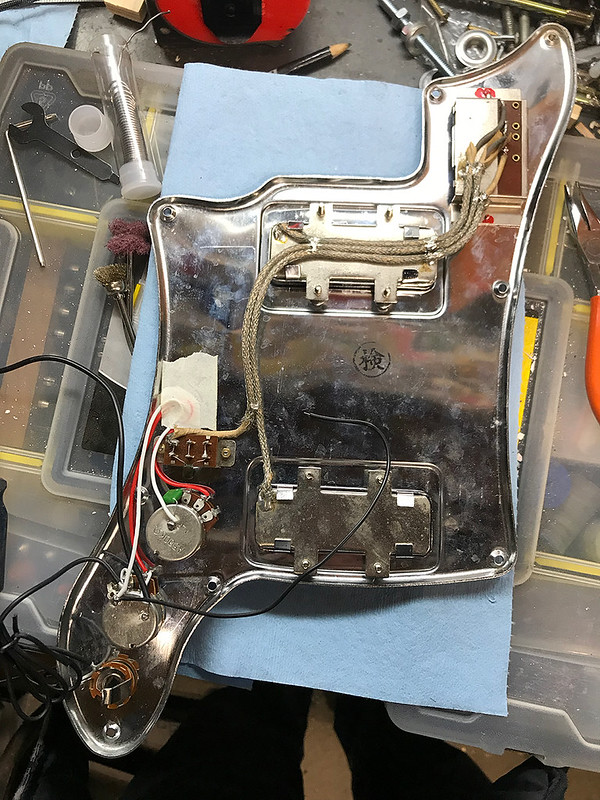

  16. Almost a year and a half later... yes I move slow... digging through a box of old **** (that's all I have are boxes of old ****... most of it really is ****) and I found a Tim Horton's coffee can containing pretty much every missing piece from this old guitar. Seem to be only missing 4 screws. Needs some work (remember I mentioned in the first post on this thread that it got covered in plaster for a photo shoot a long time ago?)...
    Well I cleaned up what I could clean up and replaced the pots and input jack, but I'm not quite ready for the reveal yet :D
    Anyone know what the 2-way switch is for? The 2 paddle switches select the pick-ups, but I can't figure out what the other switch does, and without knowing what it does I don't know how to wire it. Probably obvious to most, but I just ain't that smart. There is a small capacitor or something on it, so something related to tone maybe?
    Can I byp*** it?
    I found a video of a guy playing the same guitar, but even when he flips the switch it doesn't seem to do anything. I don't have a lot of luck embedding video but I'll see if this will work...

  18. I byp***ed the 2-way switch and... nada. So I'm back to thinking I'll just replace the pickups, switches etc.

    It looks like it may be a Teisco or Kawai guitar. Their pickups are usually weird shapes and sizes. There is a guy on eBay selling some of that stuff repop pretty cheap. I'll have to look it up.
