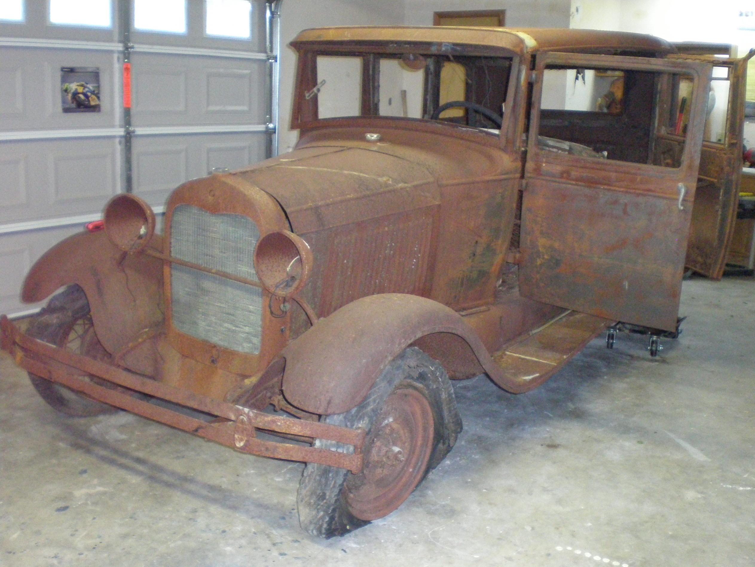

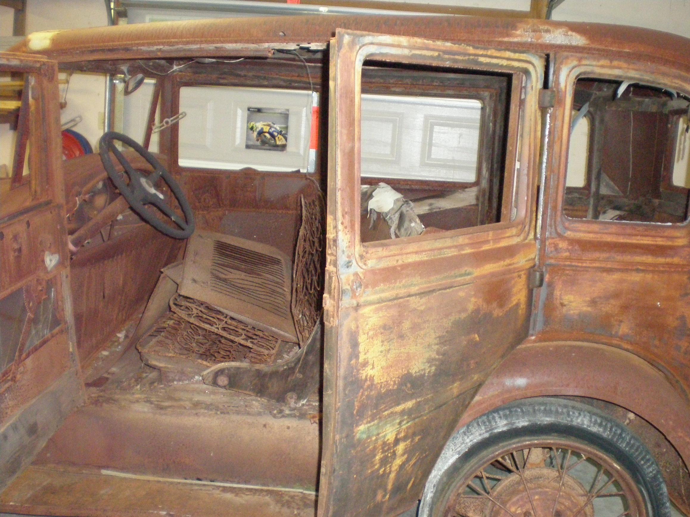

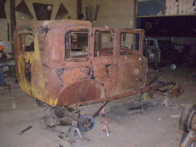

    I bought this 4 door sedan a few weeks ago. The guy I bought it from said it was a '30 but had no paper work or anything. I'm all but certain the grill is a 28/29. Really doesn't matter what year it turns out to be but I'd really like to know for sure. Thanks,
    Jeremy

    Looks like 28-29 from here..
  3. 30 cowl, 28-29 grille

    Do not remeber for sure which one but Briggs or Murray made a 29 with the straight cowl like a 30-31. It looks to be a big bodied car.
  6. The37Kid
    Joined: Apr 30, 2004
    Posts: 32,492
    The37Kid
    1929 Briggs body sedan, the firewall with have a 2-3 inch spacer in it. There is a normal 28-29 gas tank mounted under that cowl. The hood is special to that body and the '29 Cabriolet, has a bead rolled in it, normal 28-29's don't. Good luck with the project.

    Looks like a Briggs 4 door to me..
  8. 325w
    Joined: Feb 18, 2008
    Posts: 6,496
    325w
    Briggs body. If it was a Murry it would have two small holes on the right lower cowl. The Mercury head went there.

    Looks like a 1929 Briggs body. Briggs body cowl looked like the 30 -31's A's(unlike the the Murray bodied cars) . Here is a picture of a 29 Briggs bodied 4 dr sedan.

    Wow! And I just wanted to know the year! Was Briggs another company that made cars for Ford, or just a special style?? There are 2 holes in the side of the cowl on the driver side about half way up, could be from someone that was just bored threw the years tho. Are there any other pics I can show to know what year for sure? I'm not able to read the id tag on the firewall. Thanks for the help!

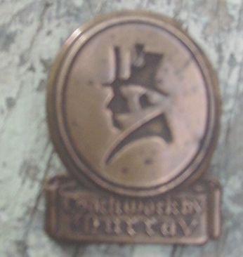

    Earlier I said this was a Briggs body, but Murray made them as well. This is an original Murray body tag I took off one in a junk yard close to 40 years ago, has two holes one over the other to attach it. I'd post the photos and ask for an ID on The Ford Barn to be sure. These bodies have more wood in them than any other body Ford sold, so think things over before you start on it.

    One of the easiest differences to spot between a Briggs and Murray body is that Briggs bodies (yours) door window openings are straight across the top. Murray bodies have a slight arch across the top. They are both well-built and being one of the heavier body styles, they ride great. Maybe not as sporty as a roadster or the like, but a good, solid ride.

    28/29 briggs sedan. straight windshield posts, 28/29 style fire wall-but 3 piece, but the bead line/belt/ across the body is the same as the 30/31 model A. i have one too.

    1929 briggs. I like those cars. I have done a couple of sedans and a cabriolet. Good luck with your project.

    It's a Briggs body for sure. You can tell that by the doors. Briggs are straight above the window and Murry is a little curved. If it has a motor get the number off the driver's side just above the water return port and Google "model A motor numbers".

    It is a 28-29 Briggs look a the front fenders, radiator shell, splash aprons, front bumper, head lights, head light bar all 28-29.
