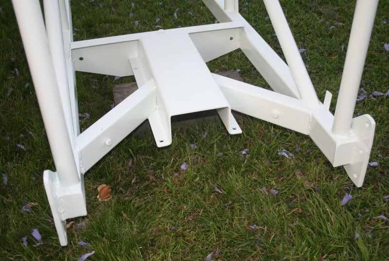

  23. The rear end as crossmember: Is that an original idea?
  24. No, I can think of a few examples that are like this, mine included...
    When combined with a simple but effective trans mount, the whole ch***is is light, and doing the front suspension like you are will be a big saving and effective.
    Keep going, great to see people still having a go with what they have.
    Cheers,
