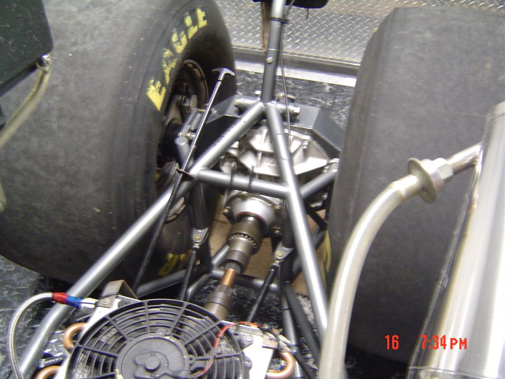

  6. Do I take this to mean that on a rear engine dragster there has to be an appendage from the ch***is to locate the switch further aft than the tires? I don't recall ever noticing such an appendage, but it would have to be that way, cuz typically the tires are the furthest thing back otherwise.
    EDIT::: I went and looked for pictures, found this one. Is this car legal?

    Nope, not legal. Picture the car upside down in the mud at the end of the track, on fire, driver unconscious. How are ya gonna turn off the power? That shutoff rod needs to extend further to the rear so that it is accessible with the car upside down. The law of averages dictate that the car will not always be shiny side up.

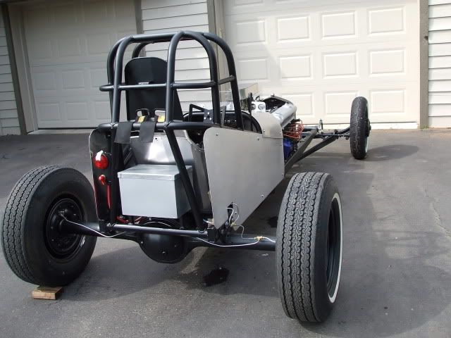

    It's up on all four wheels. I got the '35 Ford spokes from a Wed. lunch buddy. The bike tires were free "take offs" from a cycle shop. I mounted them the old fashioned way, with tire irons.

    I sanded the aluminum body panels with a DA and 120 paper. It gives a matte finish that hides the scratches and gouges that were too deep to polish out.

    I took the rear rims off a '67 T-Bird in my favorite local junkyard. My neighbor bought a '64 Chevy pick up and didn't want the G78 bias tires, which are practically unused, so he gave them to me. Love the free stuff!

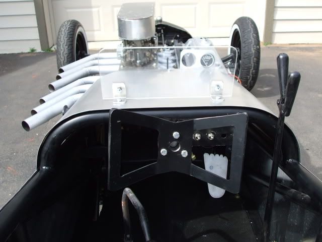

    The driver's view. You can see the wind deflector, ****erfly steering wheel, the hand brake lever to the right and the "mini Moon" gas pedal. It needs trans fluid and coolant, then it is ready for some "driveway drags". Now, all I need is $700 worth of safety items.
    Now for some editorial comment: I've been reading with great interest all the discussion regarding rules, confusion, car count etc. Since I am just finishing a car all this is fresh in my mind.
    First, I don't have a shop, I have a garage with a minimum of tools and equipment. If I could not have borrowed a tubing bender, I would have ordered a prefab cage from Chris Alston Ch***isworks for under $400. I borrowed a tubing notcher and used it in my drill press. Everything else was simple metalwork, cleaning, ***embly and welding which almost everyone on this site can do.
    In the planning stages, I looked at every picture of every HA/GR on this site. I read the rules and pored over a NHRA rulebook deciding what would be required to run at local strict dragstrips. A number of PM's were sent to guys with completed cars and I recieved lots of valuable information from them (A BIG thankyou to all of you). I used to be of average intelligence, but I'm old and losing brain cells rapidly. Even so, I had no difficulty figuring out or understanding the requirements and restrictions imposed by the HA/GR rules. It was a little more difficult to decipher the NHRA rulebook. Once I decided to treat my car as a 10:00 second or slower Altered ch***is, then the NHRA rules became clear.
    Regarding car count and the racing experience: I doubt there will ever be a flock of HA/GR's in my area. I never expected there would be. If I would have built a flathead powered Fiat Altered, I would not expect to run in a field of 8 of them each week either. I intend to go to local nostalgia drag meets and run in the cl***/bracket they put me in. Win or lose; I don't much care as long as I get the best performance out of my car. If so inclined, I'll make the trip to the Mecca of HA/GR racing, the HAMB Drags at MoKan. Regardless, I had a terrific time building the car and will have a ball running it. What more do you fence sitters want out of the deal?
