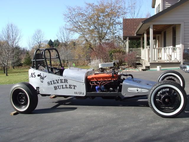

    I got the body panels back with the additional lettering and art work. With the radiator laid down and the "shovel nose" aluminum on the front, it looks a little more "racy".

    Kathy Weeks, my "go to" sign painter and wife of one of the Wed. lunch boys, hand painted the silver bullets on the sides of the nose and the .45 numerals on the nose and side panels.

    The car now has a number---.45 (caliber). I hope the dragstrips will recognize it and not have to write all over the car with thier white shoe polish.
    You'll notice I took the liberty of changing to HA/GRa, for automatic. Always wanted to be the first at something, even if it isn't acceptable. I'd like to promote the building of HA/GR & HA/GRa's in my area so I hope this designation doesn't trouble anyone.
    I put the car away for the winter today. If the money is there, (meaning, I'll have to sell a car or two) I'll build a decent engine this winter and get a good converter. Also, I picked up a '40 Plymouth pickup yesterday with the plan that it will be a tow vehicle.
