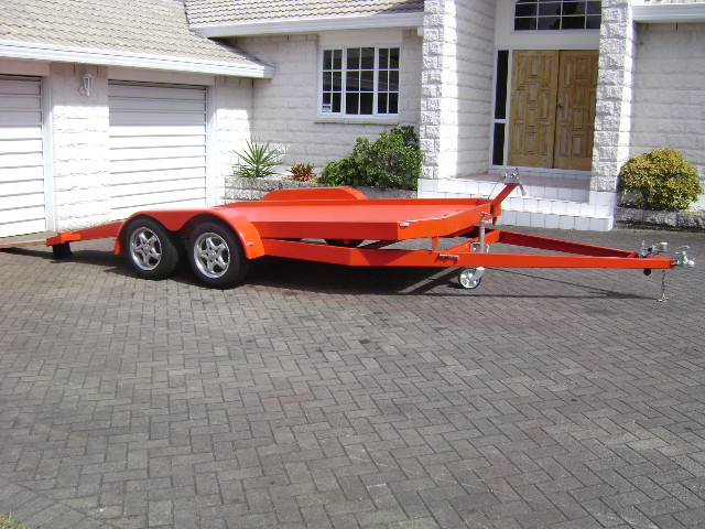

    Hi Bob, I really enjoyed your write-up [ it has inspired me to build one ]
    I also am very interested in learning how to make "Teardrop Fenders" , Because I live in a "little 'broken ***ed' rock in the South Pacific" the shipping costs get prohibitive.
    Does anybody know how to Roll Tandem Fenders?? [ eg: as a manufacturing process, not a guy hand hammering them out ]
    A few friends [5] want me to help build them race car trailer each, so we might need to group together and help each other [all at once ]
    I've built a few nice trailer over the years [ NZ towing laws are different to the USA laws, eg 2500kg GVW and 2.5m max width ]

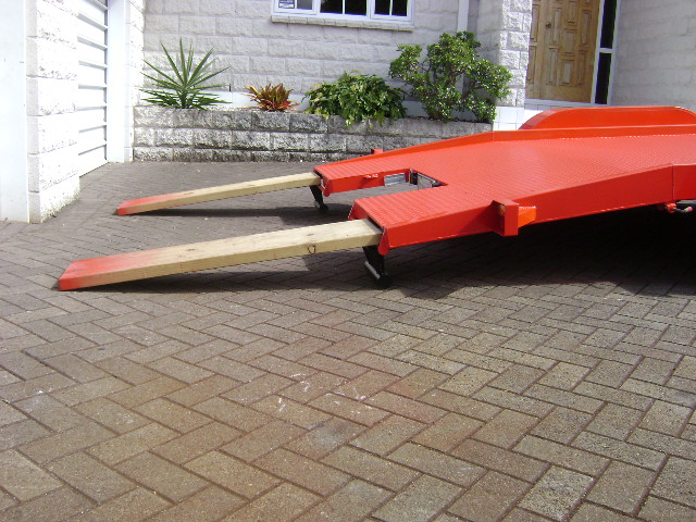

    We make our trailers Tilt decks, This makes it easier to balance the payload, the xtra weight needed on the hitch comes from the trailer tongue which weighs approx 70kgs [150 lbs ]
    A tilt trailer makes the lowest of cars very easy to drive on.
    Teardrop Fenders really improve the appearance of the trailer
