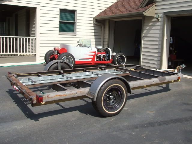

    Here's the tilt trailer I built for my Crosley drag car. It works very well. However, I built it to fit the Crosley with little room to spare. As you can see, the dragster has to go on backwards and there is only an inch of clearance on each side. Try getting that lined up alone!
    The new trailer will permit me to drive straight on and off easily. My ramps are made from GripStrut and are 8 feet long, but still quite light weight. Since I tend to do everything alone, hence the Lone Ranger Racing Team name, having loading and unloading as simple and easy as possible will make racing more fun.

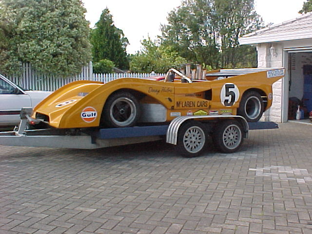

    Here's a few pics of a trailer that I built in 2003,
    It had no ch***is rails, but folded 1/8 sheet steel runners and drawbar tongue instead [ it had 4 x crossmembers of 3 x 2 x 1/8" ]
    The deck was only 12ft long [ the length of available 1/8" sheet steel size ] It had tilt deck, winch , surge brakes and towed like a dream
    Total weight was only 400kg [ 880lbs ] I've never seen an alloy trailer that light.I could load a 1600kg [3520lb] car on it,and tip the scales at 2000kg's .
    It was very strong which proves the shape of steel is more important than the thickness of steel.

    Took the trailer for a test pull today. Tomorrow it goes to Jerry the Sandblaster for a little more cleanup and a coat of epoxy primer.

    The 8 foot long ramps are made from gripstrut decking that I reinforced. They store up the middle of the trailer in some formed angle iron slides. I have plywood decking 1-1/4" thick that is stained and varnished. It'll get different tires and wheels.

    Got the trailer back from Jerry the Sandblaster. He put a coat of epoxy pirmer on it. I painted it with Rustoleum Hammered Finish Silver. The file cabinet paint. The deck is 3/4" and 1/2" plywood layered, oil primed and painted on the bottom, stained and urethane coated on the top. Lots of carriage bolts.

    It is sized so the dragster just fits. The objective is to keep the total weight of dragster and trailer under 3,000 lbs. Much easier to license, and pull with my S-10 and later, the '40 Plymouth pickup. I wanted to use vintage lights but decided to use DOT approved trailer lights all around to keep the Law happy.
