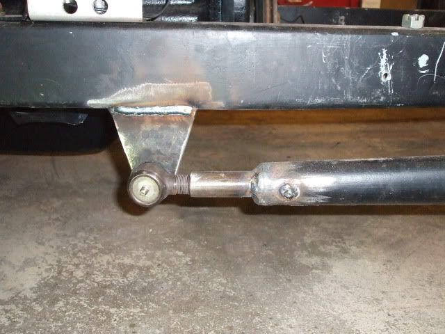

    Got the new crossmember and spring perch in today. When properly aligned, the tie rod does not rub on the crossmember! It sits 3" lower in front and definitely looks more racey.

    The frame brackets are a quarter inch thick. I welded quarter inch thick round pieces to the back so the taper for the tie rod would be a half inch.

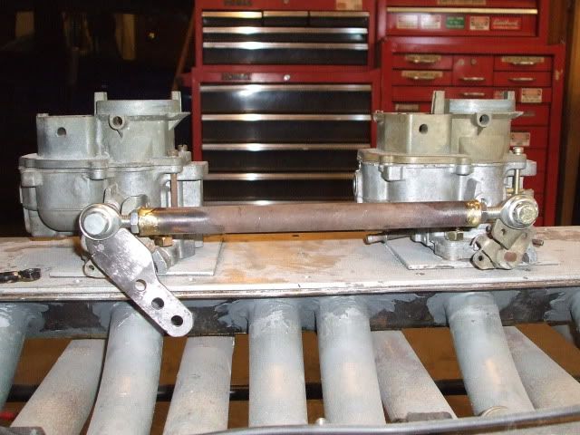

    Started on the carb linkage. I stuck 5/16" NF nuts in the thin wall tubing and brazed them. Made the bellcrank which attaches with the same bolt used for the other linkage. There is a pin to keep it from slipping.

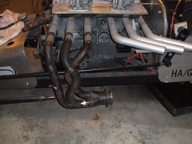

    Considering marrying a set of sbc headers with the slantie pipes. The first and third pipes match up nicely. Wish I had two left side sbc headers...
    Primaries would be about 42" long. Any opinions on that?

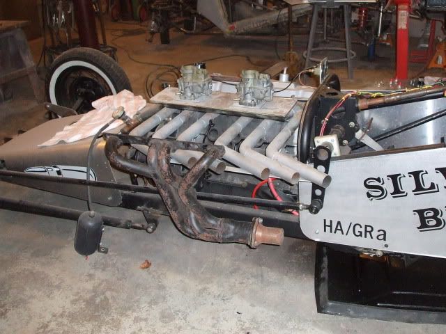

    Even though I went through a full box of Kleenex and had snot dripping in my welding helmet, I managed to cut up a perfectly good set of sbc headers. Got the header for the front three cylinders tacked together.
    Still need to figure out collector diameter and length. Thinking 2 1/2" by 20". Advice gratefully accepted.
    The header for the back three cylinders will turn back at a higher elevation to allow room for the front collector.
    Primaries are 39" long. I used a header calculator from the Google and it suggested 50"!

    BOB when we built the headers for our slant 6 we ended up with 39inch primaries also ,we put 2 1/2 collector 24 inch long painted it black then ran the car, we cut the collector off where the paint quit burning off it ended up 18 inchs it seemed like the engine ran cleaner will play around with it some more this comeing year so give it shot a stick of exhaust pipe is not that much

    Go a collector length of 18 to 20 inches and it should really come on strong from 2500 rpm. On the dyno zoomies only make as much or more power above 6500 rpm.

    Actually if you have pipe to spare put long collectors on it and use cheap spray paint on them and cut off where the paint stops burning off. That was the way we did it in the old days.

    Thanks for reminding me about determining collector length. Felt terrible today (many rush trips into the house) but managed to cut up the right side sbc header. It took more cuts/pieces to make the pipes for the back 3 cylinders. The silver collector is from headers I built for my Anglia many years ago. Tomorrow I'll finish the welding, put the other Anglia collector on and do the blacksmith work to convert the collectors from 4 into 1 to 3 into 1.

    The header is done and I didn't buy anything. I can easily try diffferent collector lengths by bolting to the flanges.
