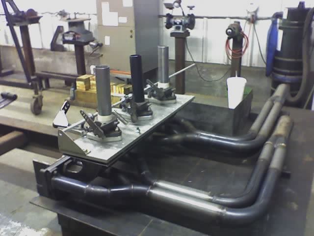

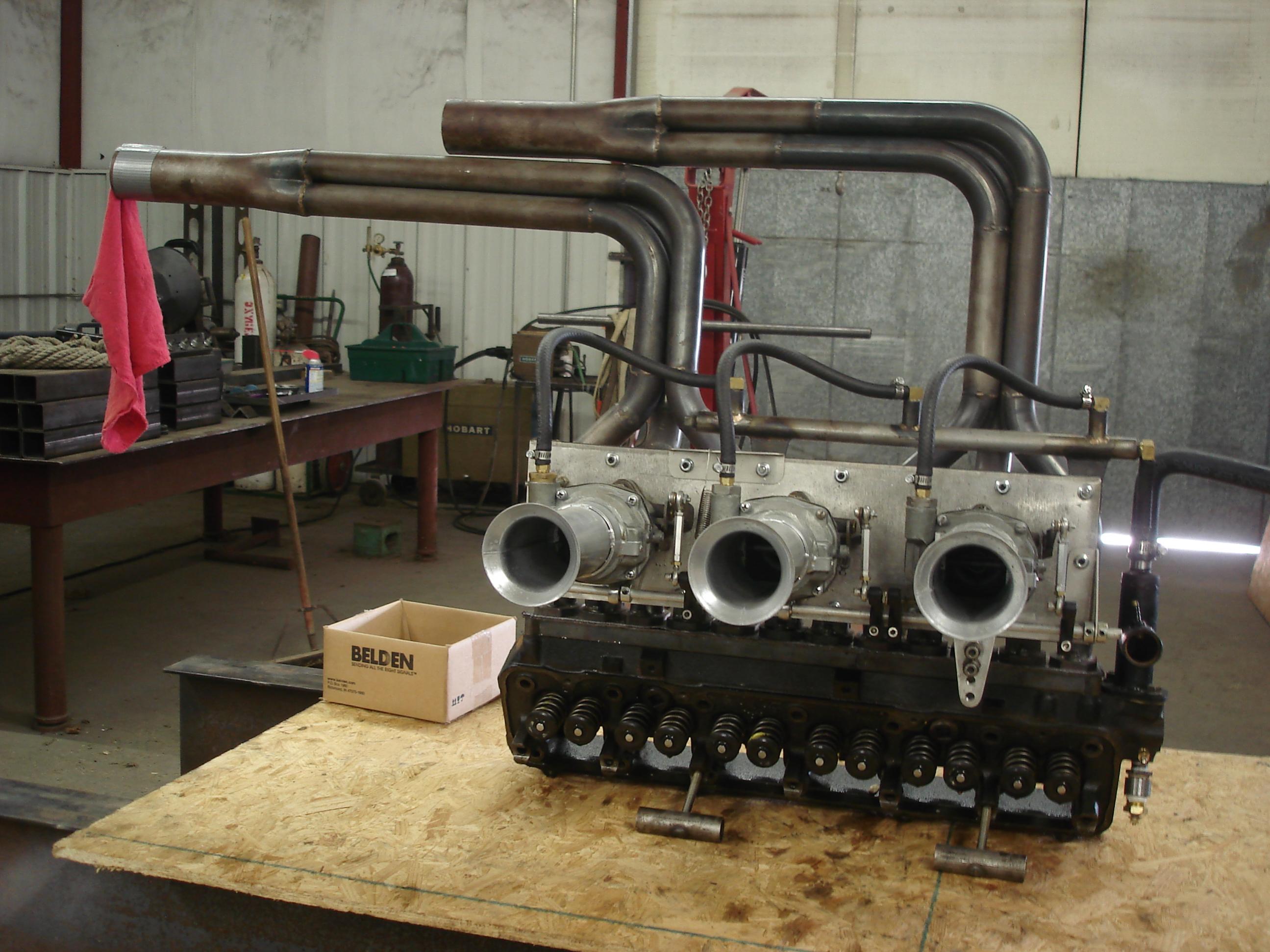

    Here is a pic of the headers the Senile Old Men built for thier Slant 6.

    Yes, those senile old men do nice work. This senile old man working alone can't compete. Hope to see that car in person some day.

    Hey Bob, had the pleasure of meeting those guys in person last August, there car is a true work of art, everywhere you look there is true talent showing through. I guess that comes from their shared lifetime of expeience. Nigel.

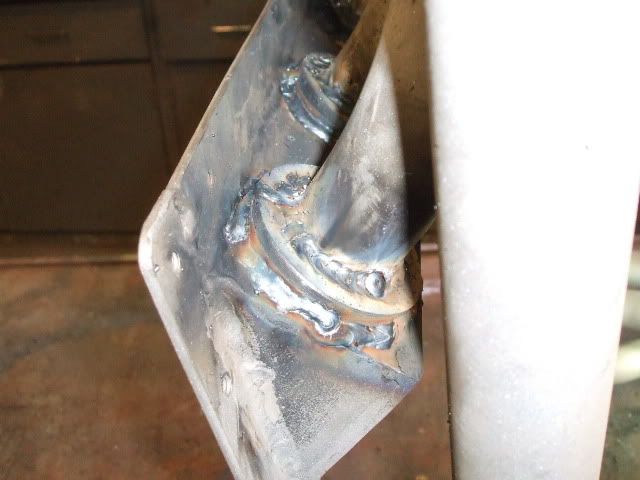

    I cut those 3/8" thick rings, shown above, in half and welded them to the intake runners at the plenum wall.

    Doing that provided enough "meat" so I can radius the inlet from the plenum to the runner. Should give the air/fuel mixture a smoother path to the engine. Experts, is that enough radius on the left port?

    Now we see what those rings were cut for. Nice idea and the radius looks real clean. Not being a builder;) I would have no idea if the radius is correct, but it would be fine if I was doing it.
