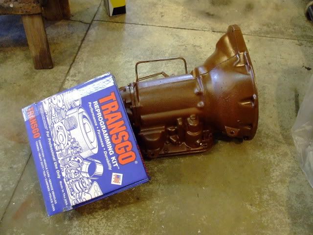

    For two days now I've had this TransGo manual shift kit setting by the trans. It still hasn't installed itself. The instructions state only an experienced trans technician should install it. Well, I'll be experienced by the time I'm done. Sure hope it works...
  6. Have you checked on a full manual Cheetah valve body?

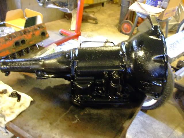

    Putting the manual shift kit in wasn't all that difficult. Lots of steps though. Had to take one part to a machinist friend to have a couple diameters ground smaller. Sure hope it works.
    The converter is a bit late so I'm gonna shift to rebuilding a couple Carter BBD 2 barrels while I wait.
    The pic isn't very interesting but progress is being made.

    Looks much better than the original "PC" earth tone trans you started with, I'll bet it works just fine too.
    What part needed to be ground?
    I would think Transgo would supply the part, not everyone has a friend in machining but it sure does help.
    Good luck, let us know how it works for you,

    P-Dog, the instructions call for grinding a smaller diameter on one land and reducing the land width. This is on one of the shuttle valves. The instructions didn't say it but I think hand grinding would have been acceptable. Since I have a machinist friend a little extra precision couldn't hurt.
