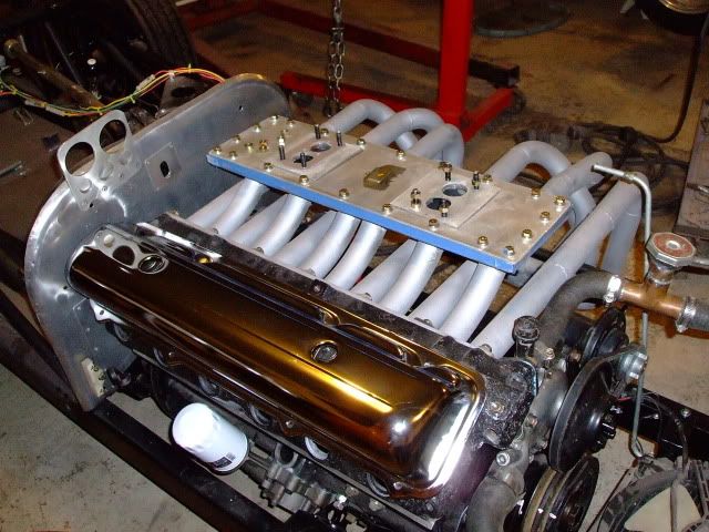

    Summit had chrome valve covers for sale with free shipping, so I added a little bling. The intake manifold is all sealed up and ready to go. Still wrestling with jetting and metering rods. Kinda fun to ****yze these problems on paper and will be able to test the theories at the strip a bit later.

    Bob, a little chrome looks nice. I see what you ment about tight when it came to the oil filter.;) Mine is the same way with the 194 motor located in the ch***is, when you screw it off I have 1/8" to clear the threaded ******.
    The way you have that top plate made you can build any combination you want, 3-1bl/3-2bl/1-4bl/ 2-4bl. Looks like it would fit a 300" Ford, but that is for later.:D
