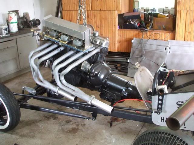

    Cold and rainy again. We were lucky Saturday and had a great first Billetproof Show.
    Here's a short video (click on the picture) of how it idles, cold, with no chokes. The stumble I mentioned is hard to hear on the video and might go away when the engine is warm.
    Update: I made a couple 100 foot runs up the driveway. Way better than with the 2 2 barrel carbs. Still much to learn, but the rains are back.

    Bad news. After two aborted p***es at the drag strip last fall and 10 short shots up the driveway, I have become sure the car only has first gear. It has first gear in second and 3rd also. I probably messed something up when I put the shift kit in the valve body. Today I pulled the valve body and found a fair amount of friction material in the trans pan. Fluid smells burned too.
    I have a spare stock trans and am thinking of putting that in so I can get some seat time in the thing at the strip.
    Racer Roy, Looking doubtful for a trip to the Meltdown Drags. Bills piling up and no one to watch the dogs. And now mechanical difficulties. I'd like to have a good running race car before taking it 400 miles away from home.

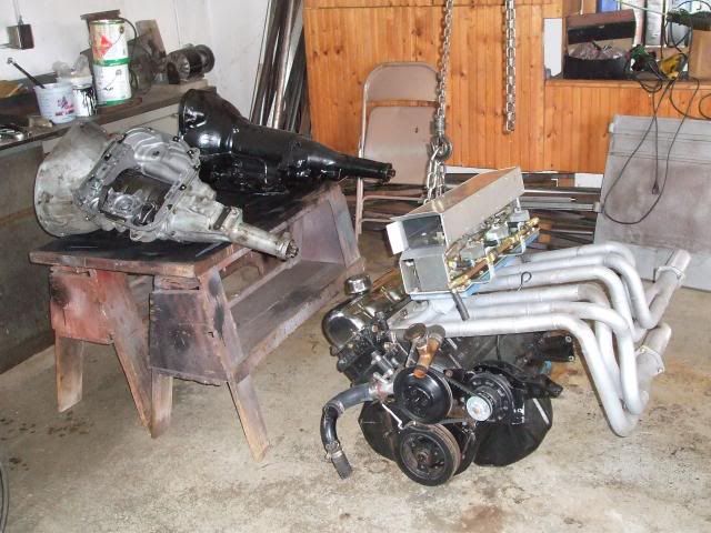

    Got the car torn apart today. Cleaned up a good (***umed) used trans and put a restrictor in the 1-2 gallery. Everything else will be stock in the trans for now. Should be back draggin' in the driveway early next week. I just want to get down the strip consistently. If all goes well, a better trans and a high stall converter will go in this winter.
    I have been getting great advice from Don Dolmetch who has a slant six Senior Dragster and posts on the main board.

    I was putting the converter on the new/used trans (the silver one) and smelled the burnt fluid again. So I have been ****ing the fluid out. I'll throw a quart of new ATF in the converter, swish it around and **** that out too. Then, put it all back together and hope for the best.

    Oh stupid me. I didn't realize the first transmission was a lock up version. So was the converter I had loosened up. Well that converter wouldn't fit the older trans I put in the car so I now have a stock, used converter. Big step backward; old trans and old converter. I did run it on jack stands tonight and it shifts through first and second. I'll back off on the throttle valve setting and try it in the driveway tomorrow. Pretty hopeful it will have all the gears. Fortunately, it idles fine with the stock converter.
    Got an oil leak and an ATF leak to fix. then I might finally get it out to Test and Tune.
