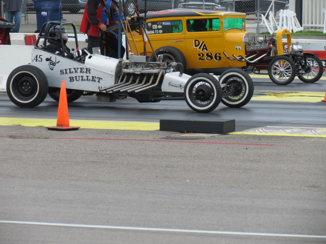

    The Minnesota Street Rod Assn. rented Brainerd international Raceway for a weekend of free drag racing for members, of which I am one. I managed two runs before I had to leave for a family event. First run was poor as the car bogged slightly off the line then spun the tires. I cruised down the strip and got ready to try again.
    The run pictured here went better. Car left the line with no muss or fuss. It felt a little lazy however. I kept waiting for the rpm's to reach my shift point. Someting was wrong. Yes folks, I made a high gear only run. Just like the big boys.
    Out of the seven runs I've put on the car in it's two outings, this run was the best at a 13.08 @106. Never had the pedal on the floor either. I seem to have a mental block about that.
    The flathead powered A sedan in the other lane has been around for many years. My car was a second and a half quicker and I had a .141 reaction time versus a sleepy .502 in the other lane.
    Maybe at Test & Tune in a couple weeks I'll get my driving act together. The car wants to go quite a bit quicker.
  23. Old28
    Joined: Jan 11, 2009
    Posts: 1,390
    Old28
    Hay Bob, I have always said that a "Day In The Seat Is Better Than A Day In The Shop".
    Glad you got to make a few passes and start getting the bugs out of the new setup. I'm sure that you were hopeing for more (all racers are), but now you have base line to build from. Full out, peddle to the floor, I know you can run mid to high 11's and have a ton of fun. Keep working at it, your headed in the right direction.
    Got to love that Altered Sedan, What a great weekend.
