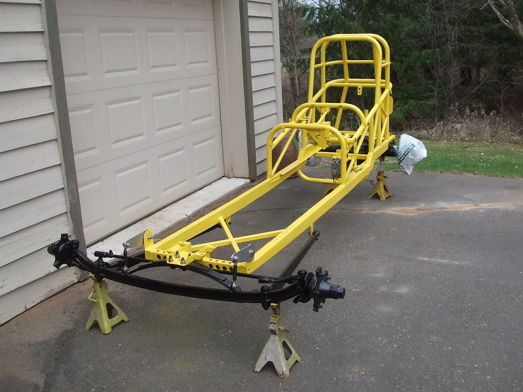

    digger ressy 001.JPG Yeah RacerRoy3, looking for 10.99 but probably will never see it. The snow is almost all gone so a friend came over and helped be dig the frame out of the back garage. I spray bombed some thin spots in the paint. Yellow doesn't cover very well. I managed to put the narrowed rear end with Dutchman axles in even though my hips are not working. I get injections in a week and a half. Maybe then I'll have less pain. Tomorrow the front axle. It should be ready to run in a couple weeks. I'll get the friend who helped me today to drive the thing until I heal.

    Looking good. It's too late now but when spraying yellows or orange, use white primer or a light coat of white first. The paints these days are more opaque due to not using yellow or red ochre as they contain lead. Mind you, that could've been the paint bloke spinning me a yarn but it makes sense to me.

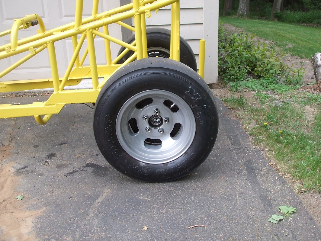

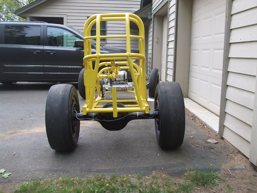

    I filled the rear end and bled the brakes. It's a roller now. Still waiting for the converter. At a standstill til I get it. Here's look at it with the narrow rear end and the Ansen Sprints.

    Yeah Bob, it's definitely narrowed but it sure looks good. It can't but help the handling too!

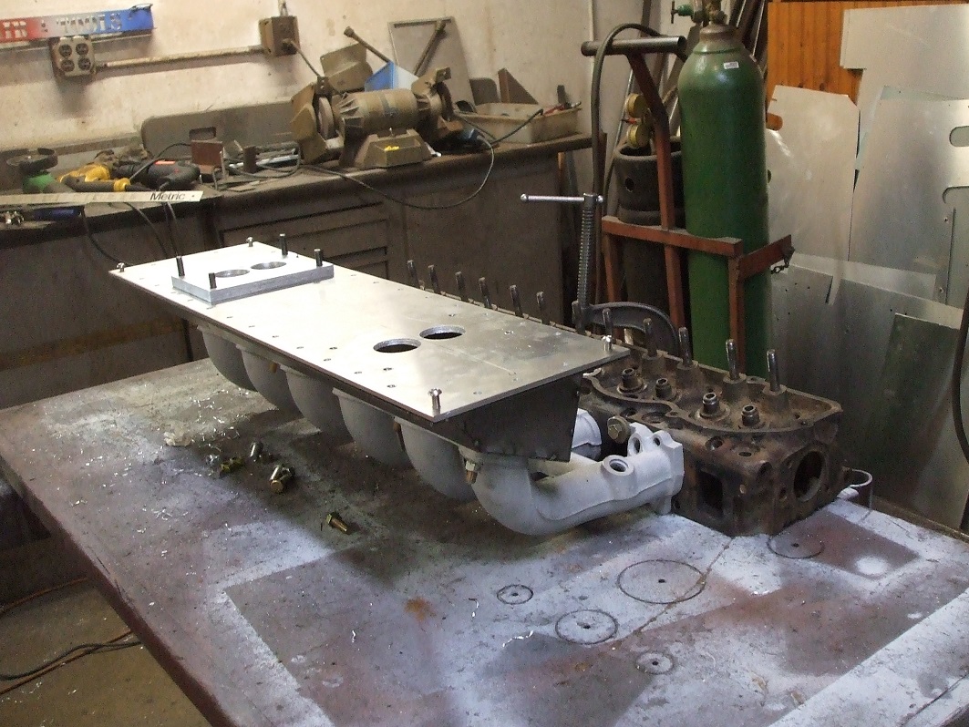

    I put 3" wheel studs on the axles to p*** tech. Received this EFI lower manifold from old28 in California. Thank you, Tom. Started building a plenum on it to mount two Autolite two barrels.

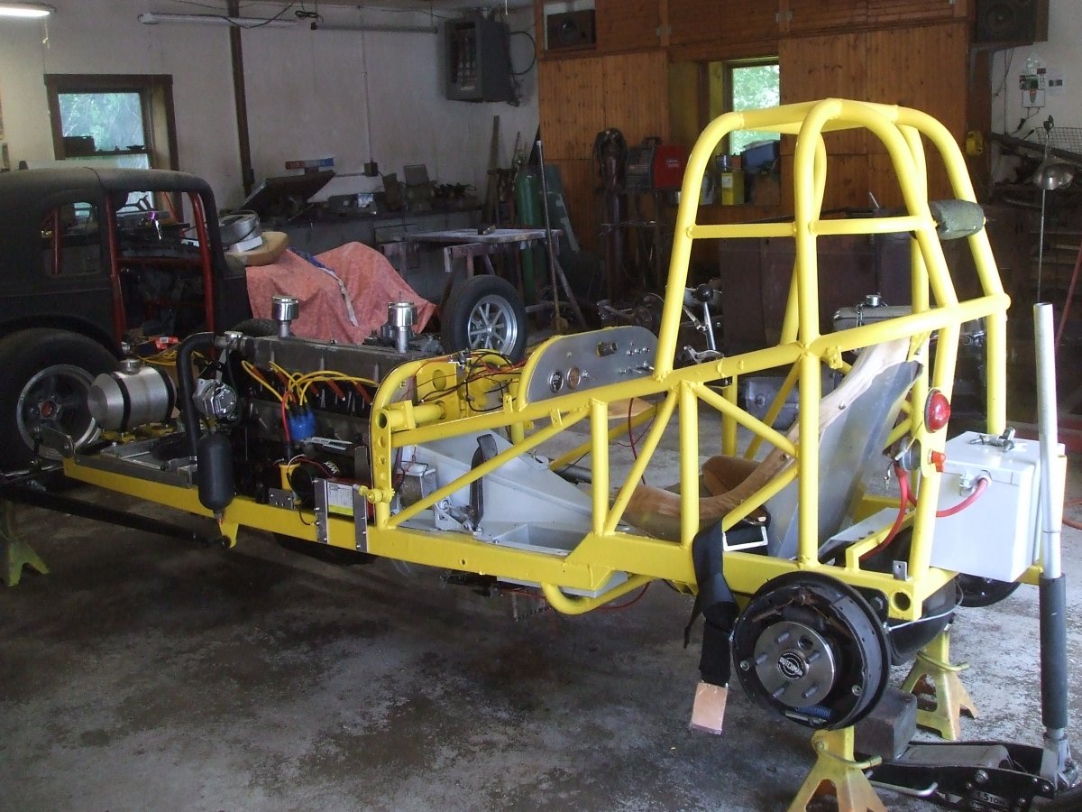

    It's all together and it runs. Just need to top off the Powerglide then the cowl top can be put on it.

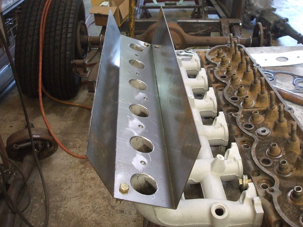

    On the dual intake I'm building I made a couple carb spacers out of walnut an welded a slantie strip in the plenum to eliminate the low trough where raw gas could pool.

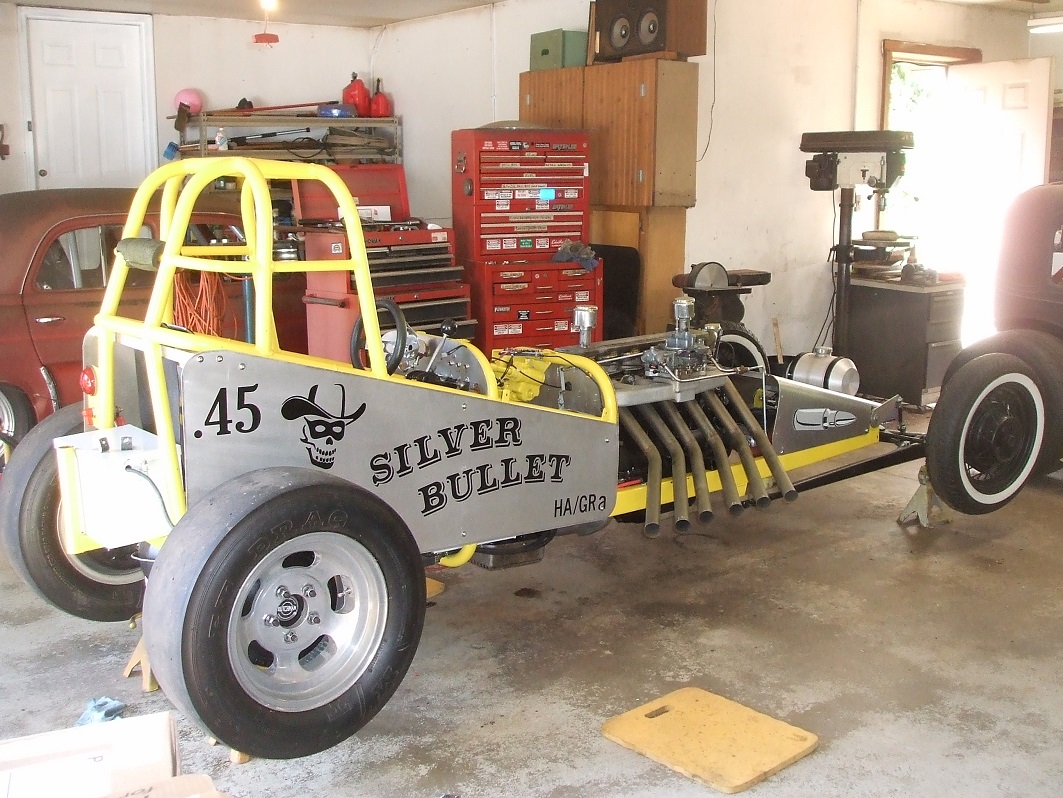

    The car made it to the Meltdown Drags but I didn't. Feeling rotten and the forecast of rain kept me from going. Dave & Tom had he car tec'd Thursday. Friday, after siting in staging for a few hours Dave made it to the water box where he was shut down because of a leak. The floor mounted master cylinder cover came off and fluid was dripping. Saturday was 1/8 mile only because water was coming up through the track farther down. Dave lined up and built some RPM against the brake. It pushed through the beam and he red lit. Waited several tenths and then took off. Lousy e.t. but 95 mph, which is quite good.
