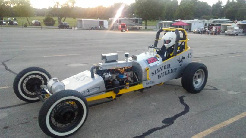

    The annual Super Secret Fun Run is this weekend. Sponsored by the Minnesota Street Rod Assn, all members race free at Brainerd International Raceway. Driver Dave took the car up Friday for tech and I went up Sat. morning. We had high hopes since the weather was cool and dry and the car ran 11.38 in the humid heat in Illinois in July. Best we could do Saturday was 11.63. Still, it was lotsa fun. Here's Dave lining up for the third run of the day.

    Looks fast standing still. What size are the rear rims Bob?

    Thank you, spanners. The wheels are 15 by 8 with 26 by 8.5 by 15 M/T worn out slicks . There is no wheelspin off the line. The tracks are prepped though. Got wheelspin in the driveway.
    Update: Dave ran a 11.45 Sunday morning before packing it in and heading for home.

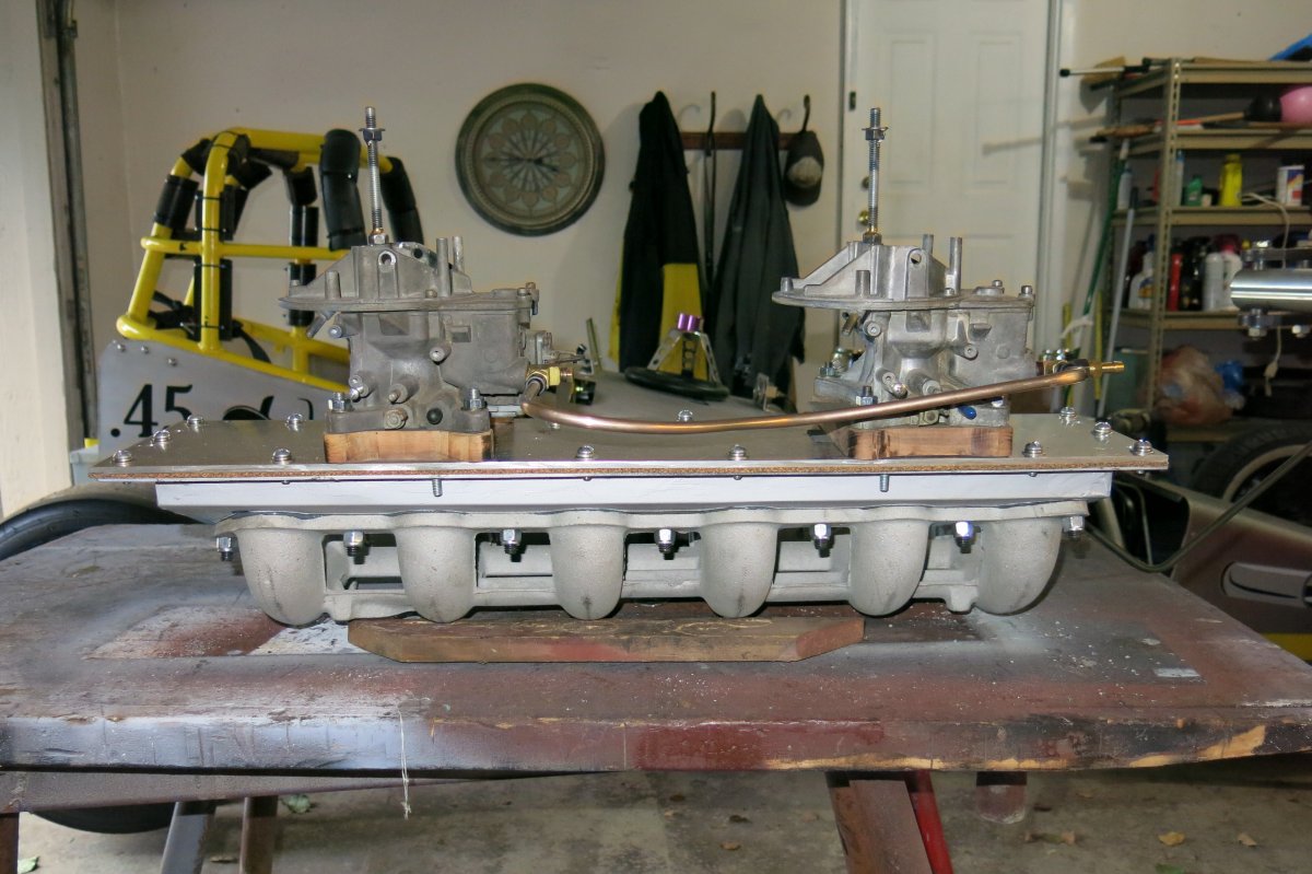

    The 2 carb set up is ready to go back on the dragster. With the smaller plenum the carbs (autolite 2100, 1.08 venturi intake 001.JPG ) should get a good signal. We race in 2 weeks at the Fall Out in Eau Claire, Wi. Got to make some driveway test shots to assure there's no problems.

    intake on 001.JPG Driver Dave and my pitiful pit crew which consists of Jerry (nugget32) and me put the two carb set up on the dragster today. After a couple hours of story telling we got down to work. A little trimming on the top plate for firewall clearance and tightening some leaky fuel line fittings and we were ready to start it. It fired right off and to me it sounded more powerful than with the 4 barrel. The off idle stumble was gone too.
    It was just about a year ago when I first tried this set up and it would hardly run. I cut a lot of volume out of the plenum and seems to be the big difference.
    It's been raining for three days so no driveway hits were possible. We'll be running it at the Fall Out Drags next weekend.

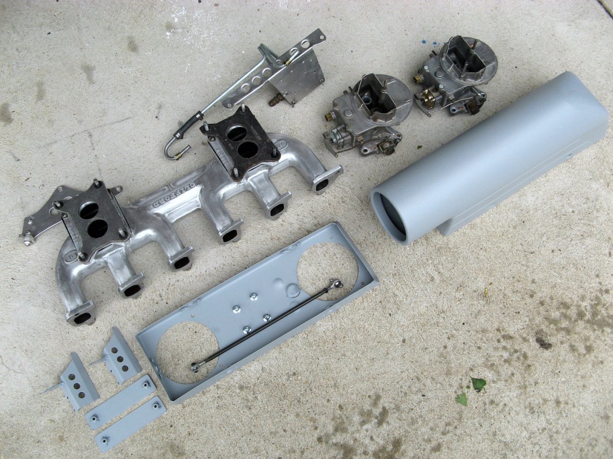

    The idea of the third carb made sense. I finished a new top plate for the intake and rough cut a walnut riser. I don't have a decent third carb so the hunt is on.

    Hi Bob, We're running similar carbs on The Family Truckster. Before you try three carbs I would block off the power valves and go up a few main jet sizes. We just switched from 1.02s to 1.21s last weekend and it picked up a little - maybe a tenth. Clifford 2 x 2 03.jpg

    Is there a secret formula for plenum size or is it a case of 'suck it and see' (pardon the pun)? I'd like to try something like that but my engine has only 3 intake runners and the driver has limited knowledge.

    spanners, I have a book on building Chevy 6's by Leo Santucci. In it he shows a design for a plenum based intake for racing. For a 292 he states the plenum volume should be 126 cu. in. For a 250 the volume is reduced 17%. You can extrapolate from this the plenum volume for your engine displacement.
    He also recommends 7.5" from the carb base to the cylinder head flange (runner length).
    I went to a Ford only salvage yard today and got the third carb. Spent a couple hours cleaning it.
