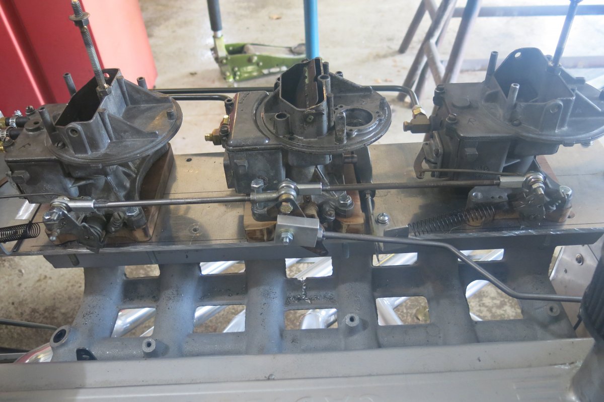

    karbs 001.JPG karbs 003.JPG You're welcome spanners. I went to a Ford only salvage yard and found the last 1.08 venturi carb he had. Finished the fuel lines and throttle linkage. Have to rebuild the middle carb and modify the scoop
    I should have taken FTF's advice and played with the two carb set up. But, there's fabricating involved in changing to 3 two's. I couldn't resist.

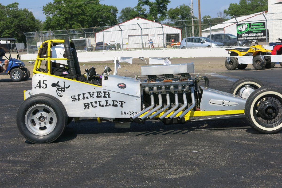

    A long time since I posted here. With the Covid fiasco racing was somewhat unusual. We skipped Glory Days Drags in Byron, Illinois. 60 of us rented the local track in July and had a good time. Then in August the Minnesota Street Rod ***n. held a free nostalgia race weekend at Brainerd, MN. for members. In Sept. it was the Fall Out #5 Drags at Rock Falls, WI. That was it for the year. Actually, we ran quite a bit as local strips were not shuttered.
    Since I installed the high stall converter e.t.'s improved to the 11.30's-11'40's and lost miles per hour from 118 to 112. All in all we put a couple dozen runs on the car all in the range shown above. I was hoping for better but it was pretty good. No plans this winter to make improvements. Following are some Fall Out 2020 005.JPG ssfr 20 031.JPG e pics.

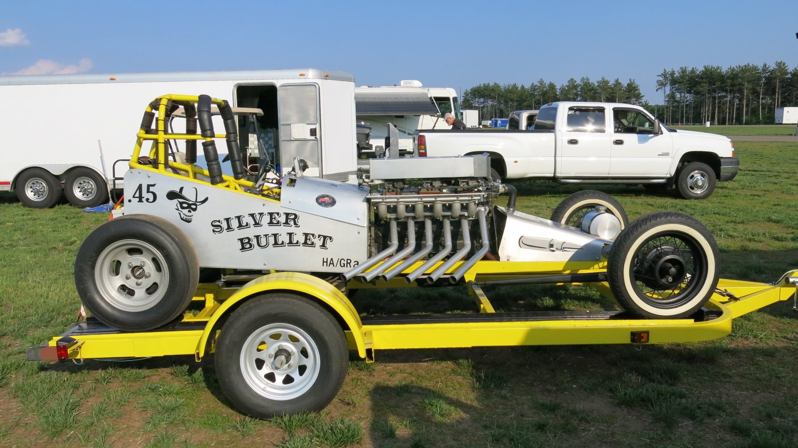

    Long time away from the site. But that doesn't mean we've been idle. Managed three meets last summer. Had a best of 11.28 @115. I did build a trailer that fits the image of the car. TnT 022.JPG

    Nice little setup you have. I sometimes wish I still had my single axle open trailer for the HAMBster. Tow it at any speed and behind any vehicle and you didn't know it was there. I only went to a dual axle enclosed trailer so we had racetrack accomodation and therefore save money.

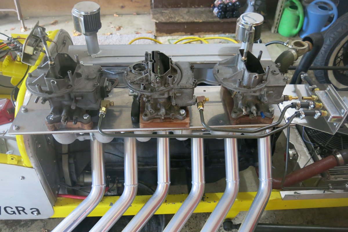

    Are those Autolite carbs? What size are they?
    How did they work? OK even with a cold engine?

    Thanks for responding to my post. I've had trouble logging on and gave up for a while. My computer ignorance was the problem. Yes, the single axle, unsprung trailer pulls so easy I sometimes look in the rear view mirror and am startled to see the dragster there. Eleven flat is the goal. I now have doubts that the extra long intake will help. Headers with some science built in would, but probably not almost .30 worth. Yes they are Autolite/Motorcraft carbs with 1.08" venturi. They don't idle very good but that is probably my tuning. They work fine under full throttle with the loose converter. Leaving the line at around 3,500 rpm. And yes, FTF, use the pics anywhere you desire.
