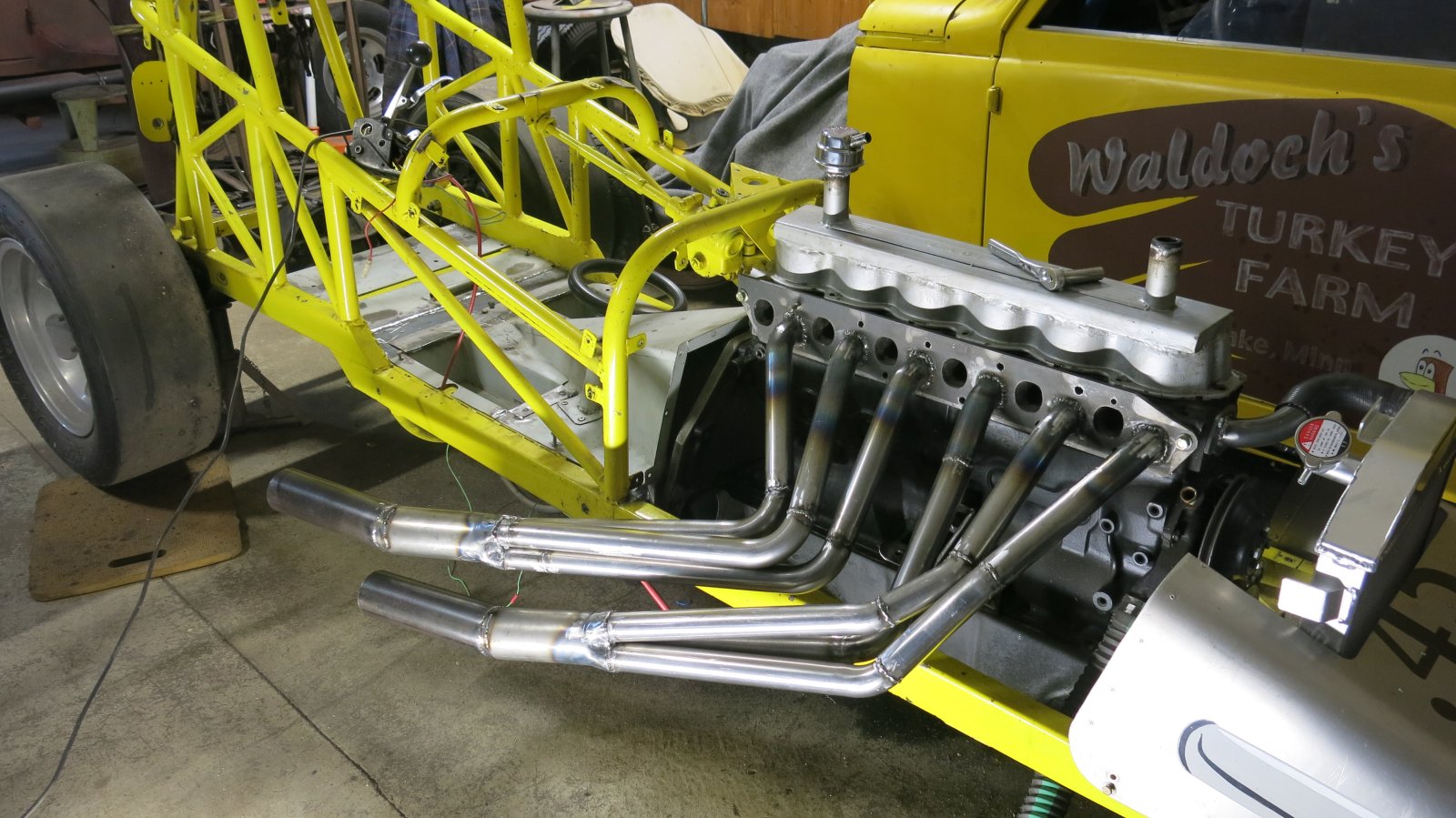

    In the process of removing around 100 pounds of excess weight. Changing to an Anglia front axle and narrow aluminum front wheels. Also made a header to replace the individual pipes.

    We only ran at two meets. A total of 6 runs. Five of them in the 10's. Best was our final run of the year. A 10.69 @ 118mph. This was with two 750 cfm Holley carbs. Will be changing to two 600 cfm Holleys for next season as it was a bit over carbed. IMG_3363.JPG Managed to remove 120 lbs. from it last winter.

    Fantastic. Do you think the new pipe work made a big difference? 120 lbs was a lot of t*******.
