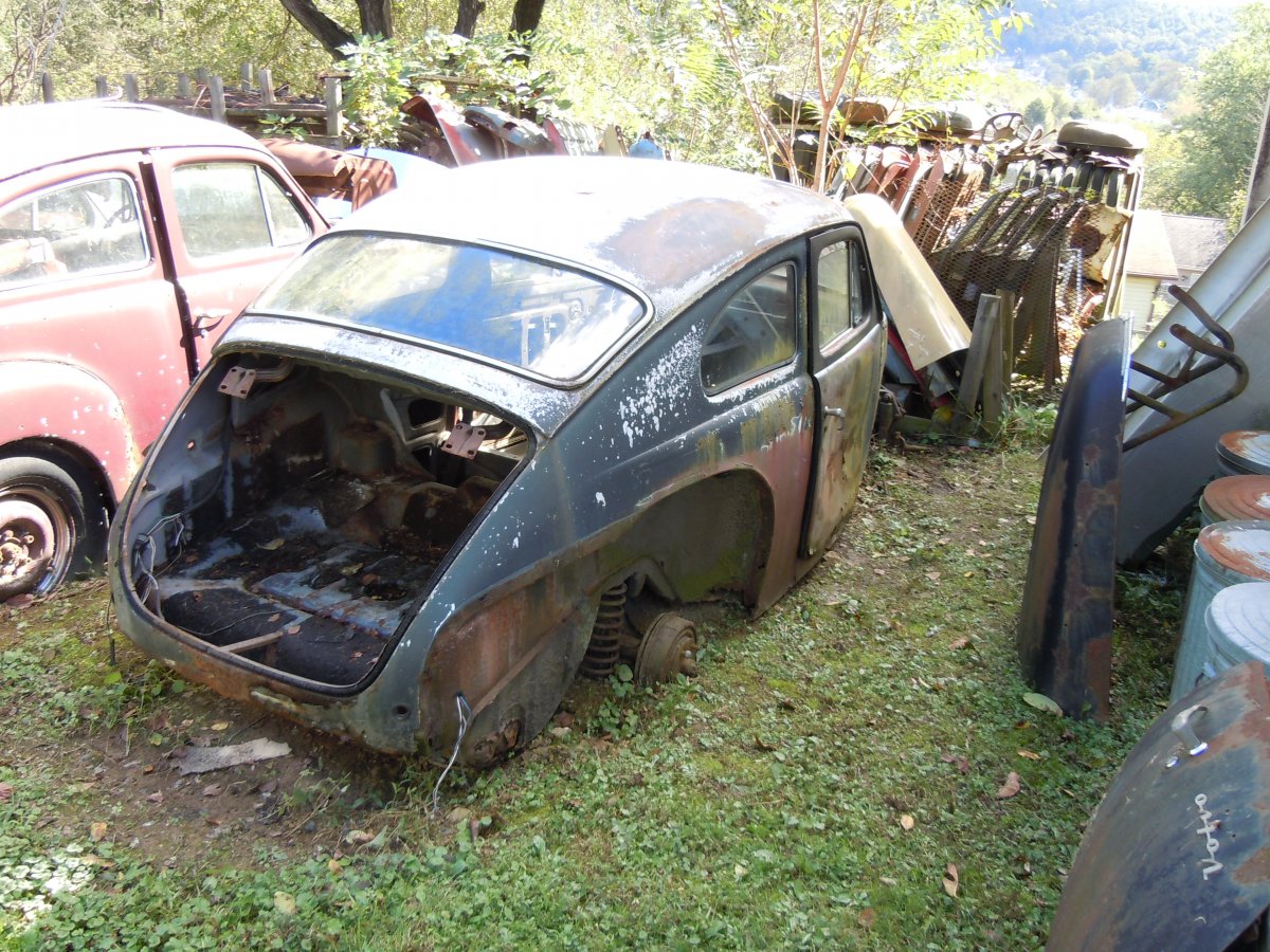

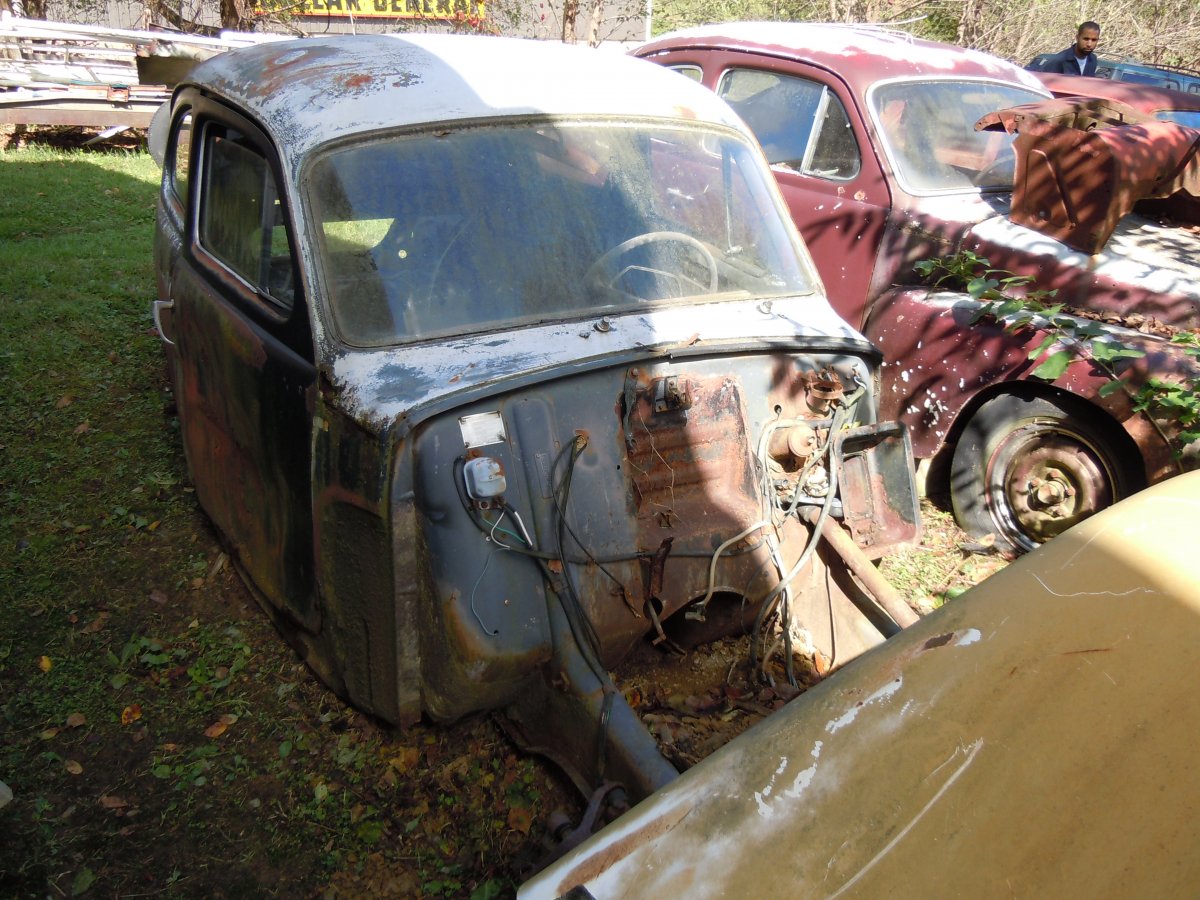

    This is going to be a long thread, heres a good start of us digging the body out and getting it so I can get it on a rollback. Its a '64 Volvo P544 buried to its' hubs and home to a few groundhogs. The guy let me have this one to save from the s****per, he felt the others too good to part with, they were restorable. 001.JPG 004.JPG

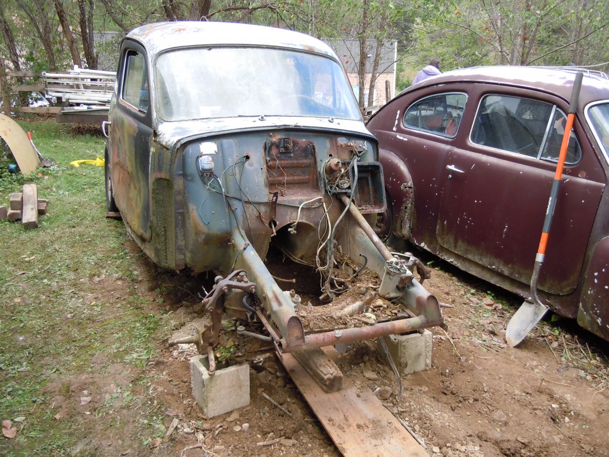

    We raised it enough to get a jack under the rear and then got it high enough to get some tires on the back. I hooked a comealong to a tree and drug it out enough to clear around the front and get some wood under it to slide it on and drug it out far enough so we can swing it around to get on a rollback. 012.JPG 010.JPG
    That whole front end was buried.

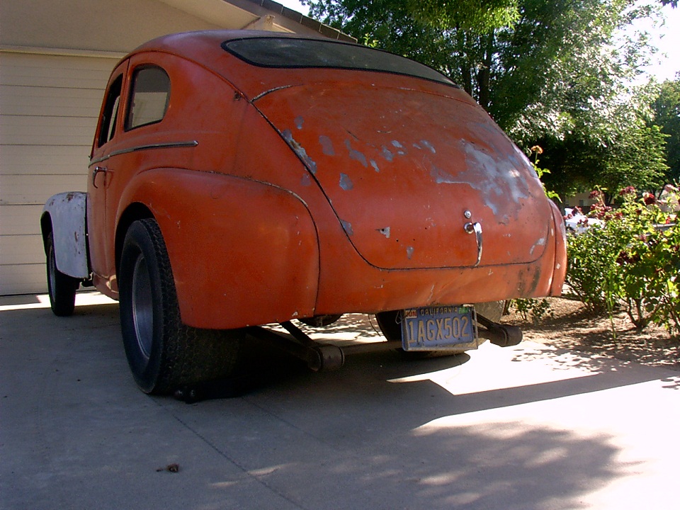

    Here is some pictures of one I sold awile back. For inspiration. johnspics 010.JPG johnspics 016.JPG johnspics 011.JPG
