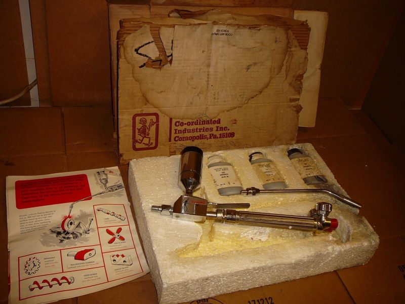

    Metalman, I may have missed it but what is the powder that he used to build up that area? I have one of these torches and have used it for hard surfacing. Would come in handy to build up areas and be able to machine it. The powder that we used can not be machined.
    Neal
    Stogy likes this.
  8. metalman
    Joined: Dec 30, 2006
    Posts: 3,299
    metalman
    He said it was silicon bronze he used on my block and told me it machines well. He did say there are different compounds, he uses something else on cams that has a harder surface but still machines.

    Well, yeah, something. If you've tried or know someone who has used this method and it failed , that's the info I'm looking for. If your saying you think it will fail that's no help. The engineer that makes the powder says it will work, the guy that repaired my block thinks it would as well but that's only in theory, they never actually done one. Looking for actual experience, not theory if you know what I mean.

    Today was my day to eat the bear as I just won this on E-VILBAY.

    We used this process where I worked to repair scored machine shafts bearing surfaces. Set the damaged shaft in a lathe,cover the ways with canvas cloth.heat the damaged area and spray with metal. When cooled then turn to the correct size.

    I have to think that the spraying process doesn't meld with the parent metal but grips it tightly on the surface such as brazing or soldering does. If thats correct, I wouldn't think it would be good for repairing a crack in something like a crankshaft.......but would probably work well on a shaft for just renewing a surface. This is just speculation on my part, but it seems logical. It would seem that it would be good for filling in but maybe not up to the task of handling certain stresses like a crankshaft would impose. Again, speculation by me.
