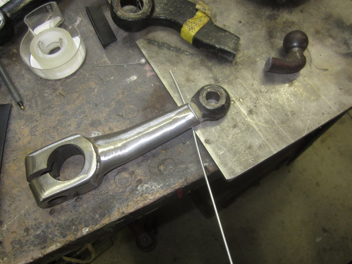

    Welded up the pitman arm today. Vied out , then preheated , started welding doing some peening along the way. Post heated, bring down the temperature slowly. Looks good! 312 wire flowed nicely. Paint springs and pitman tomorrow.

    Finished up the pitman arm. I use a bushing so I can reduce the size of the bolt. Better clearance and looks cleaner. IMG_7554.JPG IMG_7555.JPG Had to ream a pit since it was thicker than the stock 32. IMG_7556.JPG Back to the garage tom paint springs etc.

    Tig, eh? Decided not to use the cellophane tape after all I guess! LOL

    312 s/s. 120,000 psi. Tape not so much.

    OMG :eek::D They’re going to call you a criminal :D
    Everyone knows that you can’t weld steering parts :rolleyes::D
    Good job doing it right is always satisfying.:cool:

    Have done them before, never an issue. Thanks
