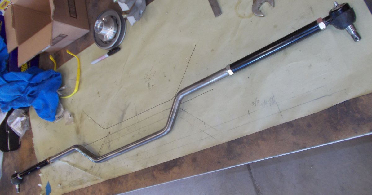

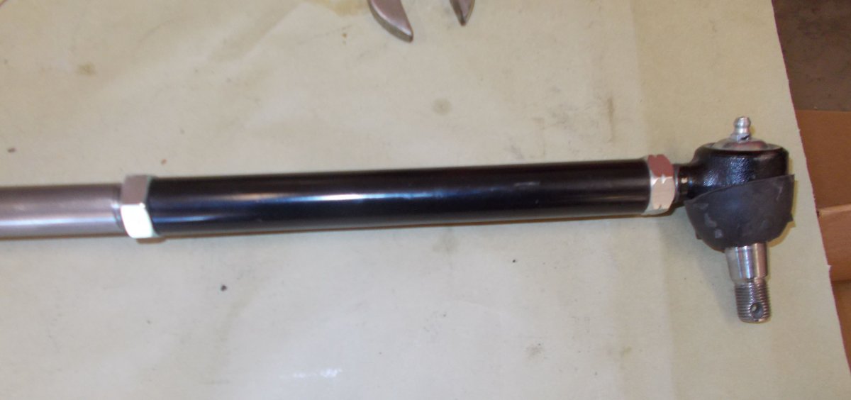

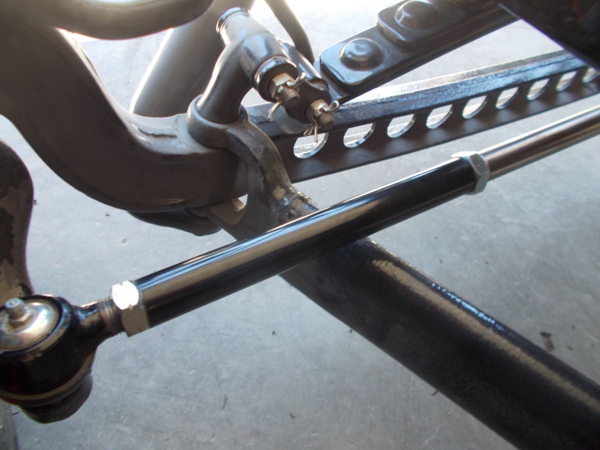

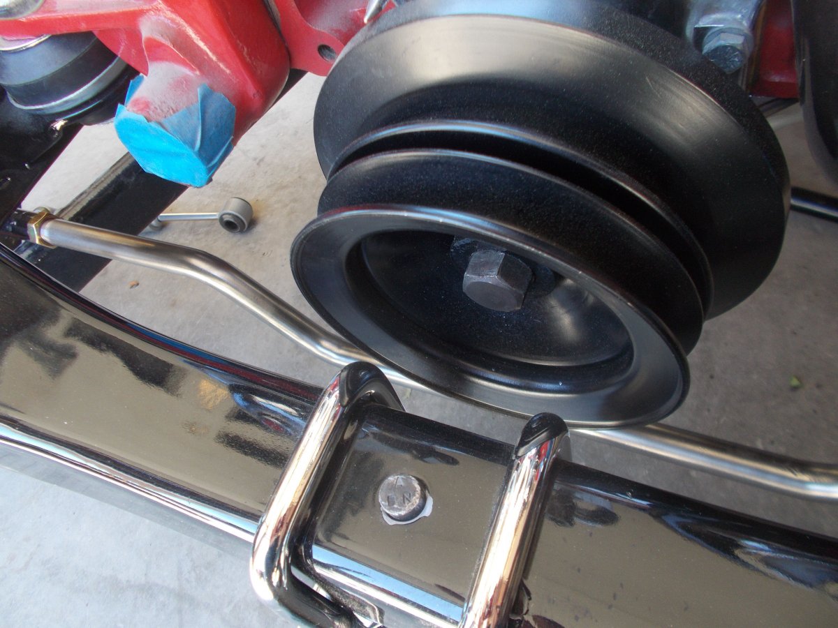

    How I dealt with the dropped axle on my '32. Ron tie1.jpg tie2.jpg tie3.jpg tie4.jpg

    Looks great. What diameter did you go with for the dropped center section of your tie-rod?[/ATTACH][/QUOTE]
