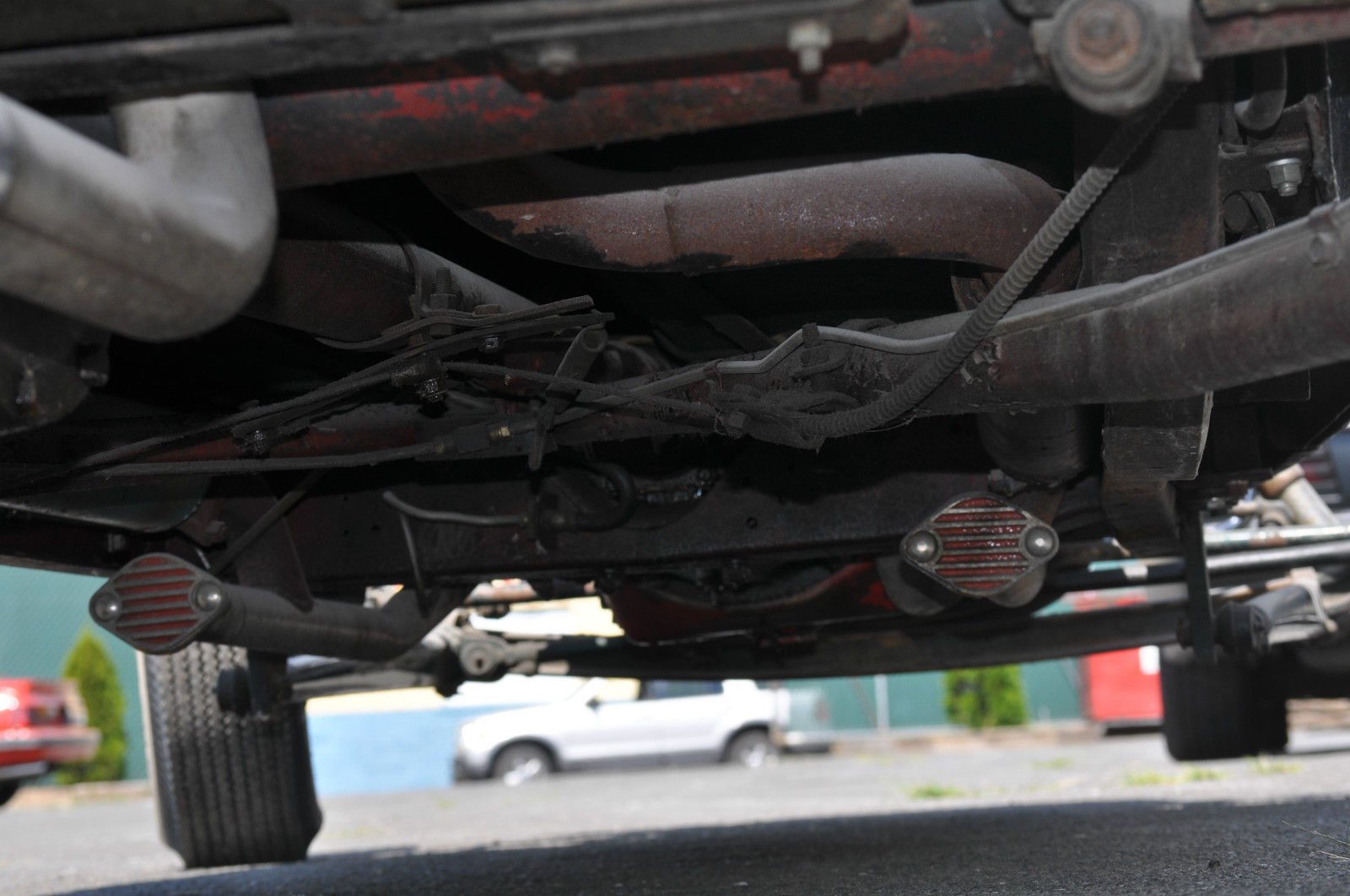

    Looks like a Model A front half with a '32 back half. See in this pic how the front part looks Model A and the back looks '32.

    Holy cow! I wondered what that lump was. That never crossed my mind it was the 32 frame contour. By the picture I posted it looked too curvey to be a model A frame. It bulges out like a 32 frame does. WOW who ever thought??

    In the pic you posted above from the rear, you can see the frame rail on the right as it goes up over the rear, it has the same shape as a '32 frame.

    Yep you can see right here they welded the two together! How bizzaro. Why would they do that?? Guess i'm going to have to ask that question when I talk to him $_57 (13).JPG

    My guess is that the front half of a Model A frame lends itself better for channeled cars...it's flatter and not as curvy in the front. And it already has a Model A front crossmember to get the front end lower than a '32 crossmember. The Model A frame horns are also shorter and look better than the long '32 horns curving down. my .02

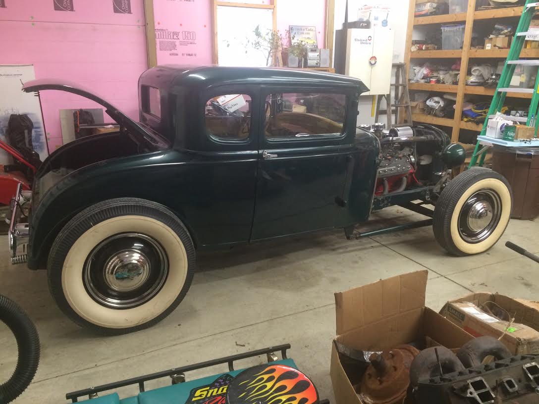

    Ok, finally, some updates. The car arrived this morning and couldn't be happier. It is a true piece of history. The battery was dead, but after I jumped a fresh battery to it the car started right up. The engine sounded great. The previous owner said there was a lifter noise that came and went. However, after a few seconds, I realized it wasn't a lifter noise but a water pump noise. So first order of business is to rebuild and/or replace the water pumps. I talked to the original builder and he told me the original engine was a 48 59AB that had been bored and stroked. So I was hoping when it arrived it didn't have a 49 mercury engine, like I had been told. I checked when it rolled off the trailer what the engine really was. Happy to say the original 48 engine still resides. I'm lucky this car still looks the same as it did back in the day, because I found out I'm actually the 4th owner. The original owner started building it during high school sometime in the mid-fifties. It was ***led in Oct.6 1958. He finished building it sometime in 1959, an owned it til around 2001. It is still painted the original Cadillac metallic green from the 1950s. However, it was an unfinished red raggedy interior so the second owner re-finished it to its current state. The second owner kept it for 10 years, and sold it to the individual that I purchased it from. What's amazing is that it was never ***led after 1958, so apparently the two previous owners never drove the coupe. The original owner is sending me some additional photographs, but here is one during its build. unnamed (19).jpg

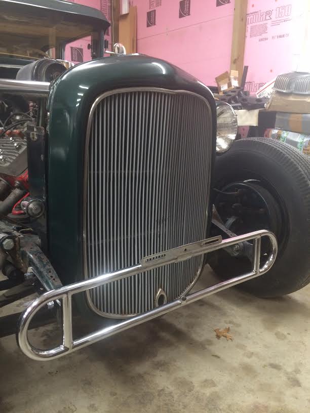

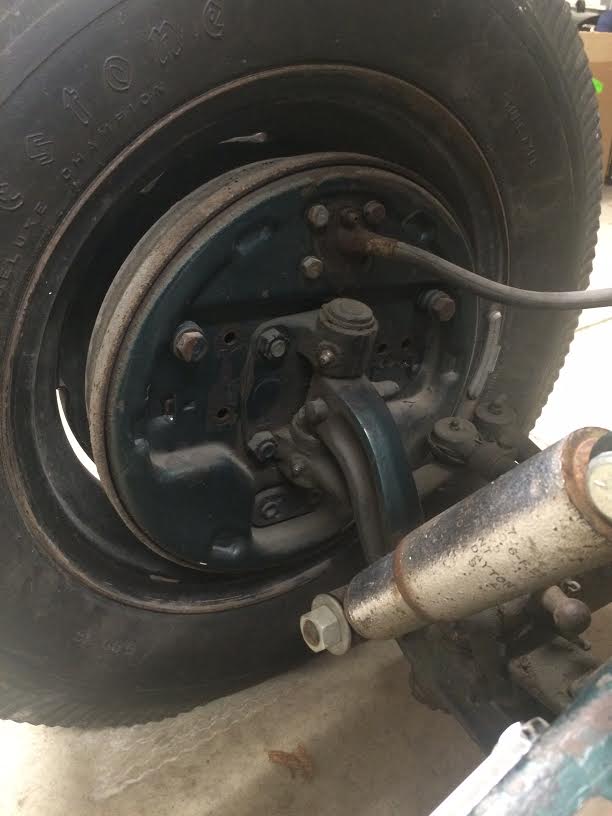

    Also here are some pictures of it since arriving unnamed (10).jpg unnamed (1).jpg unnamed.jpg unnamed (18).jpg unnamed (16).jpg unnamed (4).jpg unnamed (7).jpg unnamed (2).jpg unnamed (5).jpg unnamed (6).jpg unnamed (8).jpg unnamed (9).jpg unnamed (11).jpg unnamed (15).jpg unnamed (17).jpg unnamed (14).jpg unnamed (13).jpg unnamed (12).jpg

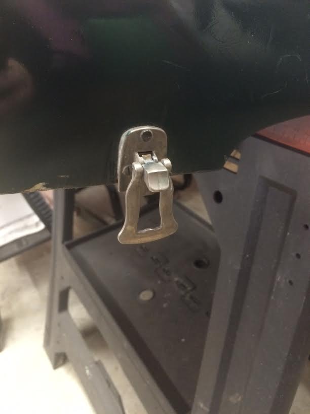

    Anther thing is the latches on the hood are broke. Trying to find unnamed (21).jpg some of these
