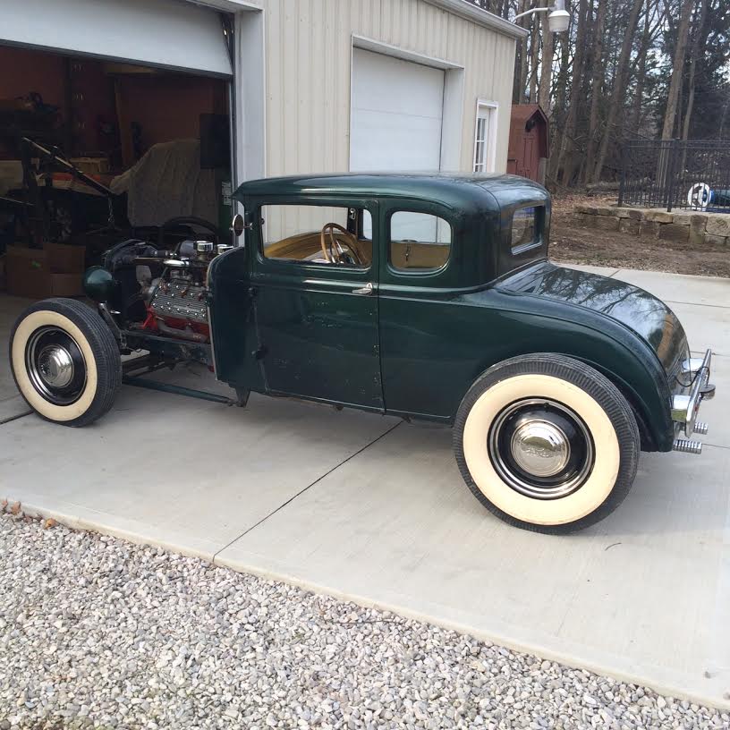

    outside.jpg Well I'd love to drive the wheels off of it but I definitely need to dig in and repair some things. I had some time to push it outside in the warm weather to start making a list of what needs done. It's a beast to push outside so I know the brakes need gone thru. Also I am leaking some oil. Does anyone know if the pan can be pulled and new rear seals installed in a 48 flatty?

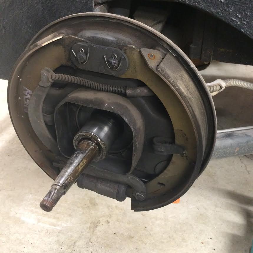

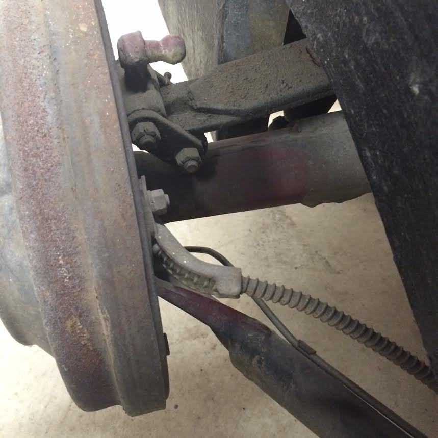

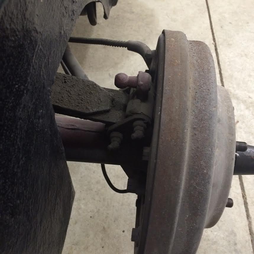

    Well I finally had the time to get out in the garage and start going thru some things. The car never rolled very easy so I figured the brakes needed some attention. I pulled the rear hub and found that the brakes were in great shape except I had a broken spring on the right rear and thats why the rear was tight. . But my biggest surprise was that the brakes were on upside down!!!! I'm not even sure if you can run them like this. It's never crossed my mind to put them like that. Another cool thing that I noticed was that the shackles had grease fittings! Old school. unnamed (5).jpg unnamed (7).jpg unnamed (6).jpg

    Guys who run A springs on top of the axle sometimes turn the brakes upside down for clearance of the wheel cylinder. As long as your bleeder is at the top of the cylinder (it's not upside down), you should be OK.
    Notice the inside surface of your backing plate, right inside the outer lip? See the scraped bare strip? That is from the brake drum rubbing, and might be a source for some squeaks. Might want to grind a little off the lip of the drum while you have it off to prevent those squeaks.

    Notice the cylinder swapped side to side to get the bleeder on top and large bore forward

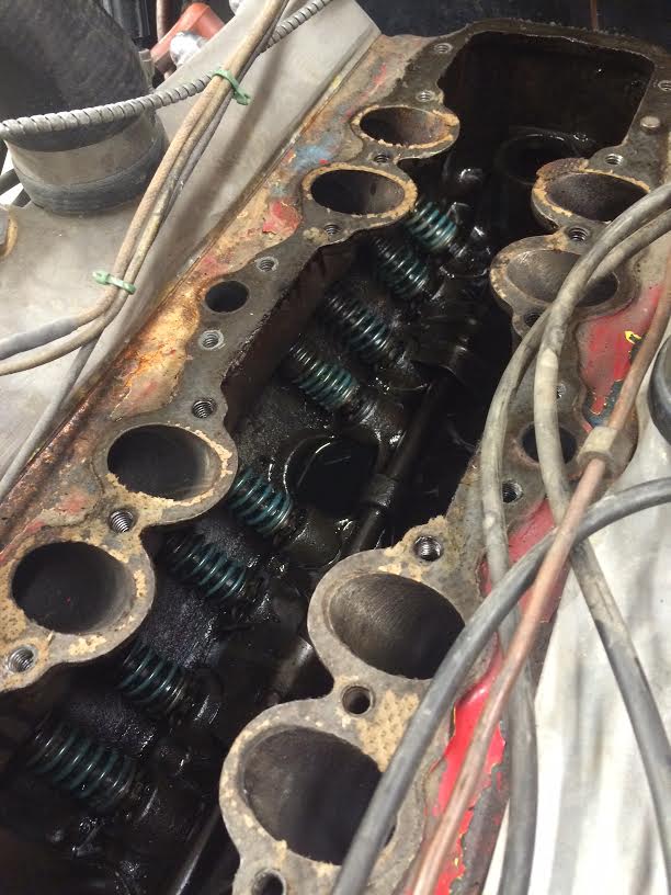

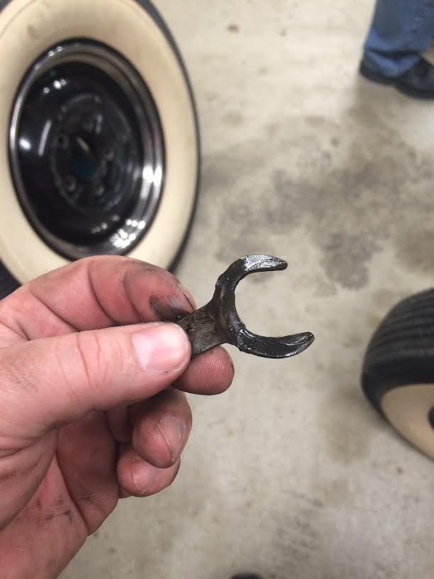

    Well i had time to investigate the tick in the motor. Pulled the intake then the passenger side cylinder head. 59AB is toast. Going to totally have to rebuild it or find a quick good running replacement. Cylinder walls were bone dry and i had two bent to hell valve spring retainers.
