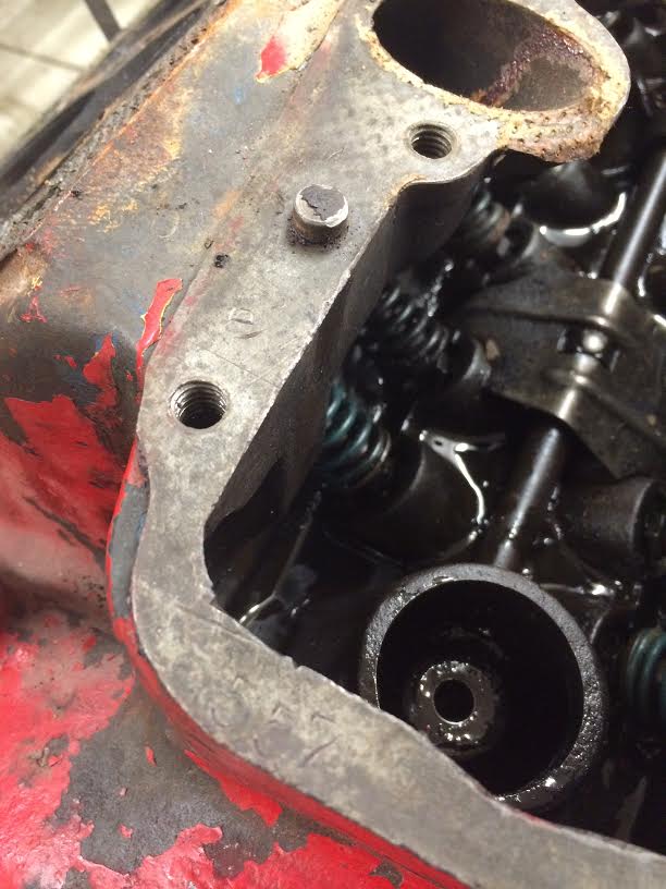

    The valve keepers were probably just poorly installed
    looks like it has adjustably lifters, sure it wasnt just loose lash? what do you mean by "dry cylinders" sometimes a motor might not be the prettiest inside but will run ok, did you do a compression test before your tore into it? why not just replace the couple valve keepers, adjust the valves and stick it back together, a pair of head gaskets and intake is relatively cheap.

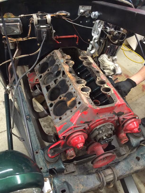

    Ok I've pulled the 59ab apart and it looks a bit rough. Im looking for a good replacement. My question is should I only put a 59ab back in its place or should I be open to a 8ba? I actually have a 1953 Merc sitting on a engine stand that I could use.

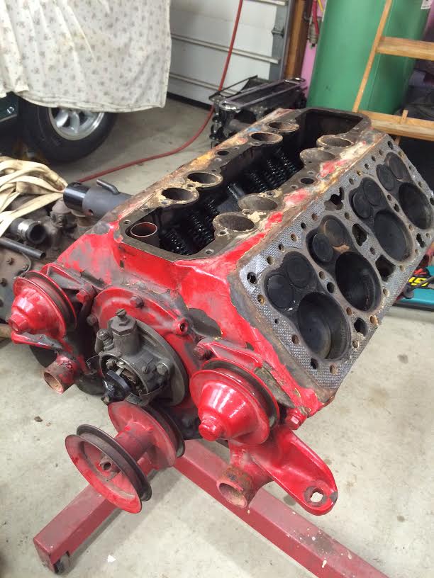

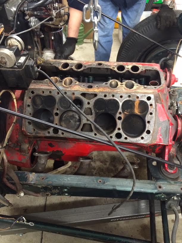

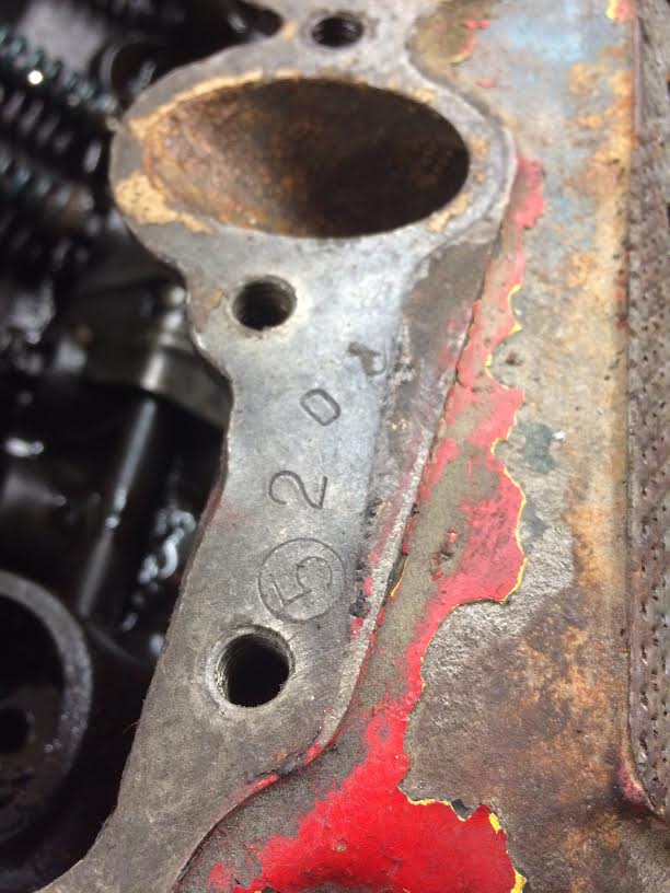

    Well little update. Finally got the engine out. Thought it was a 46-48 59AB but it ended up being a 41-42 raised intake type block with 46-48 crank pulley and water pumps. Already has a 3 3/16 bore but isn't a Mercury. Not sure how much more these blocks can go. Learning more and more. Here are some photo's unnamed (19).jpg unnamed (18).jpg unnamed (17).jpg unnamed (16).jpg unnamed (12).jpg unnamed (14).jpg unnamed (11).jpg unnamed (12).jpg

  10. Some real oldtimers said "bore 'till you hit water, then sleeve it!"
    In reality 3-3/8" is practical.
    In my humble opinion.
    The 4 inch Merc crank is the rest of the story.
    By the way if you haven't heard, 8RT truck engines
    also had Merc cranks, (some not all) just because they were "truck" engines.
    You'll probably get more opinions!

    I have one of those blocks in my sedan and it's currently bored to 3-3/8". Stick your finger inside the water hole and you'll see how thick those walls are.

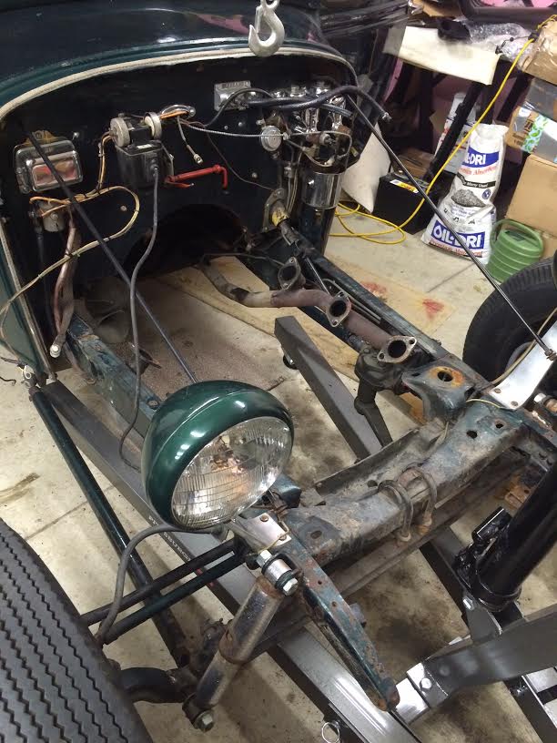

  13. Fix the engine and don't alter anything else... keep it in a "Controlled state of decay".
    It is what it is... a classic hot rod ... not a resto-rod... not a street rod, not a pro-built traditional rod (that always miss the mark!) a true home built Hot Rod!

    I hear you Tony. I'm rebuilding the motor putting it back to green the way it was originally and removing the red paint off the linkage and bottom of carbs that the third owner put on. Fixing some wiring and off I go.

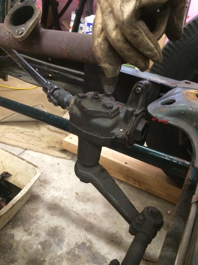

  20. Ford used cross steering early on, my Model A has a 1941 box.

    I was hoping it was Ford steering but a vintage Vega box found it's way in at some point steering box.jpg

    The motor is underway being built. I was the lucky the 1941 block was savable. It was already bored to 239 and I had to go 30 more over. But I had the wall thickness and the block had zero cracks. Pete's grinding up a Potvin 3/8 camshaft for me that should sound real nice.
    Master cylinders were pulled apart and they look like I should be able to clean them up and just put in rebuild kits. I'm lucky because I couldn't find any place that sold chrome 52 masters.
