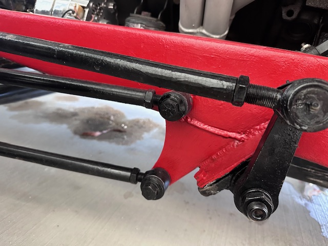

    You hinted F-100 in one post. Here is how we did a F-100 box ('57 & up arm) in a deuce with split bones (would have the period look you mentioned). Wouldn't worry about heating and bending the steering arms again if needed; after all they are good Henry Ford forged steel.

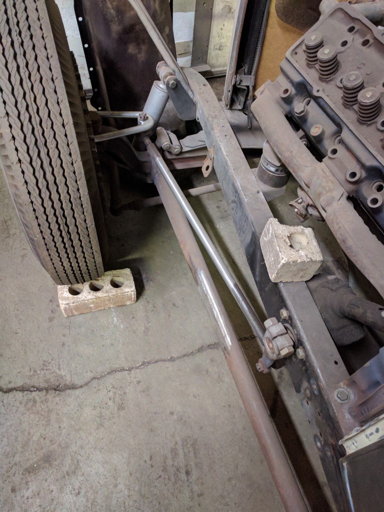

    Keep in mind that with the mustang box and the pitman arm pointing up that you will have bump steer with split wishbones and hairpins. you will not have bump steer with 4 bars....

    thanks again for posting.... My guess the car was done 50 years ago....it has a real 32 ch***is and a really nice steel body...so my thought was kick it back to more traditional looking... the ch***is works excellent, nothing weird , and pretty smooth ride... no clanking and such.... but every idea i get short off cutting everything off and starting over...I hit a differant road block.... this whole set up would be *****en in my full fendered 31 more door Cdan... I'd endup with dropped axel and disc brakes... but it's 5 on 4.5 bolt pattern.. IMG_6133.jpg I could also use the drilled split bones...
  13. ALLDONE
    Joined: May 16, 2023
    Posts: 3,809
    ALLDONE
    here's some better pics of what i got...all ideas and suggestions welcome...

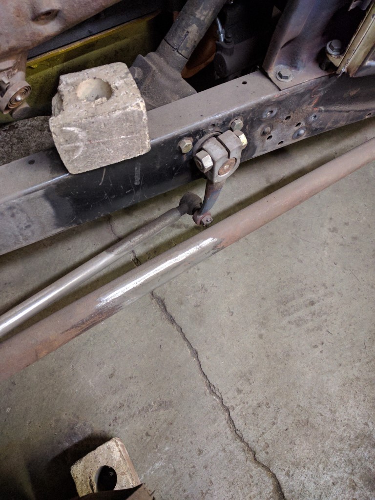

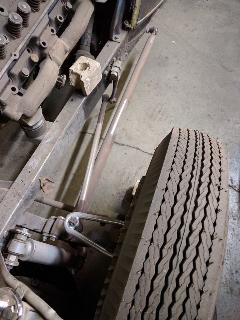

    there has to be something i'm just noT seeing... the 4 bars are only 17'' long pretty sure that would too short for a hair pin
    here you can see how far the steering box is pushed forward.. I didn't really look at this part with the fenders on.. i seen the 4 bar.. and figured it was an easy swap..

    look at this pic... if I use the top mount bolt , and use a flat top hair pin...it would work the same as a stock ford steering....right???

    the drag link and the top bar of the 4 bar is close to level...parallel

    might be ok if you can use the top hole.... looks close to the same plane
