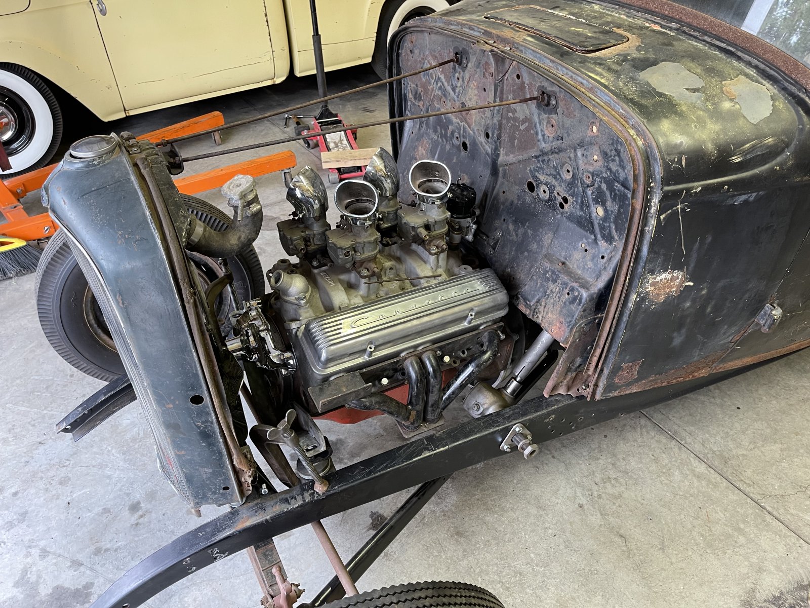

    Tonight I picked my transmission bearing retainer and some other parts from the sand blaster, so that I could bolt the transmission to the frame. Got home, pulled the engine/trans out, installed rear trans mount, trimmed firewall and set it all back together. Now everything lines up and fits better. The fan was still pretty close to the radiator and the blades got the lower outlet. It’s an old modified factory V8 radiator…I have an extremely nice 4 cyl radiator here that actually looks like it would work better with some modifications. I tried it and the fan clears great. So may run that one if it lives.

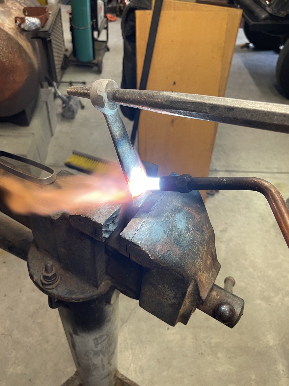

    Did a little more last night. I’m using a converted F1 box, and I have a 40’s Ford pitman arm. They angle in towards the frame, so heat and bent it out a little. Need to clean it up, file the 4 large teeth down, and revers taper the tie rod end hole. I did this same thing on my 34 roadster, it works well.

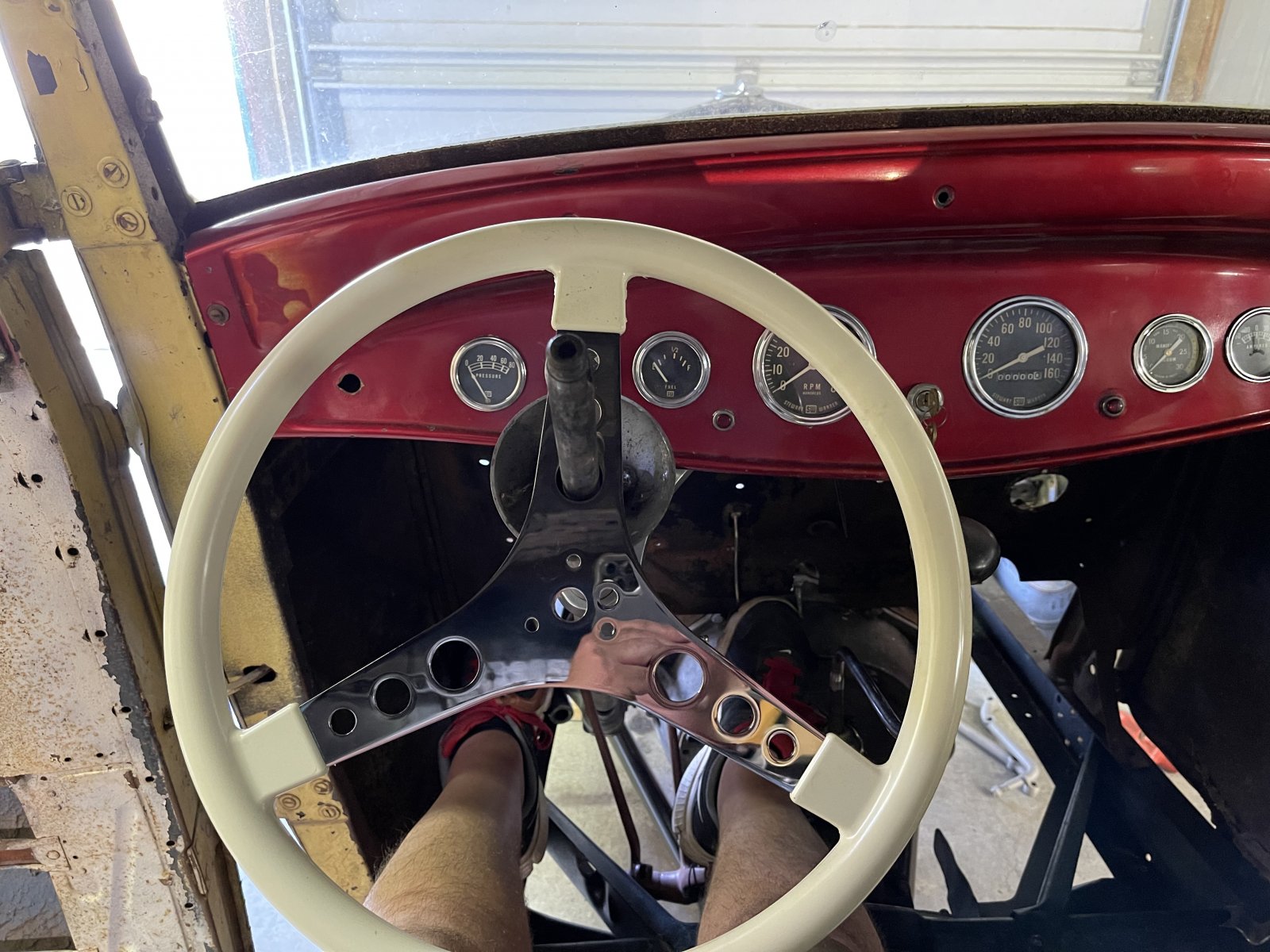

    Tonight I got the package tray out, played some boards in it and set the seat bottom from my 34 in it. I’m going to use a stock 32 seat, but hopefully modified enough that it’s roomier. It’s only a 2” chop, so I’m not super worried about interior room. With the seat shoved back and lowered down it should be fine.
    3BD5E11B-E24D-47A3-AA70-A7FB0117C7D2.jpeg 8A512B9B-050E-4DC3-9C19-5FF1D1D31993.jpeg
