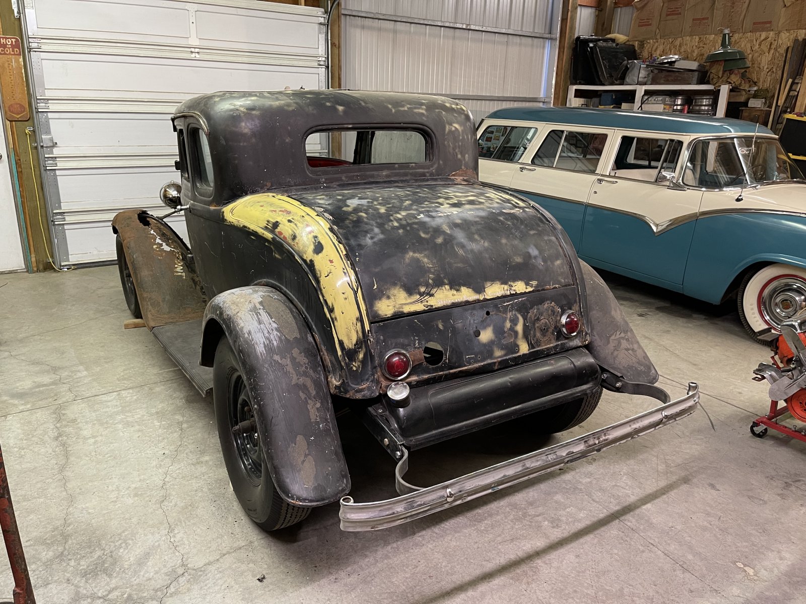

    Can anyone make out the club plaque in the rear window?

    Pacers? as for where it looks like it might be two separate words at the bottom...

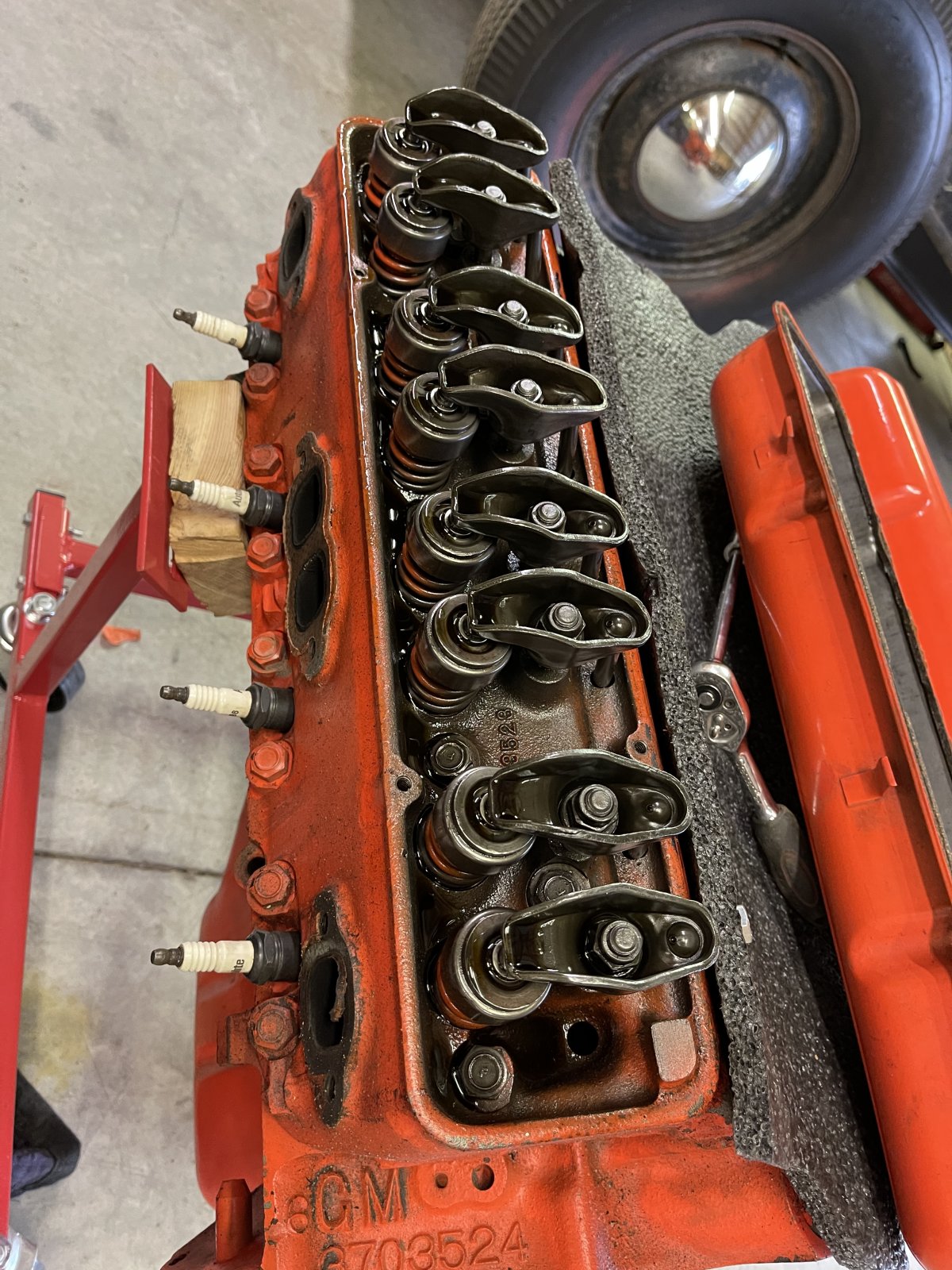

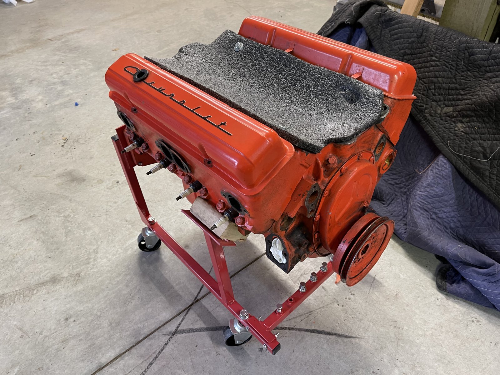

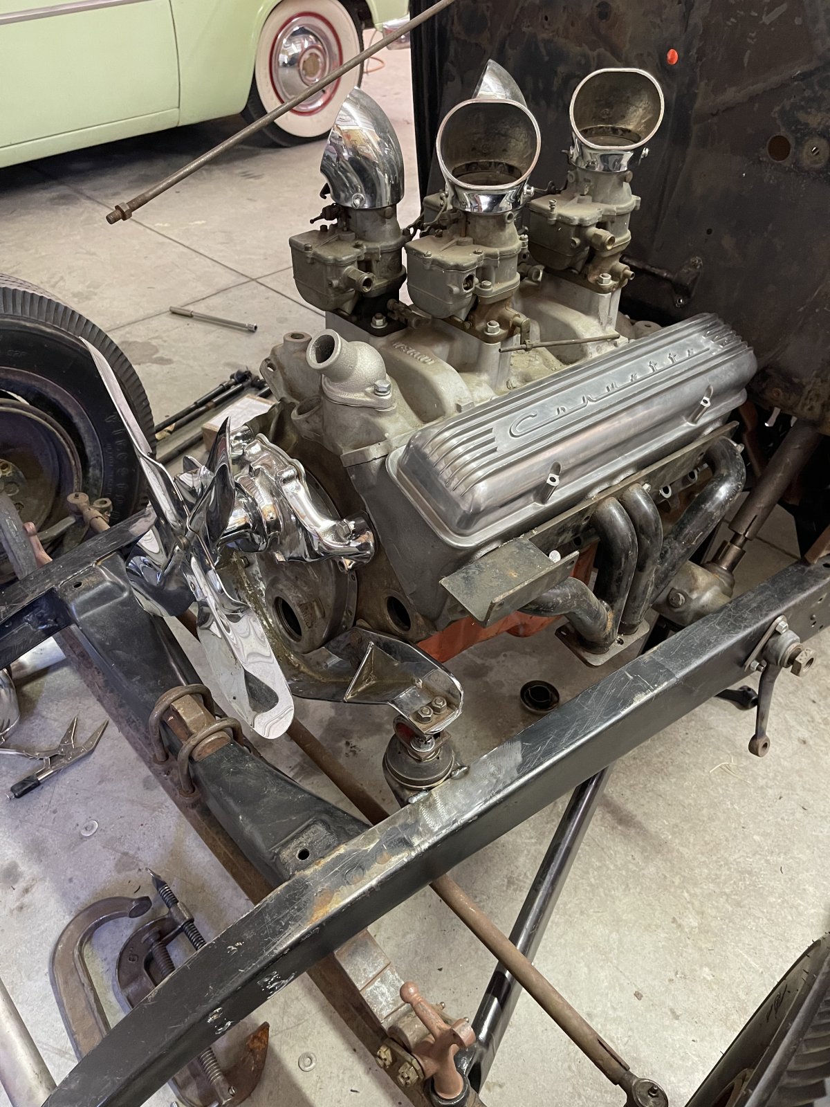

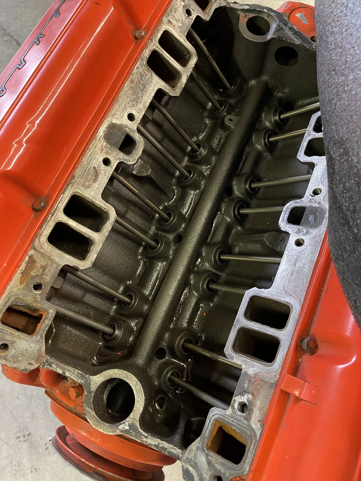

    I have not done a lot the past few days. I have an appointment with the state patrol to do an inspection on it so I can start the ***le process. I’ll need to rig lights, fenders, bumpers on it for that…yes it’s as dumb as it sounds
    In other news, a friend of mine called me a week or so back and offered me a rebuilt 265 out of his 56 Vette. Said he replaced it with a 327 and never looked back. Said if I can use the engine, it’s mine. He did mention it made a weird noise he could never figure out, but he drove it for 3 years with no issues…so I went and picked it up today. It may go into the 32, at least for now?

  8. Big mike 1968
    Joined: Jul 17, 2021
    Posts: 187
    Big mike 1968
    That's an awesome deal. Maybe something really simple. Good luck.

  10. FritzJr
    Joined: Feb 11, 2007
    Posts: 863
    FritzJr
    That 265 engine is a 1955. It did not belong in a '56 Vette.
    Thor1 and Stogy like this.
  11. Chris

    All I know is it came out of a restored 56 Vette. Being's it's going into a Ford, it probably makes no difference

  12. paul55

    They used the 265 all the way into '57.

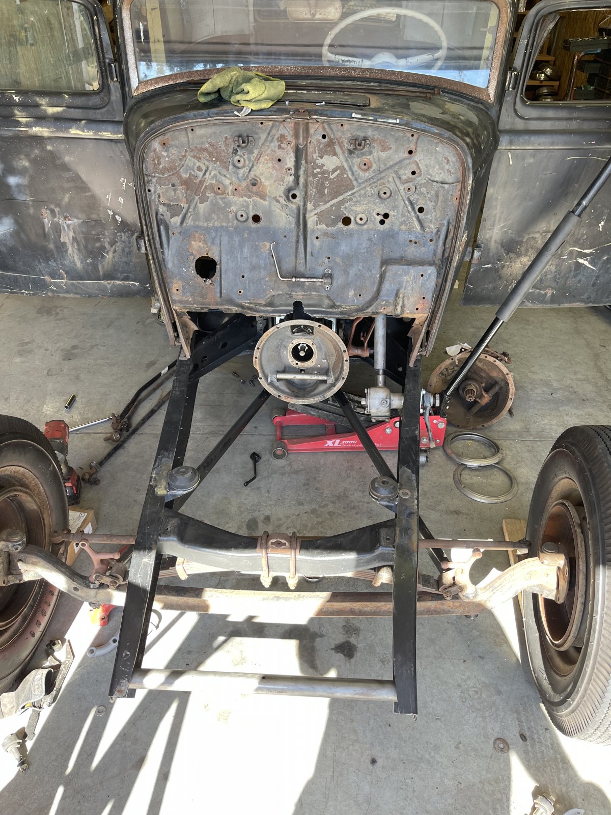

  14. Chris
    Joined: Jan 5, 2005
    Posts: 14,500
    Chris

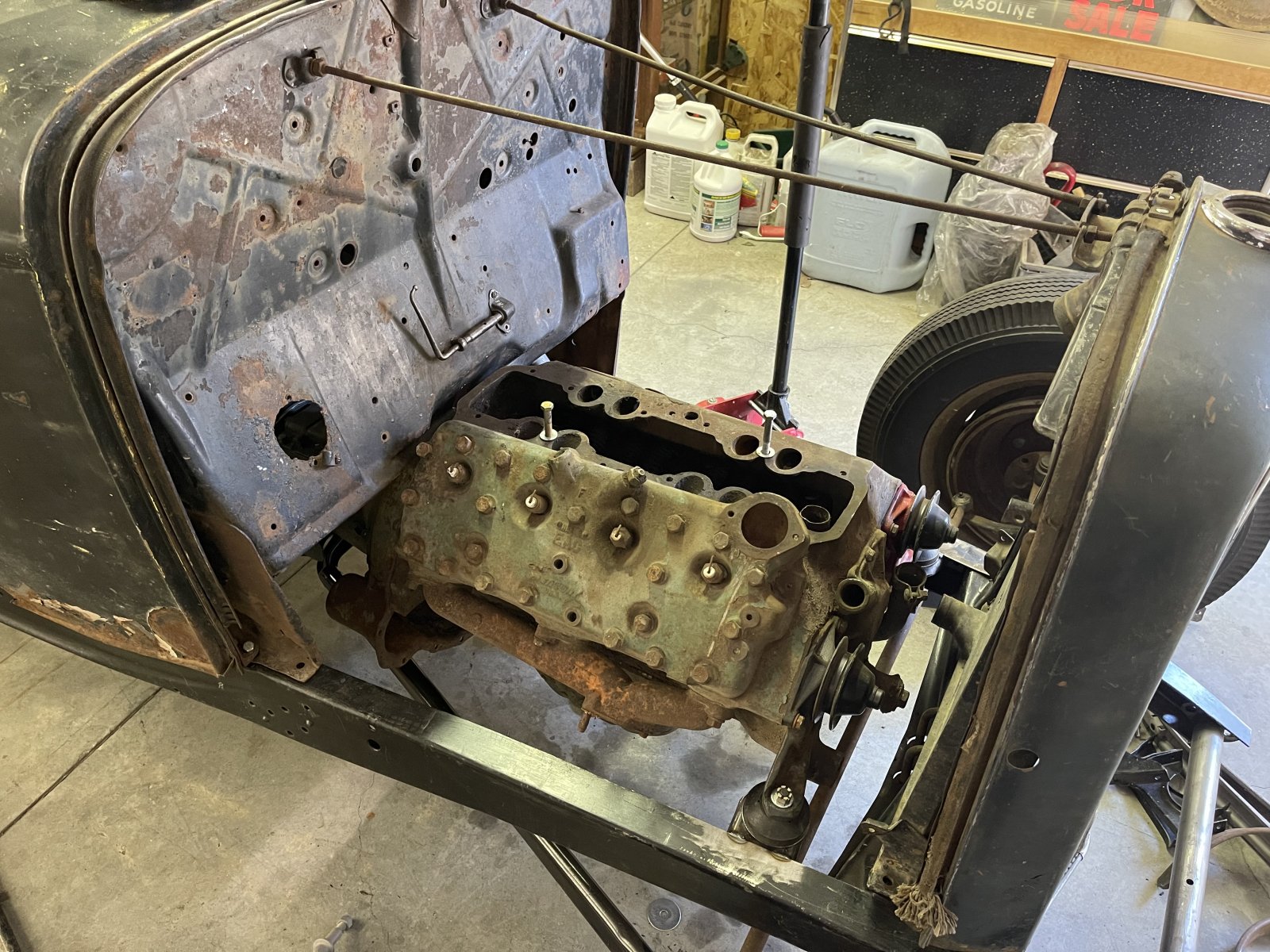

    Getting it ready for its inspection, I bolted on the old chrome Hurst front mount I got off eBay that showed up on the brown truck yesterday, welded the engine mounts in, then pulled the 283 out. Bolted a crusty Flathead in it so it is more stockish. This engine came with the car and so I figured I should use it as I have pics of the car when I got it (in case the WA State patrol officer wants to see them). The ***ling process in WA is a pain…but I try to play by the rules. Like the little sign at my local Hells Angles club house says “honestly matters”.
    the Flathead bolted right in where the chev mounts were.
    caseyajones, alfin32, Tim and 13 others like this.
  15. Taboo56Chevy
    Joined: May 21, 2018
    Posts: 2,129
    Taboo56Chevy
    It doesnt really matter, but the casting number is for a 55. So the question then is does it have a provision for a oil filter? 55 265's didnt have one so you would need a beehive or some external/remote filter, where 56 engines had the filter cannister that all other small blocks would have up to 67 before going to spin on filters. If you find the noise and its related to the cam, any new cam needs the oiling groove on the back lobe otherwise it wont push oil to the upper end of the engine.
  16. Chris
    Joined: Jan 5, 2005
    Posts: 14,500
    Chris
    Yes, I realize it' a 55 engine. It has no oil filter or starter provision. It still came out of a 56 Vette, obviously not the original engine to the car. I do know about the early cams, if I run this engine, I may jam a little lumpier cam in anyways. My friend described the sound as like a noisy fuel pump. He had the pan off (while in the car) and could never figure out what it was.

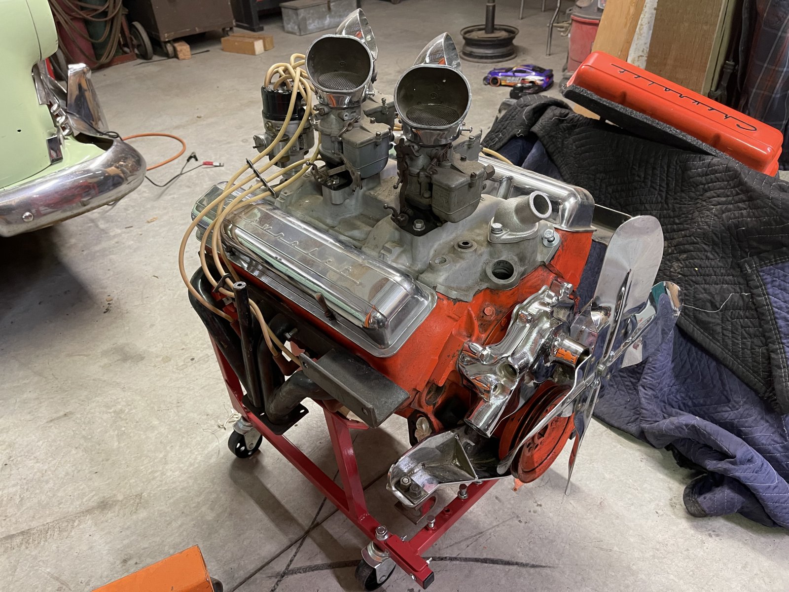

  17. Corn Fed
    Joined: May 16, 2002
    Posts: 3,452
    Corn Fed
    That SBC has all the old goodies....but I think your 2nd carb is gonna leak a bit .

  19. -Brent-
    Joined: Nov 20, 2006
    Posts: 7,894
    -Brent-
    I've been looking for an already chromed Hurst mount, dangit!

  20. -Brent-
    Posts: 7,894
    -Brent-
    @Chris do your Hedman's have the collectors?
  21. Chris
    Joined: Jan 5, 2005
    Posts: 14,500
    Chris
    They do, although they don't fit early Fords too well. I may modify and use them? Not sure yet

  22. Chris
    Joined: Jan 5, 2005
    Posts: 14,500
    Chris

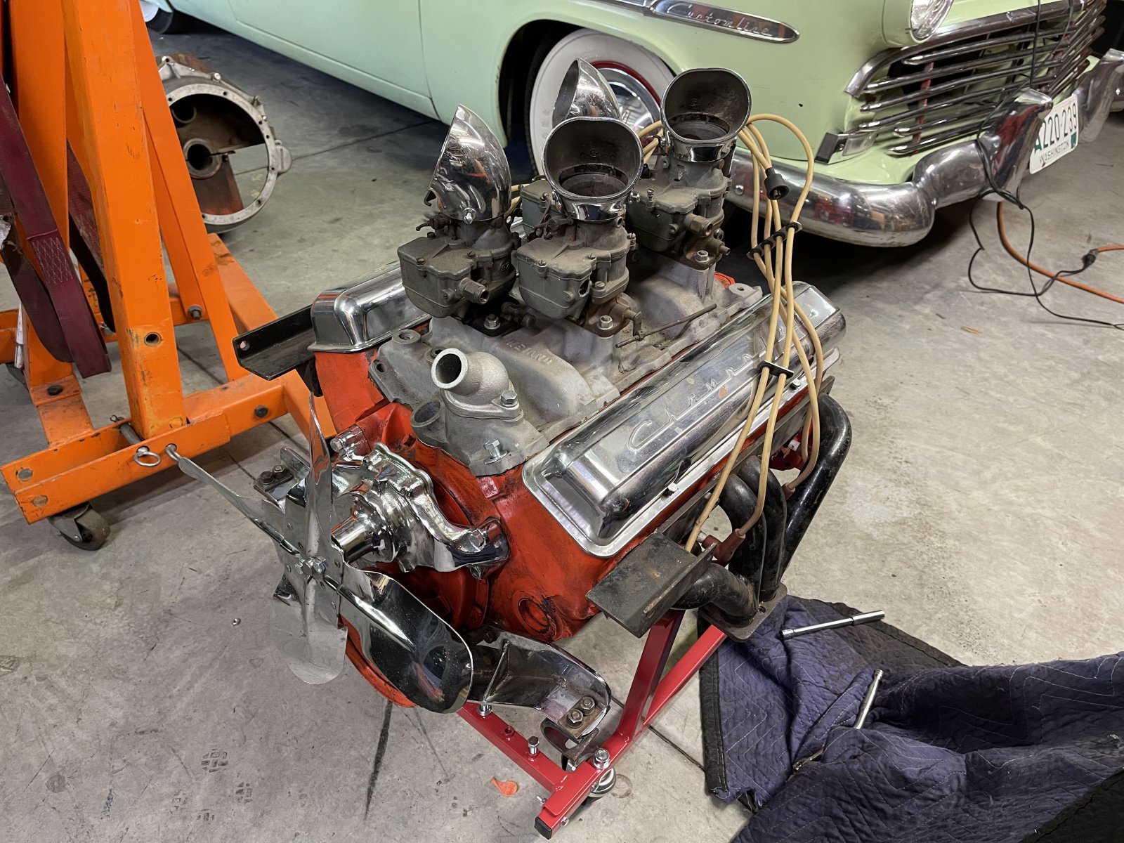

    While pulling the chev out yesterday, I thought the 265 was a good place to store the neat stuff

    One of my favorite intake manifolds all time.

    Chrome motor mount and water pump… Sweeeeet

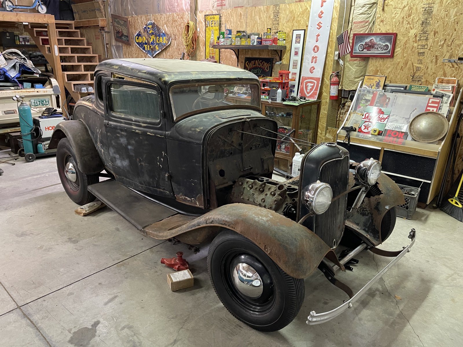

    Inspection is Thursday… I kind of like it HAHAHA

    Holy fenders batman!!! Those front fenders are terrible. Do you think that will p*** inspection?

    The fenders will get so much attention that they may overlook some things.

    It’s only a vin inspection because I don’t have a ***le. All they will do is verify the vin umber and put a WA state vin tag on it. Then I register it and 3 years later I get a ***le. It’s not a safety inspection HOWEVER…WA state requires the vehicle to be fairly complete and equipped for street legal- lights, bumpers, horn, etc. Really dumb. Maybe it’s overkill for such an old car? But it takes weeks to get an inspection scheduled, so I don’t want to do it again.
