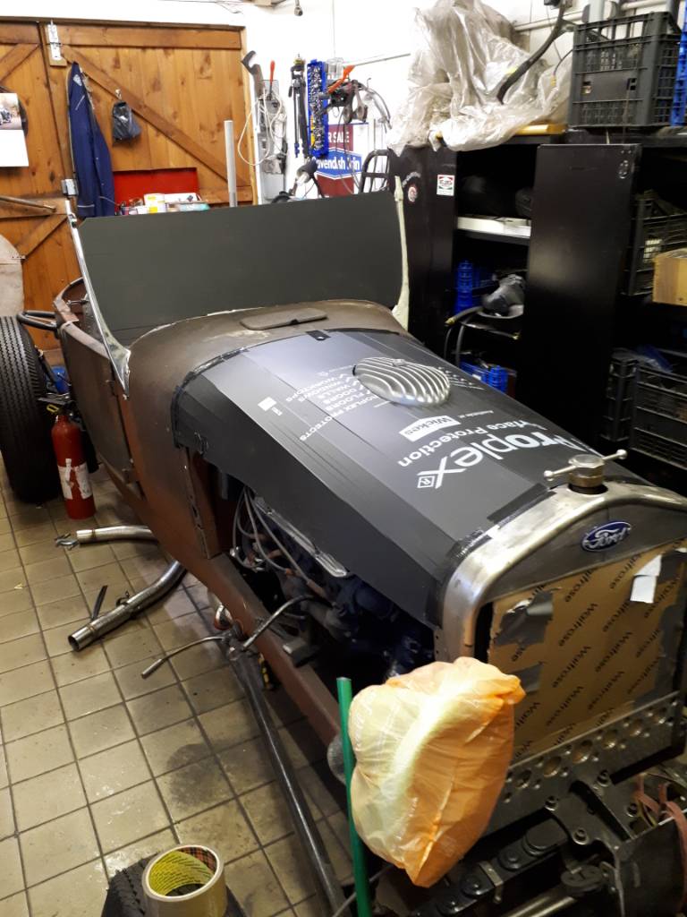

    I am about to attempt to build myself a half hood on my 1926 Model T project.
    I am looking for some guidance and helpful comments to get me started.
    I am considering making a wooden form replicating the firewall and grille shell ends.
    The span is approx 32 1/2".
    I've had a couple of pic's kindly photo shopped by madfish and have decided to take the next steps.
    I have no set ideas as far as material choice or holding down methods etc...

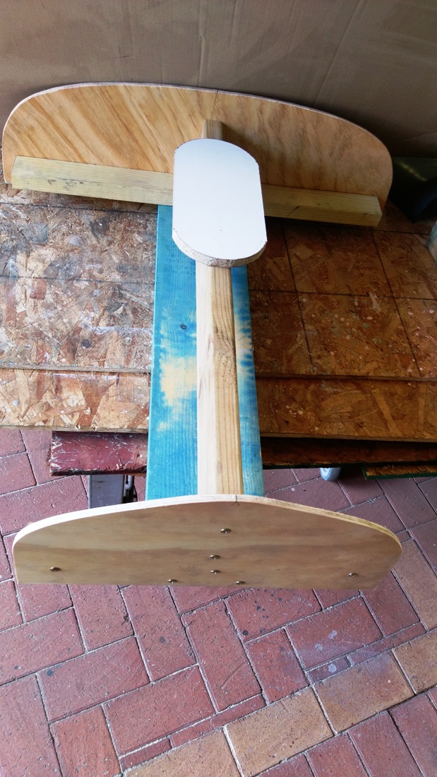

    I have made a replica of the firewall and grille shell ends and spaced them to the correct distance apart.
    I have also made a pattern in wood of the twin carb foot print with clearance included.
    I have concerns about the variation between the front and rear profiles, will this be difficult to shape to fit???

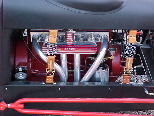

    Used SS springs, harness hardware and leather from a tack shop. SS coachman loops from West Marine.
    kidcampbell71, Jet96, Stogy and 2 others like this.

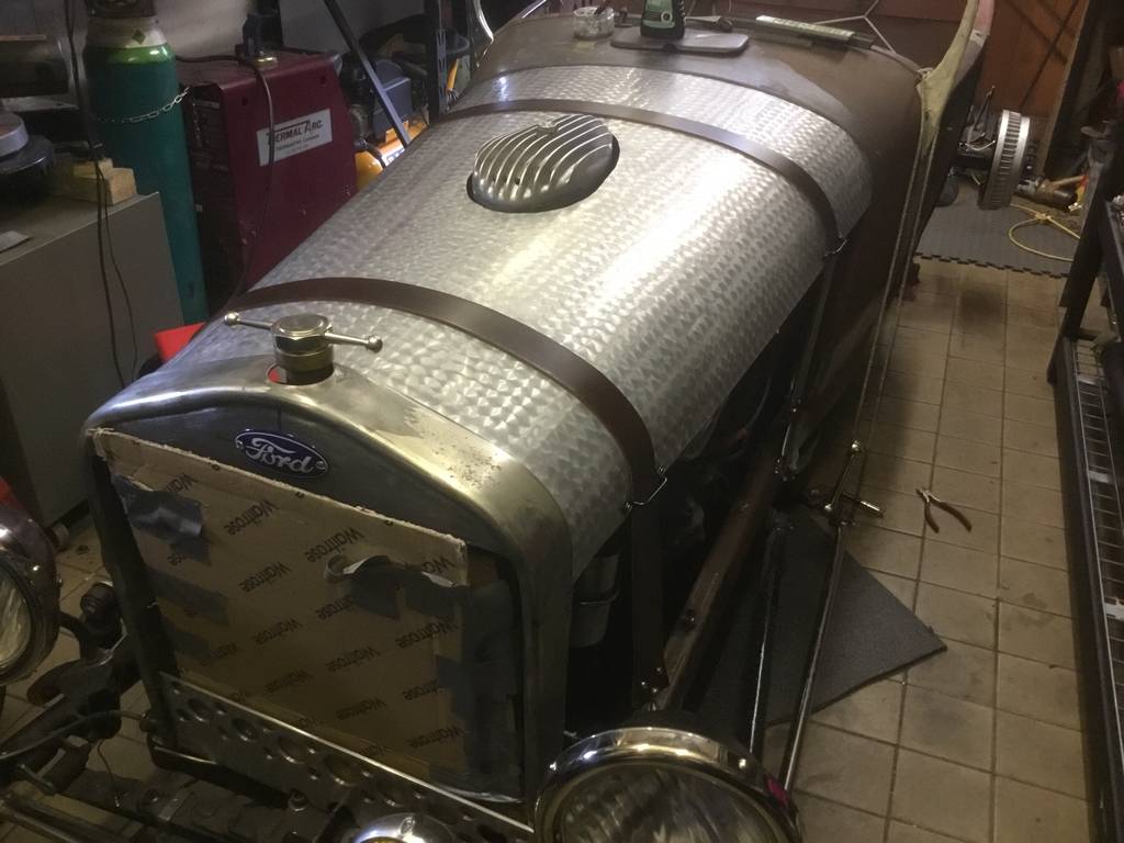

  13. fiftyv8
    Joined: Mar 11, 2007
    Posts: 5,401
    fiftyv8
    from CO & WA

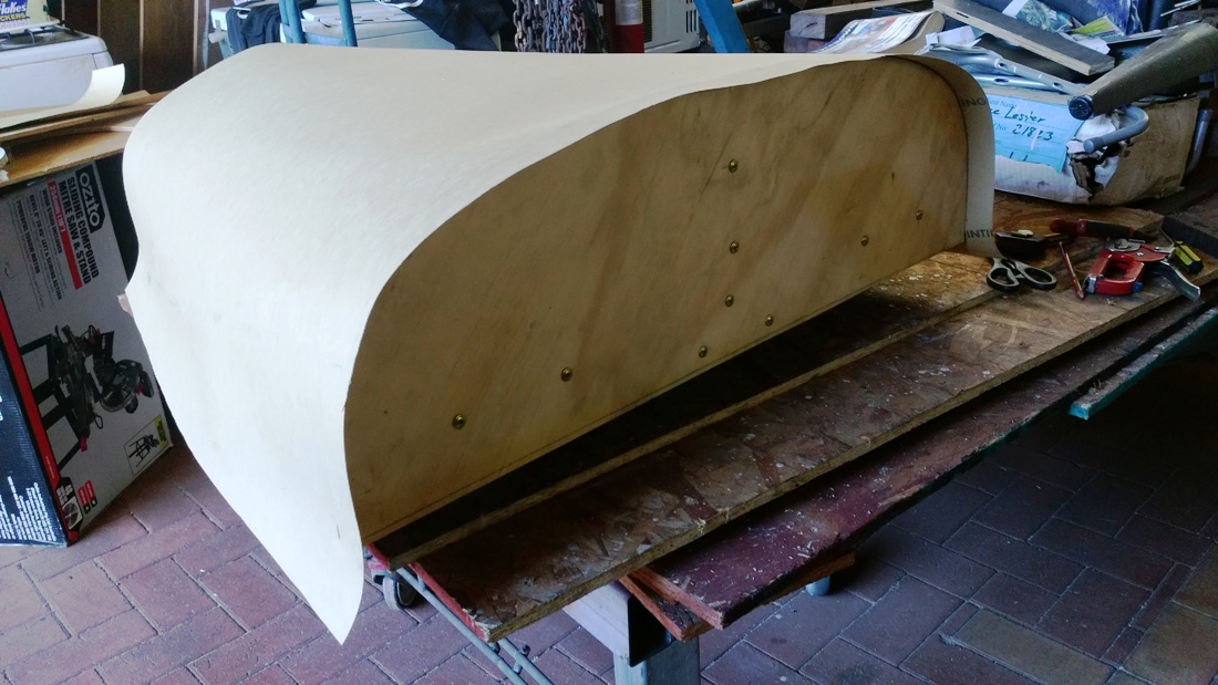

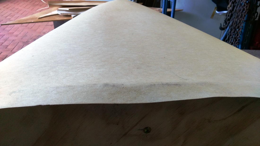

    OK, just by good luck, I remembered I had a huge roll of suitably thick gasket paper that was a good width on the roll.
    I cut a piece off and have managed to wrap it over my replica engine bay profiles and stapled it to the wood.
    I am pretty pleased with how it has taken the shape with no stress points.
    That was my first concern, as I had expected to be finding stress points because of the difference in front and rear profile was quite different.
    So far so good.
    Now I have something to look at and I also feel a little more relaxed about the air cleaner cut out area as it sits a lot flatter in that area than I had anticipated, maybe I was just over thinking it...
    Probably a dumb idea, but it had p***ed thru my mind that maybe I could make a left and right hand side and run a turned 90 degree edge down the center of the hood from front to rear and say spot weld them together showing a fake seam/joint.
    This though occurred to me as an way of dealing with the air cleaner cut out challenge.
    Any thoughts folks.

  16. jaw22w
    Joined: Mar 2, 2013
    Posts: 1,723
    jaw22w
    from Indiana
    20 gauge steel works nice for the hood. I rolled my own over an oxygen bottle. IMG_0027.JPG
  17. nunattax
    Joined: Jan 10, 2011
    Posts: 3,391
    nunattax
    ive never attempted this but im sure a solid stable platform would help.take the first picture I would add diagionals from the front corners to the rear corners with timber the same thickness as the blue piece.ie you removed a little at the front piece so the buck would sit flat on a table for example you would have a stable buck to work with.im from a carpentry background /worked in workshops for years.im sure the better the buck the better the finished hood will be.screw the buck to the table or hold it with clamps.best wishes and good luck.im following with interest ps I would use mdf instead of plywood can get a finer finish and no splinters
    fiftyv8 likes this.

    nunattax, I hear you regarding my choice of wood, but I have just been trying use up s**** that I had here at no cost.
    Probably not the best choice, but I never did have much of a plan when getting started, things have just evolved.
    I do believe you are right about extra bracing which I intend to add soon.
    While my choice of words may not be correct I use the word "buck" quite loosely as really it was only originally intended as just a form/shape confirmation structure, but as I am progressing, I see that it will become more.
    I must confess that your idea of screwing it down has also come to my attention and I have made plans to get that done.
    Thanks for your knowledge based input.

  21. goldmountain
    Joined: Jun 12, 2016
    Posts: 4,911
    goldmountain
    Well here's my hood. Just measured it and it looks like 14 gauge. All I can say to that is that the stuff as free. By all means use something way thinner. The old bend it around a tree or oxygen bottle wouldn't cut it. Also, with it that thick, the louvers tore a bit in the corners. Found stainless lunchbox latches on Amazon from China. The company from China were easier to deal with than Canada Post. They were more than willing to refund me for my missing latches when the real culprit was Canada Post who took their own sweet time before releasing them from their warehouse. Had a hard time finding a cereal box big enough to use for a pattern. Later, my neighbor told me that I could buy pattern material from places like Home Depot or Lowe's. IMG_1172.JPG
    6inarow, kidcampbell71, Dyce and 4 others like this.

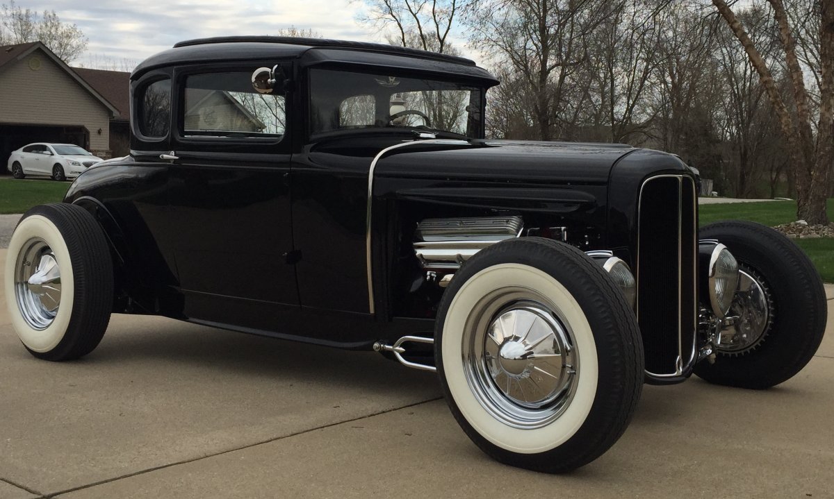

    @fiftyv8 there was a Model A Coupe that had a unique hinge system and I have a pic in the Homogenized thread of a Jalopy racer with a side opening hood...both of these are one piece hoods I will see if I can dig the Ole Jalopy up...and the coupe was that real nice black one in a thread recently with the wild headlights.
    The Black Coupe Hood post...below...dayuum he nailed it with this coupe check the thread out.
    https://www.jalopyjournal.com/forum/threads/just-another-black-model-a.1122429/#post-12742058

    I'm pretty sure this is a hand fabbed mechanism...
    Credit to Photographer, Owner @rsss396

  25. Started out with a template then had it roughly rolled at a local sheet metal works then finished it by hand tapatalk_1538293253798.jpeg 20180121_151828.jpeg
    Sent from my moto g(6) play using The H.A.M.B. mobile app
    6inarow, BigO, Jet96 and 4 others like this.

    Stogy and Blackjack, thankyou both for your pic's.
    Blackjack, that is the coolest hood finish I've seen before.
    I am interested in that lift up hinge setup on the 30 coupe.
    Time to do some figuring and take stock of my direction.

    You might want to PM @rsss396 and ask about how he achieved that...it really is pretty cool and actually plausibly period correct to boot...perhaps he could do a Tech Thread on it...nudge nudge...wink wink...;):D
    I haven't found the other vintage pic with the side opener yet...I wish there was an easier way to find posts in threads...
