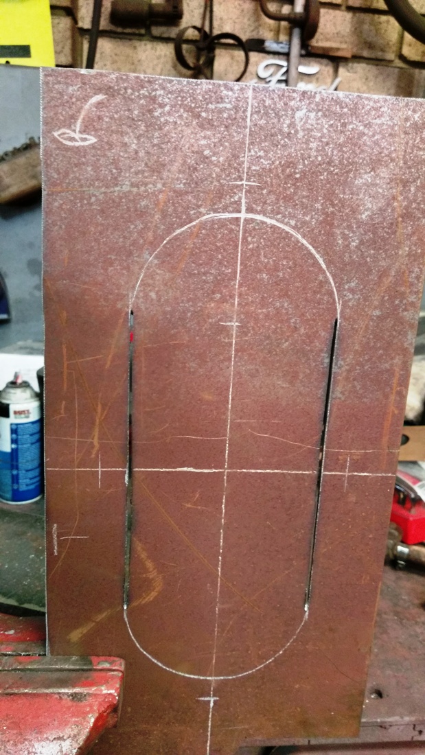

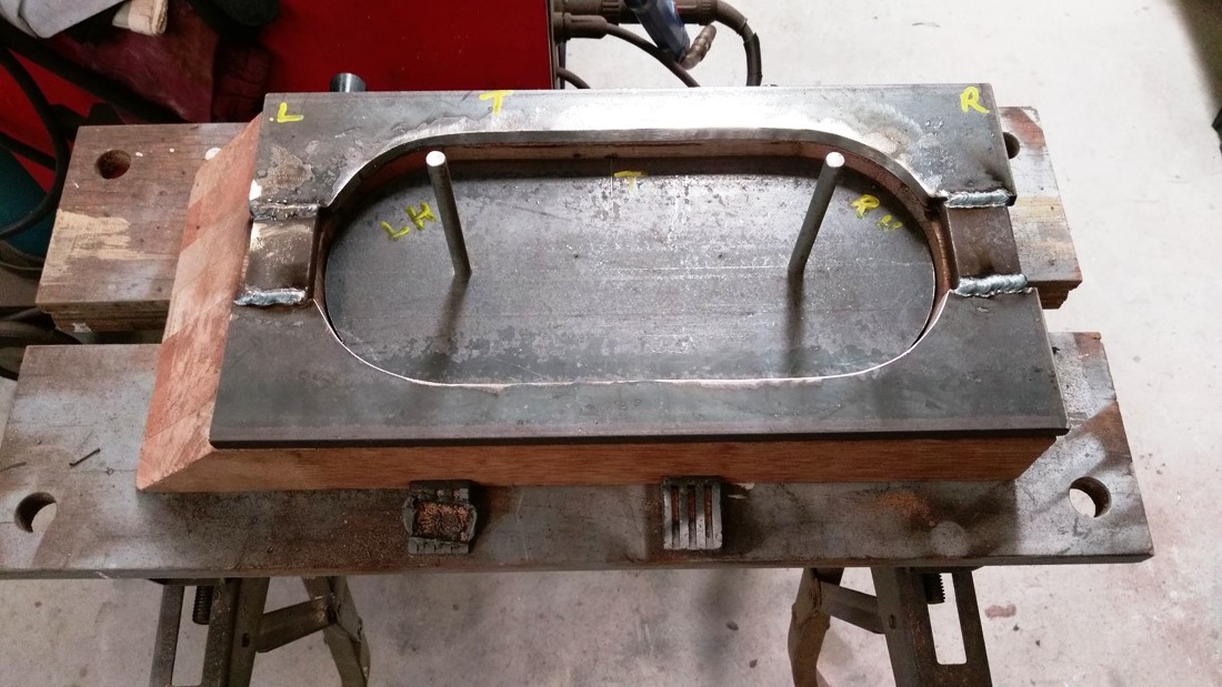

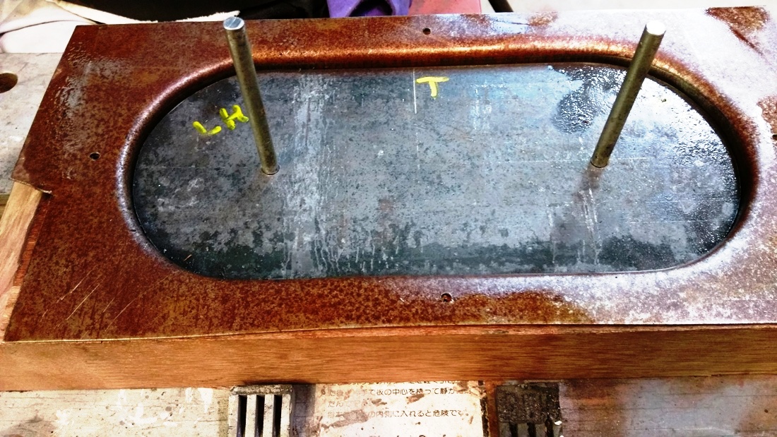

    Well, I have a little bit of progress to show.
    I am trying to make a pattern to be able to press the opening in the hood material for the air cleaners to protrude.
    Who knows how successful it will be, but I guess we wont know until I try it.
    I found an off cut of glued laminated beam which I figured might be made from hard wood timber.
    After my first attempt at using the router and hole saw on it, I can confirm it is really hard wood.
    This is a plus for the project as it will become the base for my pressing form.
    I used hole saw to remove some of the material and also to give me access to the under side of the pressing should the die and material get wedged.
    First I made a cardboard pattern of the cut out I was wanting and then scribed it onto the wood.
    I then determined how much smaller I would require the center pressing die and marked it out on a piece of 10mm thick steel plate and cut it out to shape as well as making sure it would fit inside the wooden opening with a consistent clearance of about 1mm all the way around, since my material I am told is just over 0.9mm.
    I have spent a lot of time refining the accuracy of the shape and edge clearance to get it consistent.
    Next I will put a quarter radius around the top edge of the wooded base.
    I am thinking 5mm radius.
    I am also going to need to find/make a holding down plate and possibly use some dowels to prevent slippage during pressing.
    I still HATE woodwork...
    kidcampbell71 and AndersF like this.

    RICHB, I hear you and you are probably right.
    I am being guided by a buddy of mine who has done numerous pressing, most of which have been successful.
    We did discuss your method and wondered since the opening was relatively small how pounding the lip would work.
    We also thought that we would do a test panel first up and not go straight for the whole hood.
    We also considered that my wooden base would still serve as a suitable buck for hammering should we discover the pressing was not successful.
    If I do go with your idea, I have a plan to put a slight curve in the top of my buck to replicate that of the hood if possible, just as an extra refinement.
    Today, I improved the clearance gap between the die and the base and also added a pair of alignment dowels.
    I still need to make a piece of plate the opposite shape to the die for holding down my material during pressing or hammering and add a small radius to the folding edge of my base/buck.
    kidcampbell71, AndersF and Stogy like this.

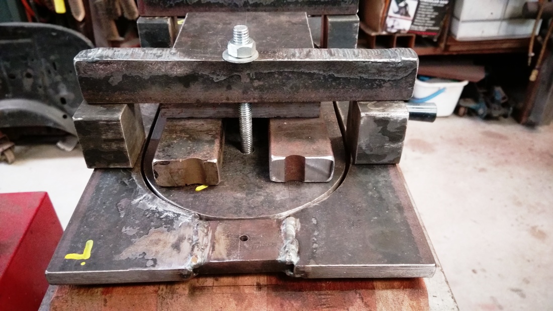

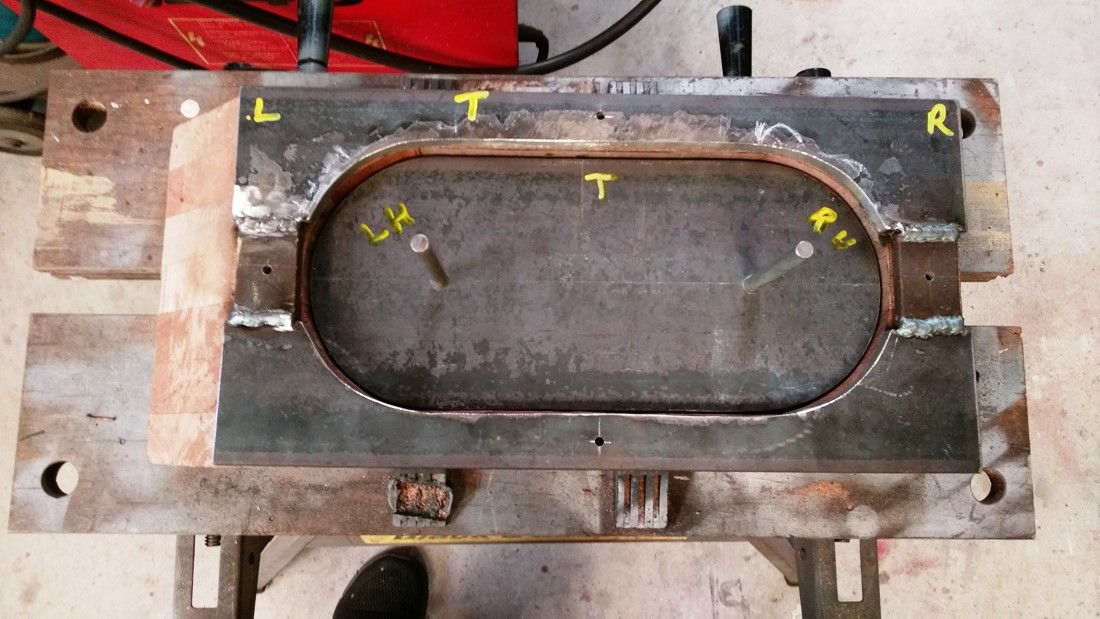

    A little more progress on the pattern press.
    I am getting real close to doing my first test piece pressing.

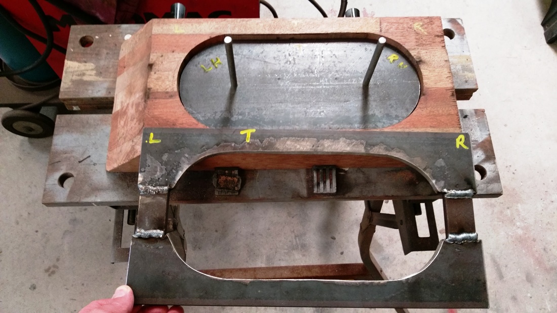

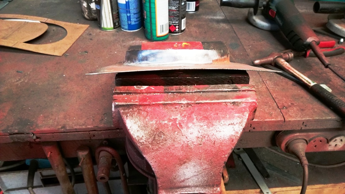

    I am not a religious man, but it would appear the Gods have been with me on this pressing exercise.
    I did a trial pressing to day and the pic's below tell the story.
    Needless to say I am pretty happy with the result.

    Thanks, yes it was nice to enjoy success on the first attempt.
    I have noted a couple of clearance issues during the process which I have cleaned up.
    However, like most things there is a down side.
    I take away a couple of observations that I am going to need to address;
    • firstly, my own press is too narrow to do the final pressing using the full piece of sheet metal that makes up the hood.
    • secondly, while it was quite easy to clamp down the test sheet to the wooden base, in reality clamping looks not to be as easy with a full sheet.
    • for the clamping issue, I am considering working out a way that I can flip upside down the whole box and dice and press from the opposite side, but even that is seeming tricky at best.
    • I know my pressing plate/die requires reinforcement as it is bending under load.
    • Plan B is to thread the tops of my two guide dowels and use them to bridge the die and hold down my clamping piece to secure the sheet metal during pressing.
    During the initial pressing process, as the die is pushed down, the edge of the sheet around the wooden base causes the sheet metal to want to lift and move, so I need to ensure that I can clamp the sheet securely, to help keep it flat and prevent slipping.
    On the test piece it did require 4 clamps to secure the material and I am wondering if the two dowels alone will be upto the task.
    I get the feeling I maybe doing a 2nd test pressing before heading off into the wilderness for the final full hood pressing.
    Might be time to contemplate the situation over a beer or two...

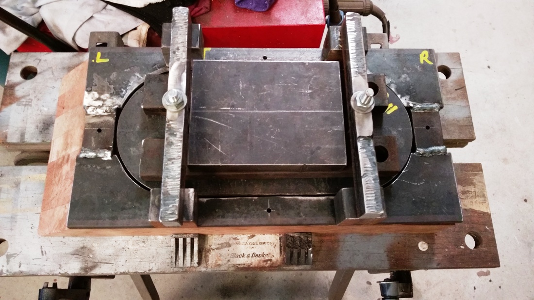

    After much fooling around I have worked out a way to hold down my work piece material in position while still being able to press the die.
    By modifying my guide dowels and bridging my die I can press down on the work piece quite easily.
    So that is another box ticket in readiness to do my final pressing.

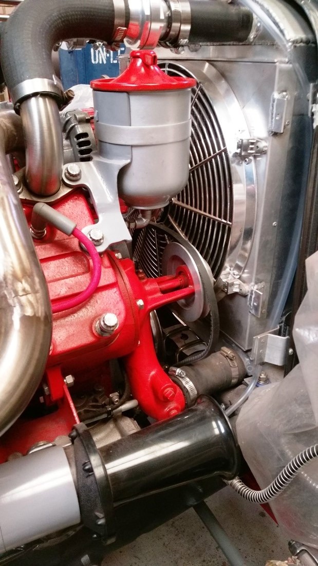

    I got a couple of big problems to deal with and should address them before finally making my hood.
    I got a radiator overflow cylinder and a remote byp*** oil filter both of which foul the edge line of my hood.
    I need to make a new bracket for the oil filter canister and move it in board about 3 inches and similarly with the overflow.
    Modifying stuff at this point in my build is annoying and painful, but this is the only way to get it done... IMAG1560.jpg

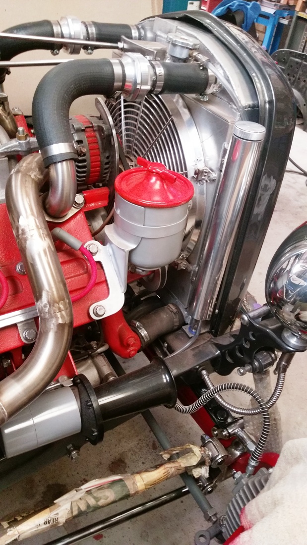

    Well, another box ticked with the oil canister relocated as required.
    It is even raised a little higher which might improve flow back to the crank case. IMAG1632.jpg IMAG1632.jpg

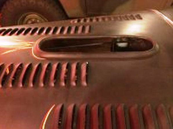

    I like the progress. I had this in my hood idea folder thought you might like it. Not sure if it one of the guys on the HAMB or just something I stole but I sure liked it.
    kidcampbell71, fiftyv8 and Stogy like this.

    Bandit Billy, boy that hood work is something to behold.
    I like it a lot.
    I don't have access to any fancy equipment and constantly making one off tools to do stuff kinder makes me wonder if I will ever get my project over the line.
    I got to say, after seeing that center pressing, I may need to take a 2nd look at what I have done and see if I could tune it up just a little.

    And that pic is in bare steel! I am amazed by some of the metal work geniuses out there.

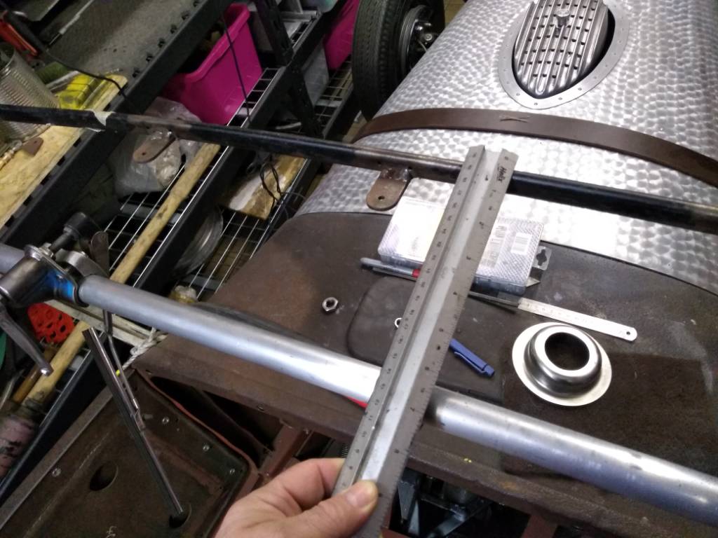

    Folks, before I reach out to the whole Forum, I was wondering if anybody viewing this thread has used and owned a pair of hood hinges that I am considering using.
    I've looked at side ways and forward tilting, but I am convinced in my case the usual front lifting hood will work the best for me and my particular cir***stances.
    I have search a lot of the internet and come up with the design I like, although the ones offered for sale are too large for my situation.
    My intention is to try and find somebody who could give me some measurements so I can scale down from there and make my own smaller version to suit my engine bay.
    Any help would be appreciated.
    So far the best pic's I have are as follows and one came with a tape laid along side of the hinge, yet after scaling it I still can not quite get the right dimensions to work out mathematically.
    I will be mounting my bracket vertical to the firewall.
    Many thanks, Russ.
