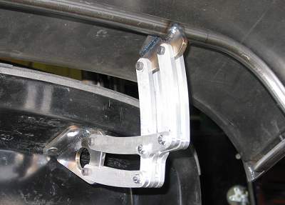

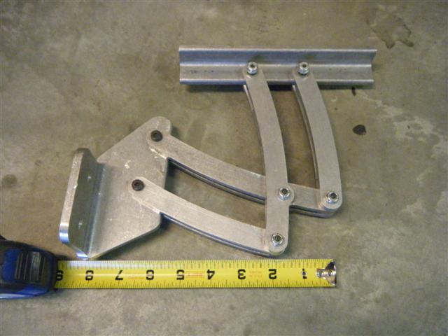

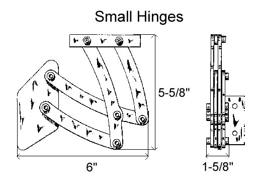

    Further searching and I have come up with this modified version of a C10 hinge that looks close to what I can start with.
    Probably a little simpler to replicate also.
    Although access to measurements which I don't have would make life much easier...

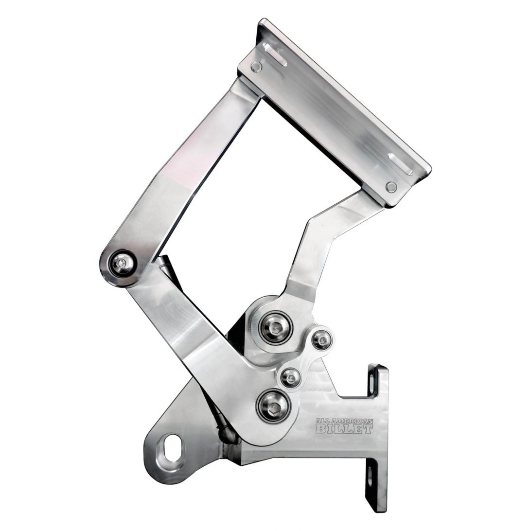

  5. Stogy
    Joined: Feb 10, 2007
    Posts: 27,373
    Stogy
    That is literally Billet...it says so and looks it mind you it's your call. I thought the more simple one you showed looked fairly basic and p***able as vintage and easy to make.
    The Bill one looks to have a built in lock...I may be wrong as I'm ***...uming...:D

    Stogy, I am not buying one, just looking for the principle of operation.
    These items are way out of my price range and more suited to top end street rodders and muscle car kind of guys I'd say.

    Any reason you can’t print this off and trace it into metal? Need to be bigger/smaller use a copy machine and try again.
    Could even make them from poster board or Masonite to test the arch

    Sadly, I've tried it with the drawing you refer by scaling as well as the other hinge lined up against the tape measure and in each case when I work my way thru the maths to double check my first arrived measurement, the check measurement is different.
    On occasions not by much, but still enough to be unsure which might be correct.
    However, with the C10 hinge (1960 to 72 from memory), there must be somebody out there who owns one of these who is willing to throw a few decent number at me.
    I have made a cardboard mock up of the C10 roughly and I can see it working, but actual dimensions would be awesome to obtain.
    I've even made a plywood firewall bracket that is clamped on and is a great base for testing once I am right with arm lengths.
    If I don't get these measurements, I will move on to fabricating a complete under frame for my hood and work it thru that way.

    I think your over thinking it. Make one that exact size it prints out. I mean trace it line for line.
    Make it out of test material
    If it binds move the hole around until it’s correct. Correct meaning the hinge works, who gives a **** if it’s correct to the originally referenced part
    And then don’t **** around with math just trace the new hole locations and use a copy machine to make it bigger until you get the one that works.
    Just be hands on and you’ll be done in no time

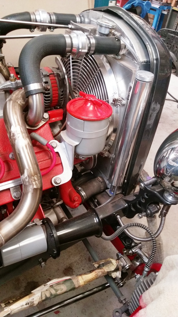

    Regarding your radiator overflow: I had the same shiny tank and same location as in your pics. I ended up mounting it to the block on the opposite side of the car. Longer hose needed, but solved the problem. On my coupe I made a tank out of 2 inch aluminum pipe which allowed me to shorten it quite a bit and retain the same volume. You have lots of options.
    Hope it helps.

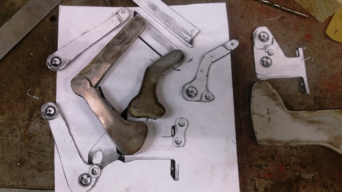

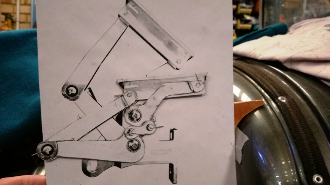

    What I did is take a copy of what I found on the internet and added it to my pic's folder, then resized it to about 1.2 times so the arm lengths are about what will work for my space.
    I then printed at the larger size, cut out all the moving components and glued them to some old cardboard.
    Once dry, I cut them out and took a 2nd copy of my pic and laid the cut outs over the pic and pinned the centers using staples and thumb tacks.
    I then took it out to my shop and held it in the rough location and took it thru its movement range and it seems to work pretty good.

    Well folks, I am back I think.
    As long as the internet issues of the recent past are behind me I shall start making further progress.
    Not a lot to offer up right now, however I had determined since receiving mu Chicago bolt/nuts in the mail that head size was going to be a slight problem with one pivot point.
    That is the bracket to lower arm pivot point.
    I made an executive decision to relocate that hole position by a small amount as you will see in my attached pic, which seems to have solved the head clearance without affecting the movement wrong way that I can tell.
    Stogy, Okie Pete and Tim like this.

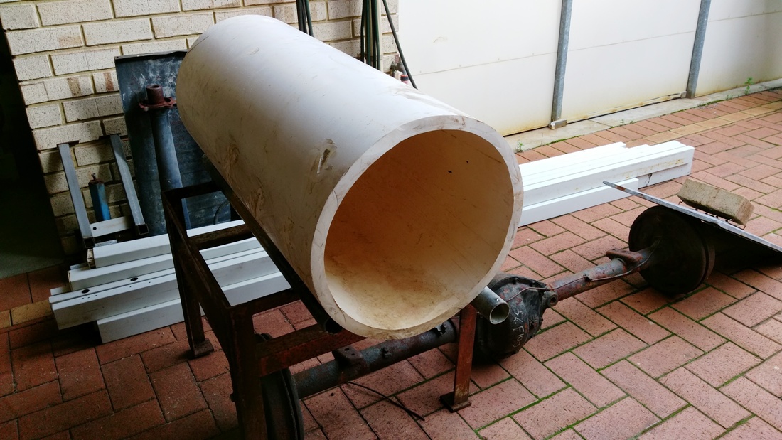

    I got my sheet metal cut generally to shape and now realise that I will need to get a couple of round objects mounted somehow so as to be able to roll the curves that I require.
    I have a gas bottle which is about 9 inches in diameter and have recently acquired a piece of large diameter (16") thick wall (1") plastic pipe plus two drive shafts (3 1/2" & 4" diameter).
    I am hoping with these choices I will be able to obtain the shapes that I require.

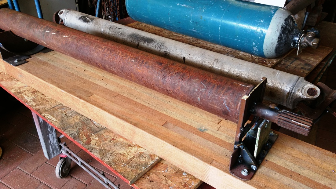

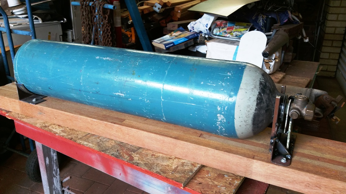

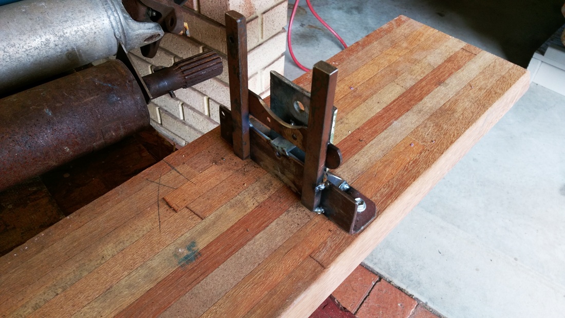

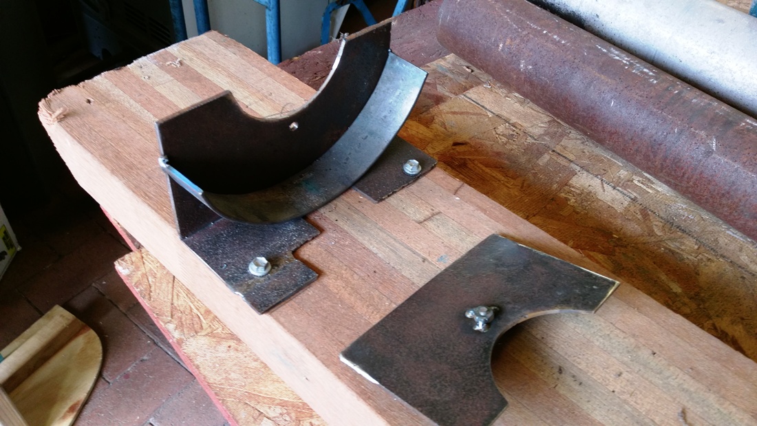

    I continue to cover my bases by trying to have a level of organisation as I proceed.
    Since I don't have access to sheet metal rolls, I have been ***embling several round items that may lend themselves to my shaping process.
    As round stuff can be a little tricky to work with unless tied down, I embarked on another side project of making a base to mount my round stuff so I can have two hands free to work the sheet metal.
    I just happened to have another piece of laminated wooden beam that was long enough to accommodate all my round items with the exception of my large diameter plastic pipe that I mentioned previously.
    I proceeded to make a gizmo that would support all my round pieces when required and allow me to quickly remove one and install another as preferred at the time.
    I made two brackets, at one end my bracket is just really a cradle with curves to suit what ever round item I am using, while at the 2nd end, my bracket is designed to support the other end of my item, plus retain it from sliding or rotating, which appears I have managed to achieve.
    Not rocket science, just stuff made from s****...

    A little more progress to report.
    I have started forming the curves, the shape formed quickly to a certain point and then it got tricky.
    I had to walk away rather than maybe push things to a point were I may regret my enthusiasm.
    I am thinking I need another diameter size to aid my progress further.
    For now both the gas bottle and Ranger drive shaft have proven to be most helpful...
    It is mostly the radiator end that is challenging me right now.

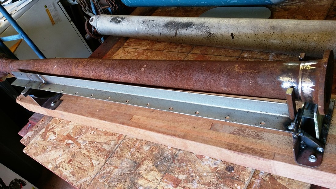

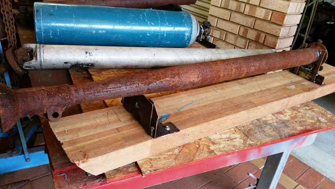

    I have added a Model A Ford torque tube to my range of round items for forming my hood.
    After all, I got to be a little Traditional on here.
    The diameter size range I have to date is all good, but I need something just that much smaller in diameter and at 2 7/8" this will be very helpful to finalising my radiator end curves.
    In the meantime, I have also made a attachable straight edge that I can clamp with vice grips to each end of my drive shaft support gizmo's.
    It will work best with my Ranger and Jaguar drive shafts.
    I have used it with the Ranger drive shaft and was able to slip the side edges of my hood in between the straight edge and drive shaft and have more even pressure when pulling the hood around the drive shaft, which allowed me to get my curve very close to the side edge of the sheet and also to remove the bowing that had occurred during earlier rolling and shaping.
    I did however, manage to put a very slight kink line in my hood (with this straight edge) which I think I can remove later without too much trouble.
