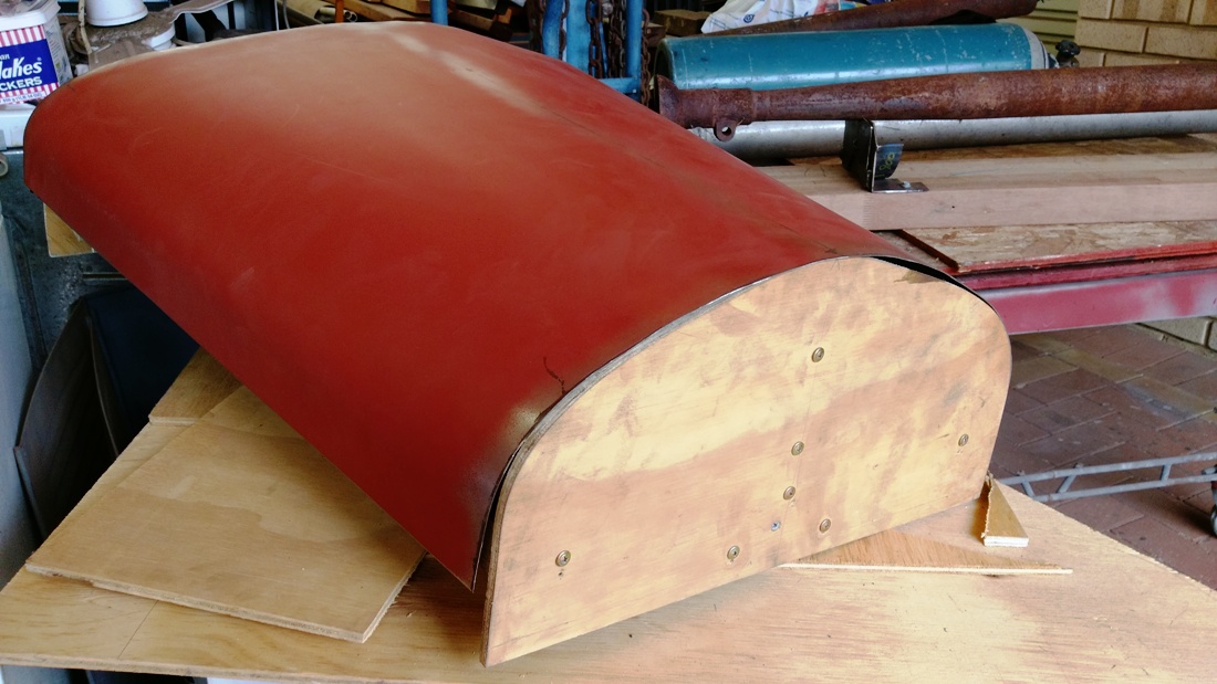

    I have a plan to do another video of the engine running in the frame and a greater exposure of the body etc.
    Showing off the hood at that time will easily fit into this video.
    I've been doing some small refinements, gradual rust removal and metal finishing of the inner panel.
    I will need to clean some surfaces but keep them paint free ready for spot welding the two panels together.
    It is going to require some bondo, but I'd like to minimise using bondo where possible.

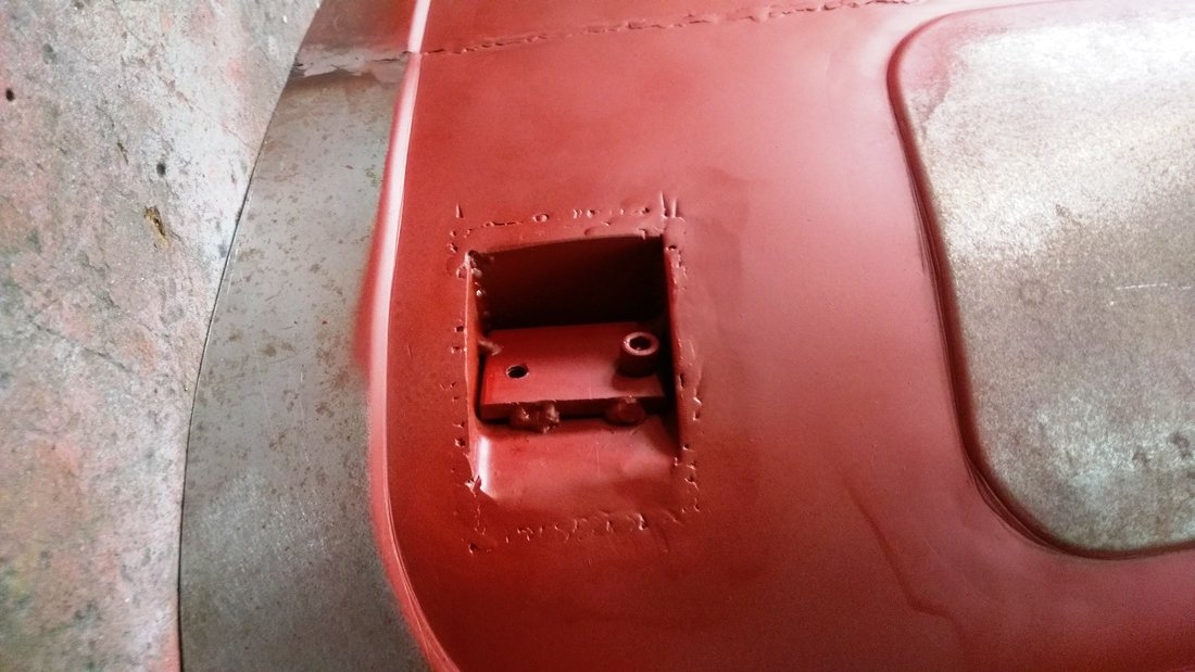

    The release is just a reach under hand lever and same with the safety catch.
    I modified the VW release slightly to make it more user friendly.
    Originally in a VW it had a cable but I could not see the point since it is only a half hood and I needed the release latch body to be as slender as possible to fit in its position.

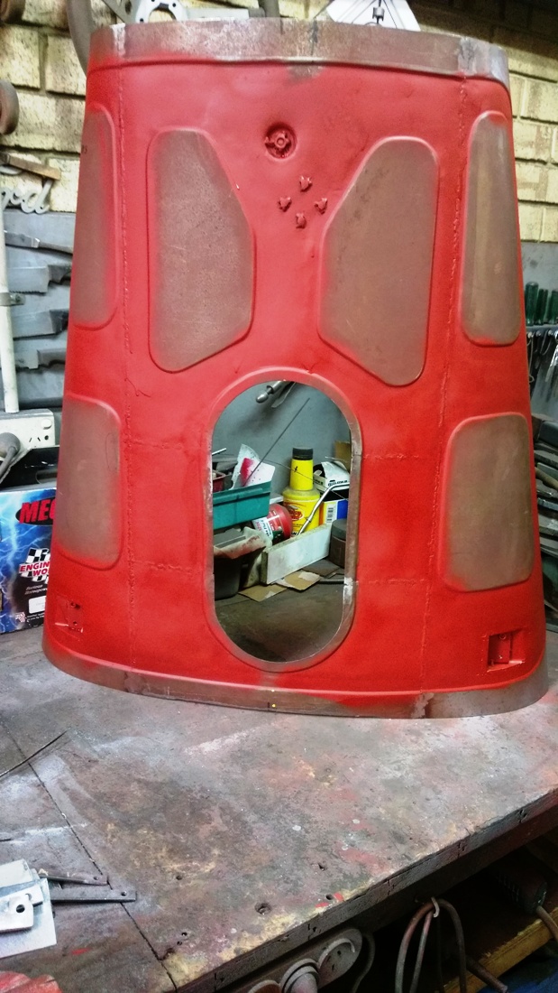

    I think that I have become a little lazy in my old age during this current lock down.
    Compared to other threads I guess this ain't that exciting to follow, but I am happy to say it is almost done now.
    I have spent quite a bit of time fooling around with the sheet metal portion of my hood project with little to show for it.
    I have removed all the surface rust from both sides of the inner skin and spent much time test fitting the inner and outer skins to a point where I am happy with the fit. I have tried to ensure that one skin is not stressing the other and the fit is more naturally compatible.
    I have gone over the inner and tried to remove or should I say reduce the number of highs and lows in the sheet metal.
    Since the outer face of the inner sheet is not seen, I have basically ensured it is flat or with only lows that I can fill with body filler.
    Body filler is a necessary evil IMHO and I always aim to use the minimal amount.
    The outer surface of the inner skin has been primed and painted roughly with some old spray can paint I had no further use for and decided to use it up as a rust preventative.
    The inner face of the inner skin is coming along nicely, considering my skill level and next week I hope to be ready to purchase some spray on high fill primer that will hopefully remove most of the minor scores and marks in preparation for further work later.
    Next steps will be to cut the air cleaner opening in the outer skin and press the lip into it and the do some more body filler work in readiness for the mating of the two skins to make the hood.
    My intention is to spot weld the edges of the two skins together.

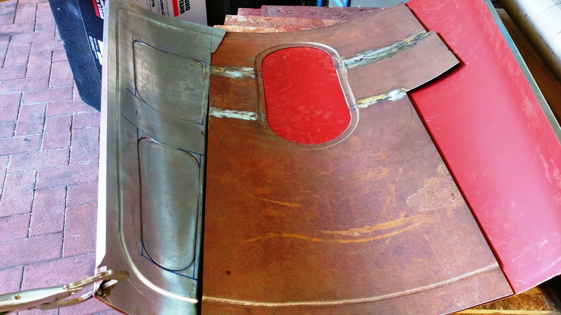

    Progress has been slow, I have focused on other stuff as I am in the process of losing a finger nail due to mis-adventure in my shop.
    I also had to do some slight re-work to the outer on one side to improve things.

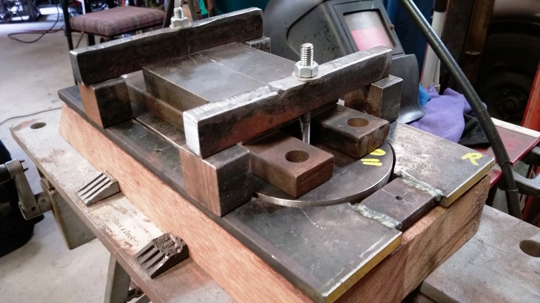

    Recently I have cut out the twin carb opening in the outer panel and prepared it and installed this panel into my die ready for pressing.
    I am already to press it now, but remain at the mercy of the guy who owns the press that has the throat capacity to accept my job.
    Turns out he is really busy right now being one of the rare business's that has seemingly benefitted form the Covid19 out break.
    6inarow, hfh, Stogy and 1 other person like this.
  18. fiftyv8
    Joined: Mar 11, 2007
    Posts: 5,401
    fiftyv8
    from CO & WA

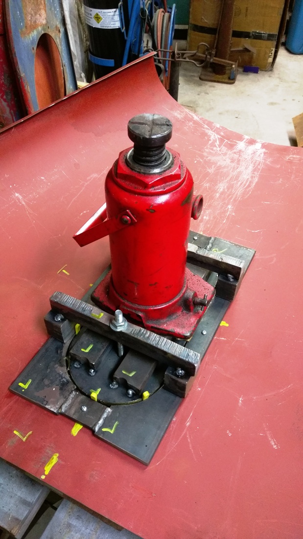

    Well, I decided I could not wait for access to my buddies press.
    I found a brick garage door opening with a high gable over head and a steel lintel supporting it all and it had a good concrete floor.
    I took a bottle jack and cut a length of 2 inch pipe, capped the ends, placed the jack on my die setup, levelled it up and jacked away.
    I watched as I raised the wall while jacking.
    No just joking, the die pressed nice and slowly.
    There was a fair weight of bricks and roof above.
    It got a little off square early, but a big hammer sorted that out and the pressing was done in a couple of minutes.
    I am happy with the result and so now will continue on as planned.

    Talk about unlucky, I have some bad news with regards to my hood project progress.
    My pressing has turned into a disaster.
    During the setting up in the die, since the cut out is not exactly central, I have some how transposed the measurement to the opposite hand and have pressed in the wrong area as such.
    Sometimes I was working on the outer side of my hood and other times on the underside...
    The opening still clears the air cleaners but the hole does not sit evenly clear around the air cleaner heads.

    I've decided to cut out the area of the pressing section, then use my test pressing as a weld in panel.
    I am confident that it will be the easiest solution as long as I can manage the heat and warping.

    Well, I cut the offending piece out and intend to weld in its place the test pressing I did earlier.
    That should work out OK.
    My main concern is the outer skin is pretty thin material and so I will need to take my time and keep it cool.
    Never thought that I'd have a use for that test piece and now here I am using it... IMAG2540.jpg IMAG2541.jpg
    GordonC and AndersF like this.
