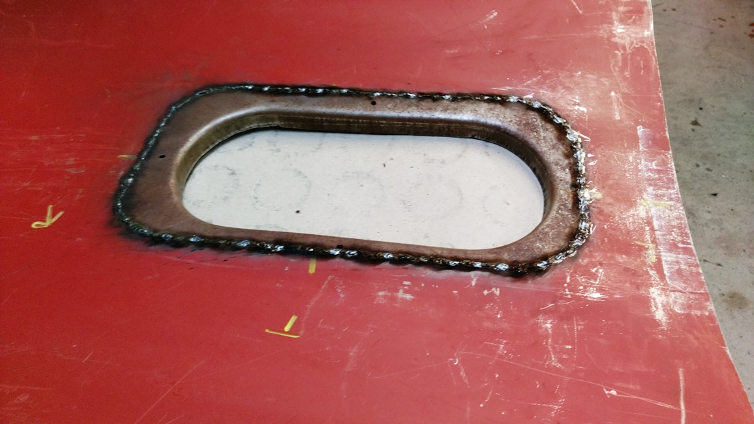

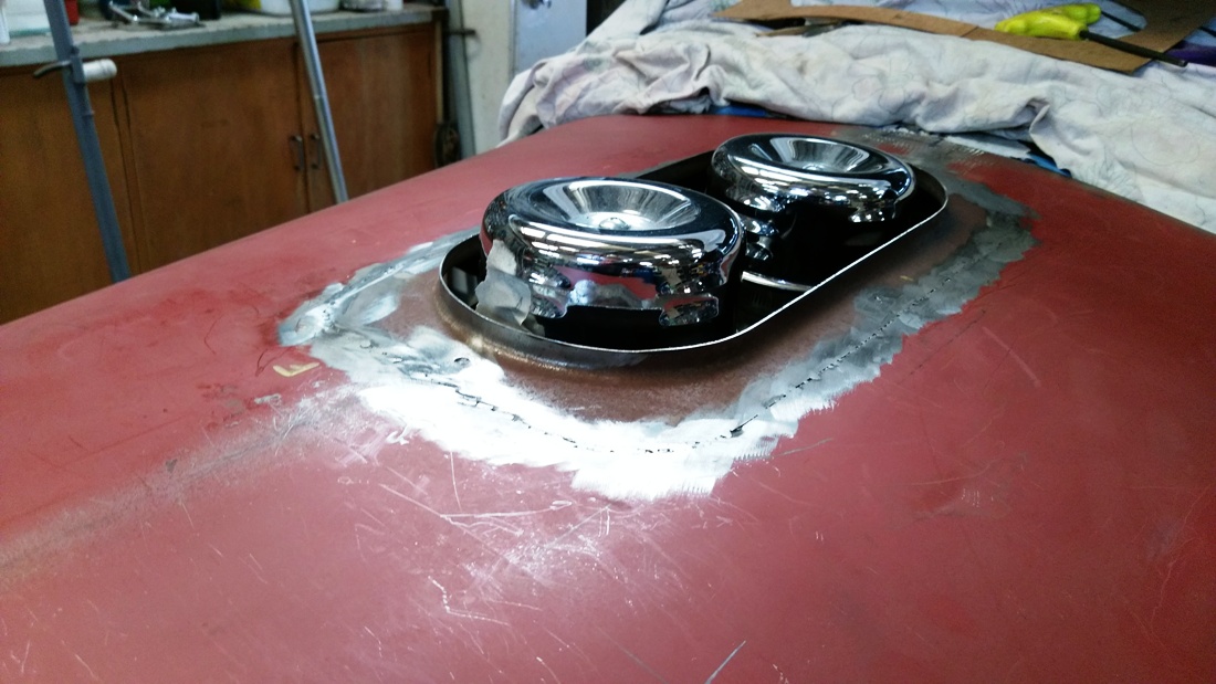

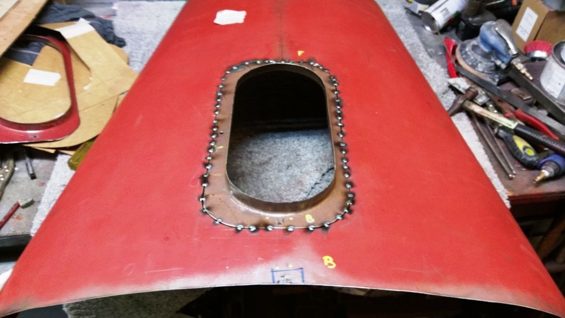

    As usual, progress has been slow but in the right direction.
    I got the alternative piece welded in.
    It went pretty well, but did end up with a slight distortion.
    I decided to have a go at panelling it out and was very successful to a point.
    Once I had satisfied myself that it was out of my pay grade I put two small cuts and welded the gaps and it pulled up just right.

    A lot of extra work but looks like you have done a good job in keeping the shape whilst welding so much better than starting again
