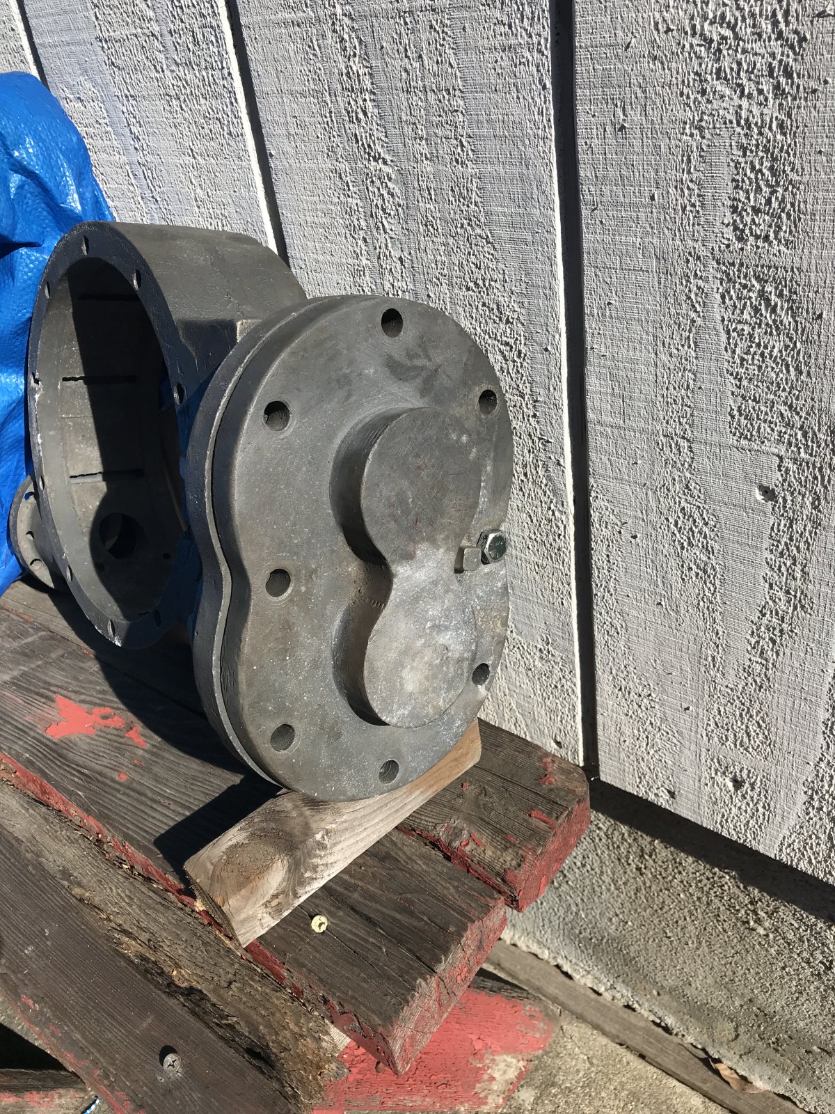

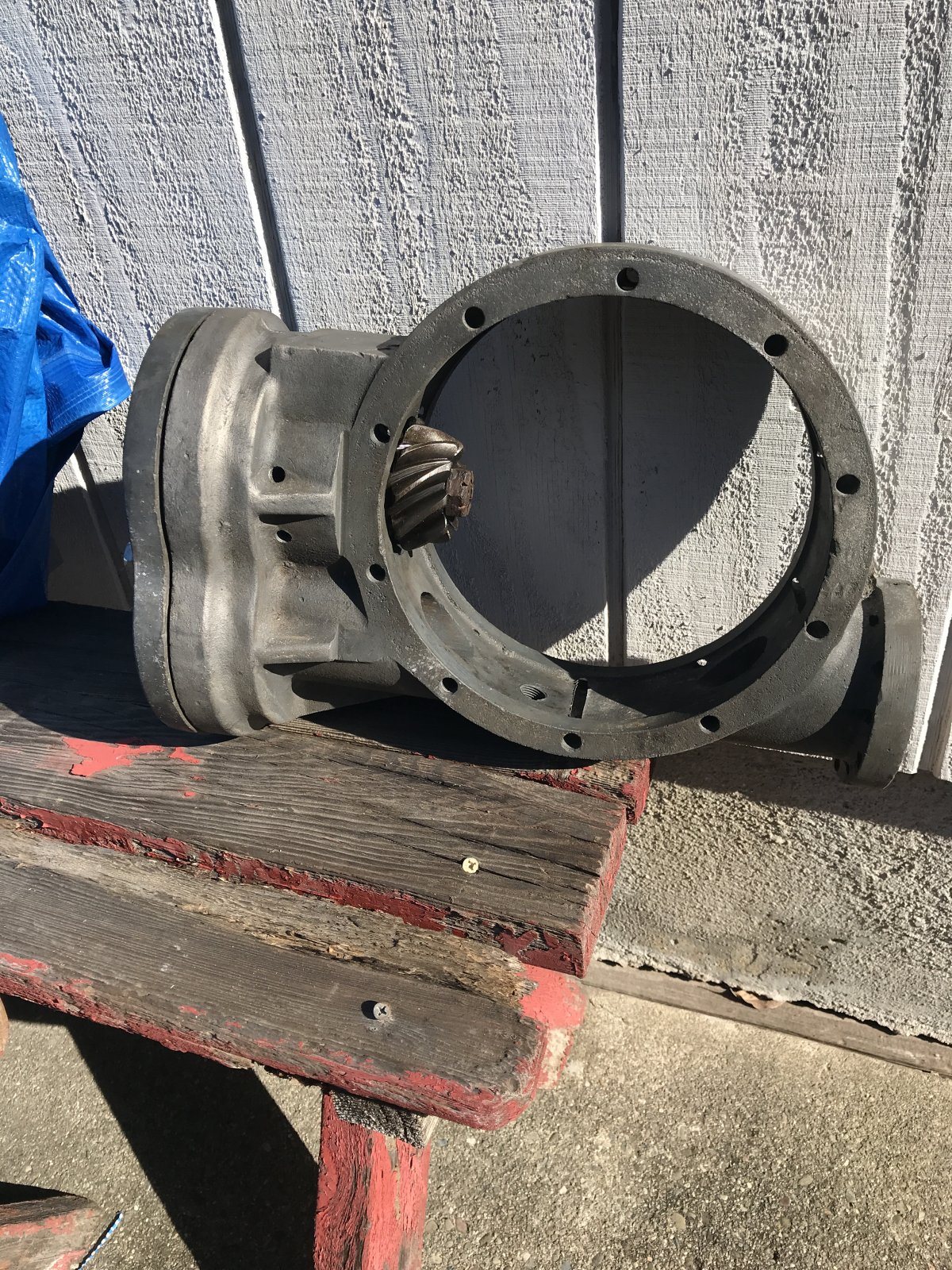

    I would appreciate help identifying this Model A no name QuickChange ? It's uses the same bearing as a Halibrand V8 QuickChange
    Thanks, Brian

    These are all the parts and numbers I got with my Halibrand 101.I sold it and never put together, so you might want verify the numbers.Hot Rod Works might be able to help you too! Hotrod Works Lower Shaft # 1271
    Hotrod Works Pinon Shaft #1270
    Speedway Rear Cover #4152936102
    Speedway Rear Cover Bearings #912b6304
    Speedway Pinon Bearing #912B6307ZZ
    Speedway Lower Shaft Bearing #9126206SZZ
    Speedway Lower Shaft Bearing #912B6306
    Speedway Front Seal #912S15522
    Speedway Spacer Kit #912B6304 and a couple of misc bearings.

    That looks about right. Those numbers correspond with last 3 digits of the bearings from Speedway I got with my 101 quickchange. Hotrod Works Lower Shaft # 1271
