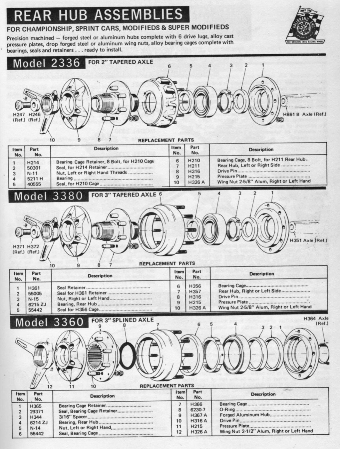

    The live axle has what are called bird cages that hold the outer wheel bearings and mounting points for suspension. These cages could hold the radius rods and the "A" spring mounts.

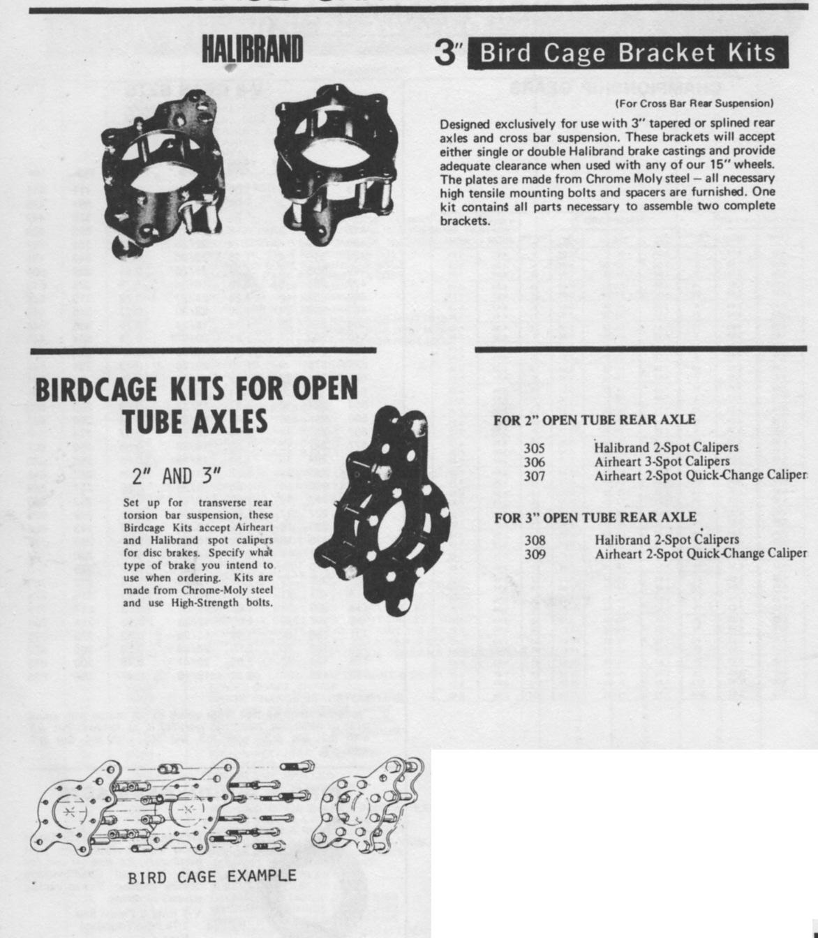

    Here's some stuff you can peruse while waiting on your catalog.
      514.9 KB
      194
      291.3 KB
      176
      166.3 KB
      152

    I'm sure you have figured it out by now. But just in case you haven't a live rear axle as used in sprint cars uses a bird cage with bearigs to hold axle at outer ends. The birdcage has pickup points for radius rods and torsion arms or coil suspension. also typically a jacobs ladder om right side to locate axle side to side. The problem with Bird cages is lubricating the bearings. Routine maintainance on a sprint car is after each night of racing take apart the birdcage bearings and clean and pack. Not real user friendly on a street rod. good luck.
