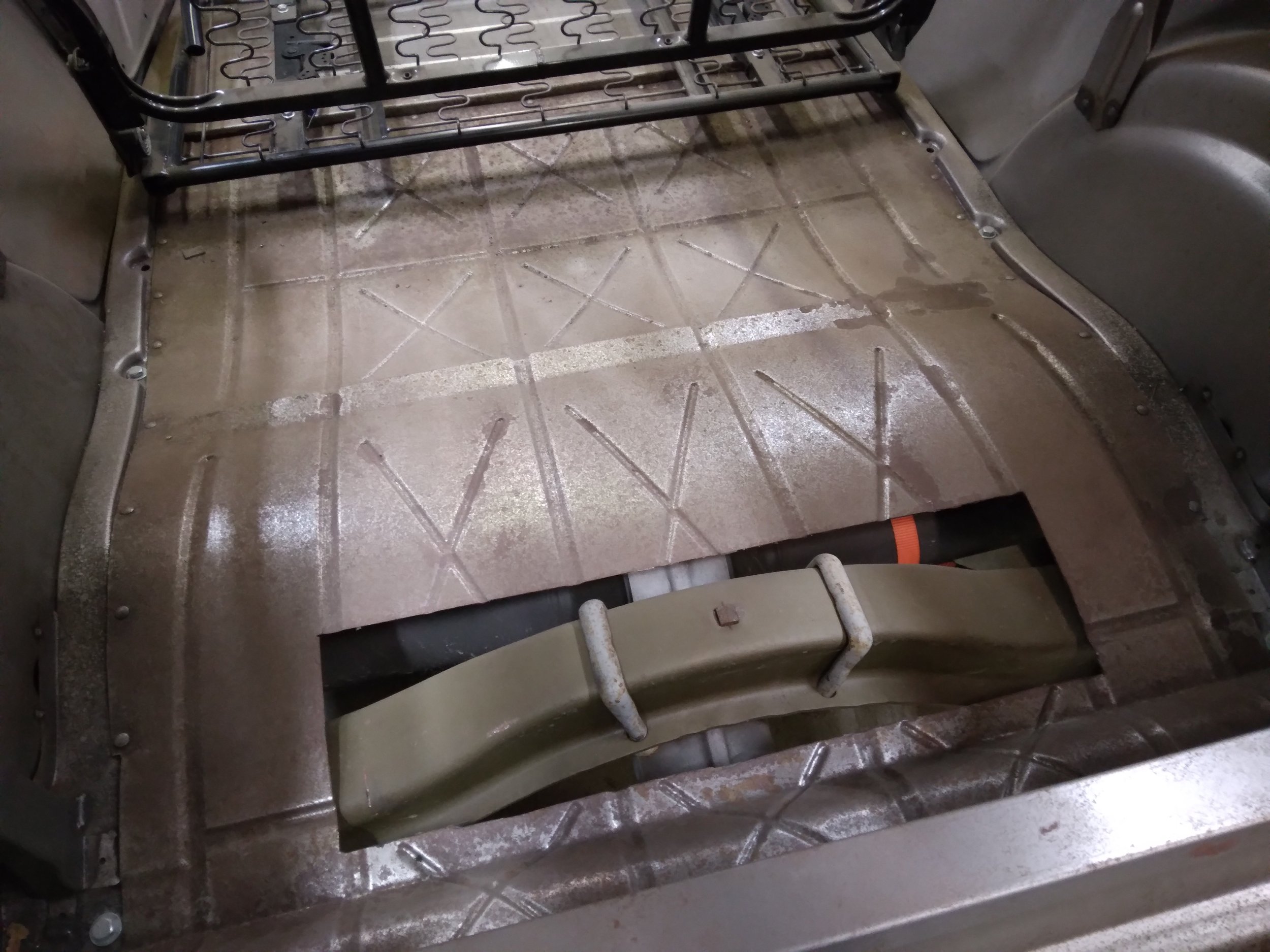

  8. hotrodA
    Joined: Sep 12, 2002
    Posts: 7,509
    hotrodA
    As @swifty says, the A rear crossmember will require a good size slot in your trunk floor for the arch to protrude through. There used to be a stamped repro hump for Model A sedans that could be used to cover it all up.
    It doesn’t necessarily need to be this big, but you get the idea.
    swifty, HemiDeuce and 51 mercules like this.
  9. swifty
    Joined: Dec 25, 2005
    Posts: 2,632
    swifty
    @hotrodA pic shows it perfectly then in my case with the larger Champ QC I have another raised section nearly as wide as those U-bolts heading forward and tapering down to meet the floor

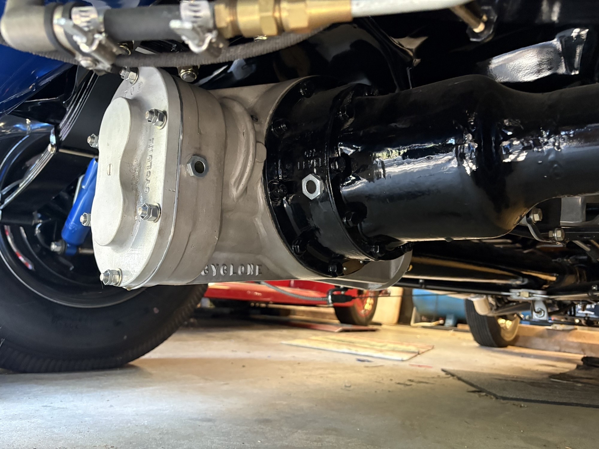

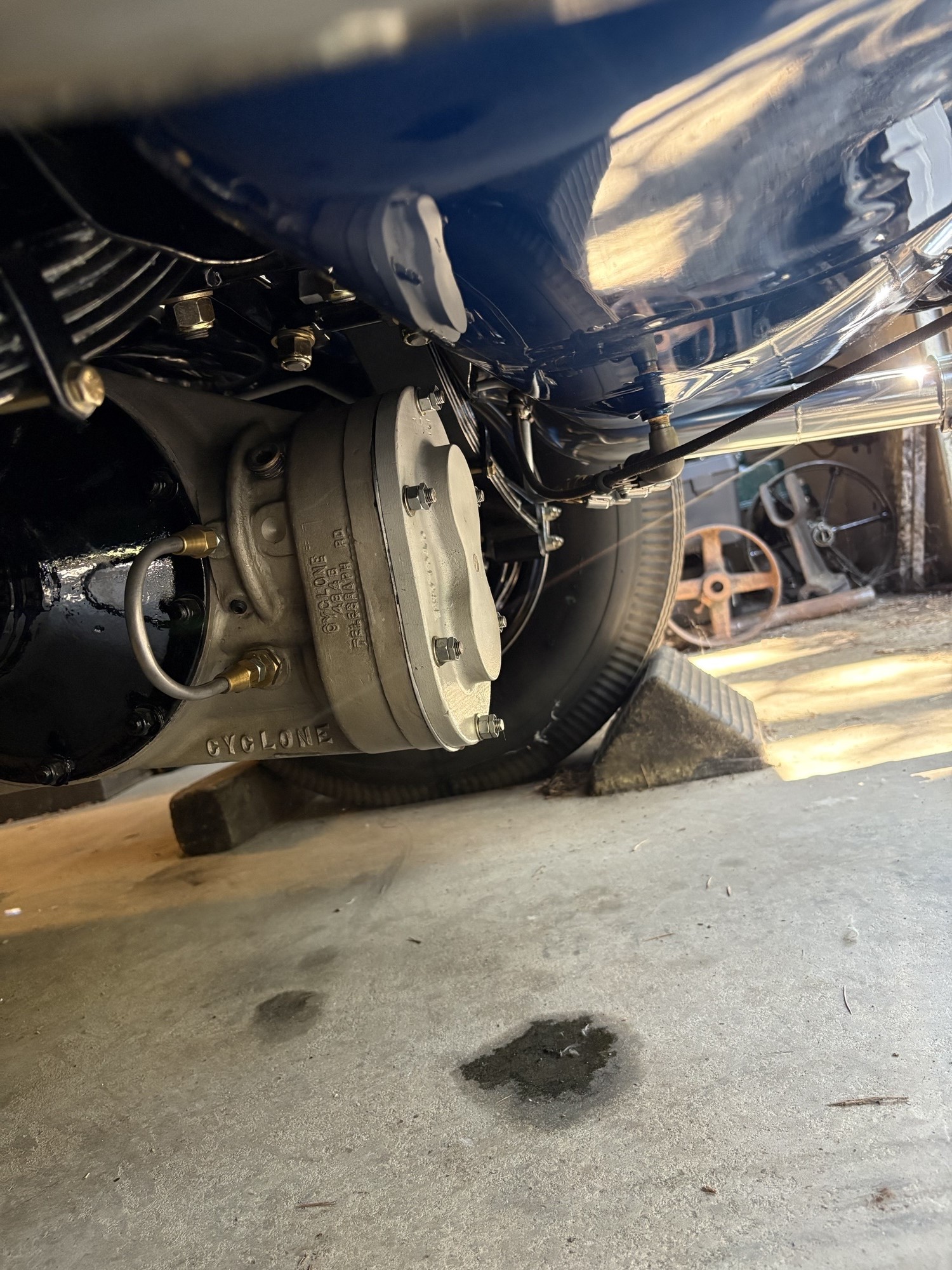

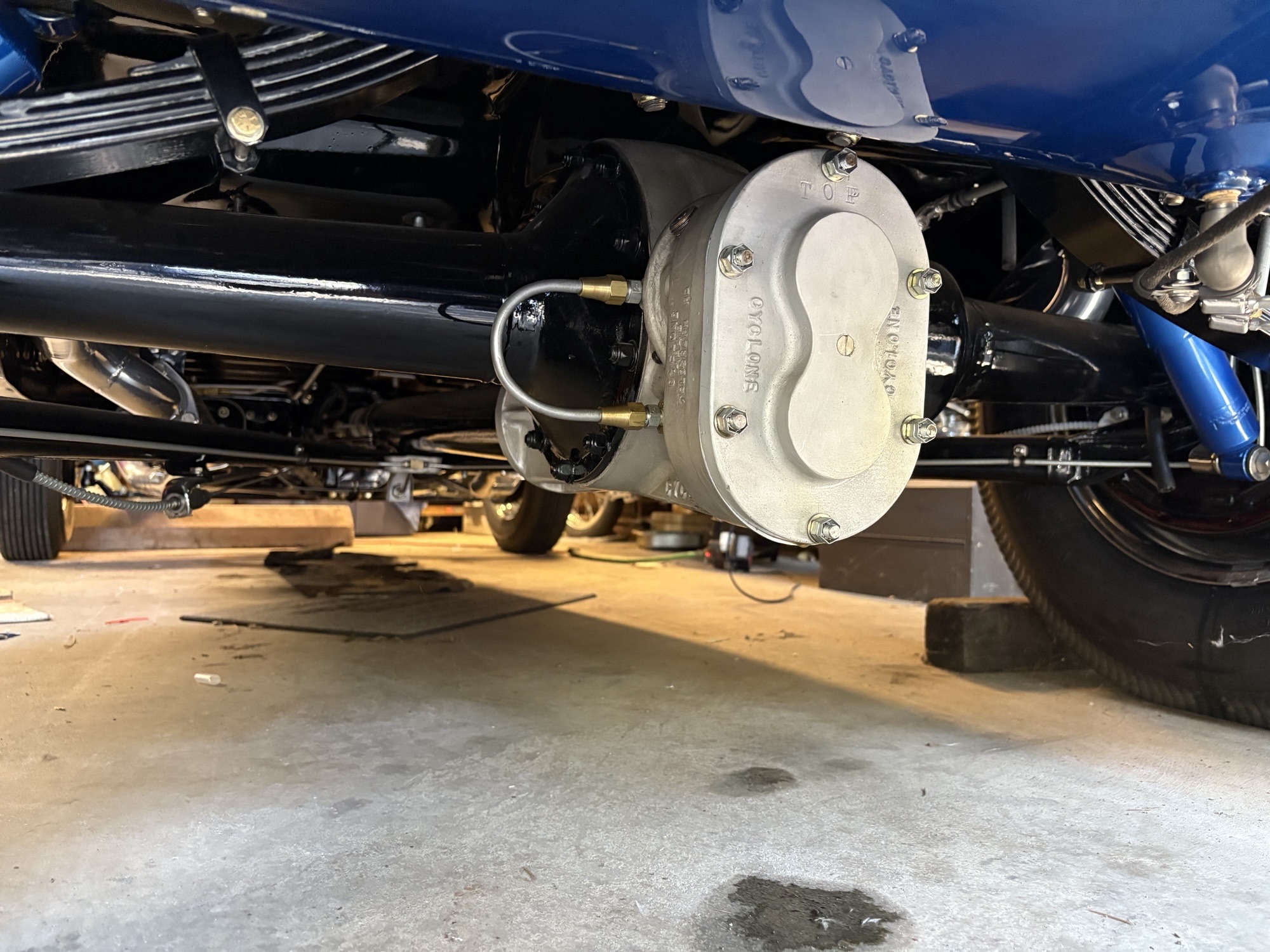

  21. $um Fun
    Joined: Dec 13, 2008
    Posts: 683
    $um Fun
    from Nor Cal
    Here you go, this is the bigger Cyclone quick change with a Colombia mated to it. The floor and the gas tank are not cut and the rear of the frame is not extended
    Hot Rod Ron likes this.
  22. Very cool. I see that my guess was right, as the gas tank is positioned right up against the spreader bar, and that style of quick change appears to be shorter than a Halibrand 201. Looks like a really nice hot rod.
  23. alchemy
    Joined: Sep 27, 2002
    Posts: 23,020
    alchemy
    The spreader bar has been moved rearward also. See the bar is centered on the rear bolt.
