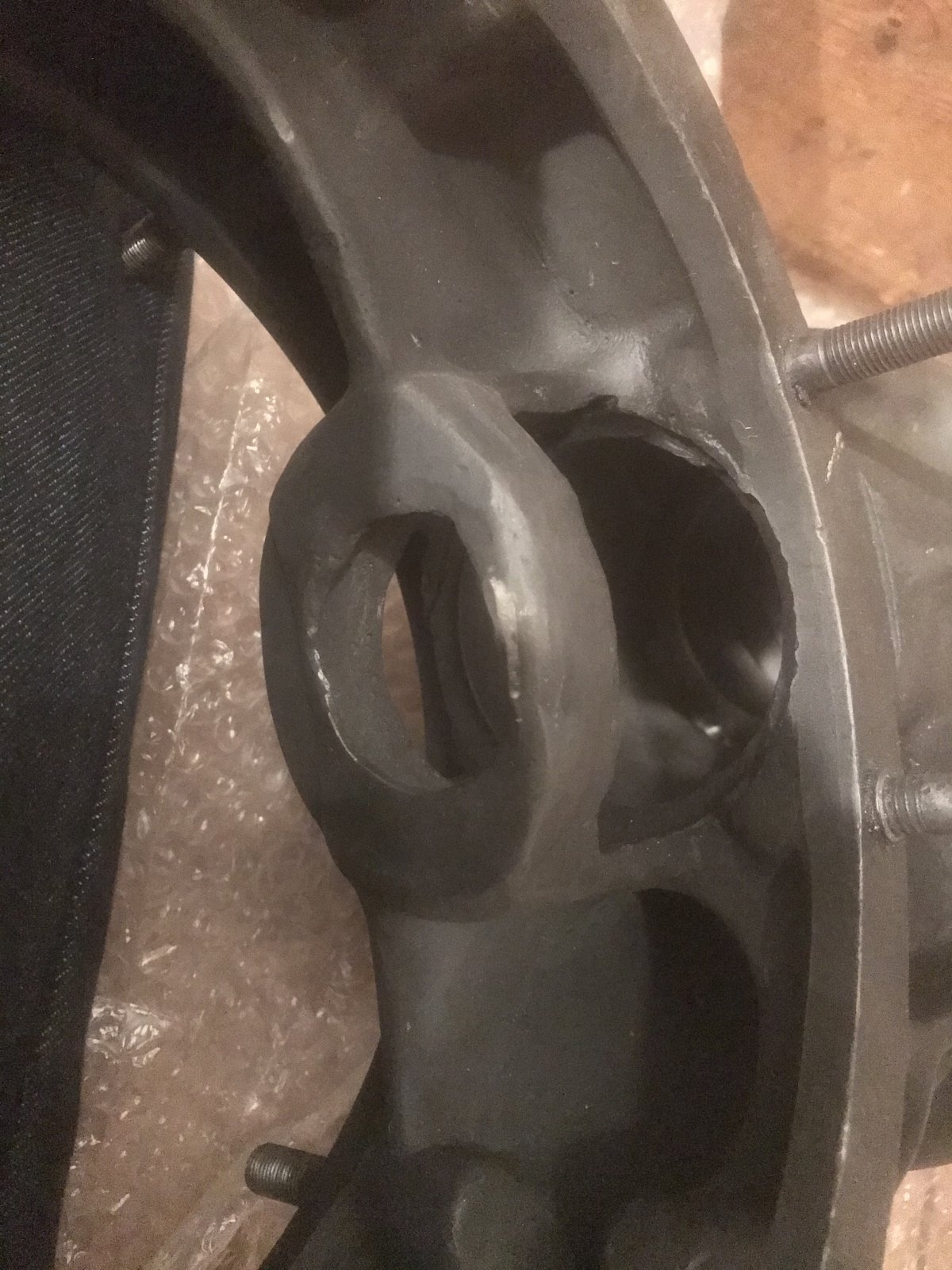

    I picked this 201 halibrand centre last week for $100, the guy I picked it up from said it might be repairable but likely just for a wall hanger. its missing the pinion support bearing area. Now it looks like it has been sanded to be this way not like it was break and then removed. Was this done on purpose or is it actually needing lots of repair? I’ve seen the new winters centres and they don’t have the support bearing......

  2. Looks like it was broken at one time and somebody just cleaned up the aftermath

    The earlier 101 Midget version for Model A ring and pinion did not have the support, as you may know.
    The tendency for the pinion gear to climb up the ring gear instead of turning it would lead to the destruction of the case.
    This lead to the improvement of the support being added to the 201 version. They still broke.
    Probably a wall hanger at this point.

    That is an early 201,Notice the cast in square block at the rear on the side,Early ones had that. Maybe a tooling spot for holding when machining. My 201 had been repaired years ago and I have not had any trouble with the pinion support. Mind you I have a 221 Flathead so not much strain.

    That can be saved. Forget the nose bearing. Converting to double cup tapered roller bearing is HIGHLY recommended.
    Building a Quickchange from an empty case is EXPENSIVE. Parts alone could be $2K.

    Yes, the double cup bearing set up will work in your housing. It has nothing to do with the nose support bearing. It is just a better way to hold the pinion shaft.
    Any competent welder can weld up the nose bearing support. The problem is getting the bearing bore on line and back to the correct size. Almost all of the welded cases I have seen have recracked. This is because no one wants to weld the inside of the bearing bore and get it remachined.
    If you go to the trouble of fixing it right, replace the nose ball bearing with a roller bearing.
    With the double cup Timken bearing, you can leave the nose bearing out in limited torque applications.

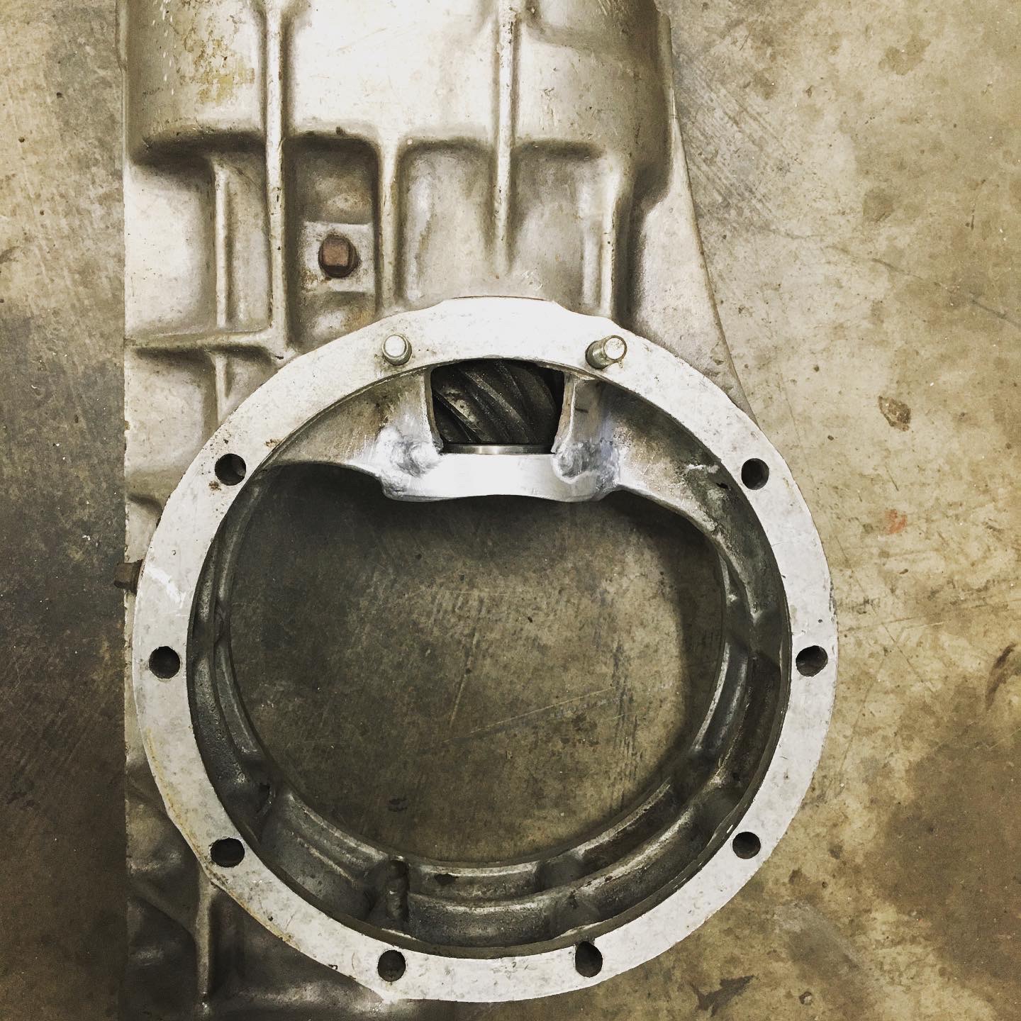

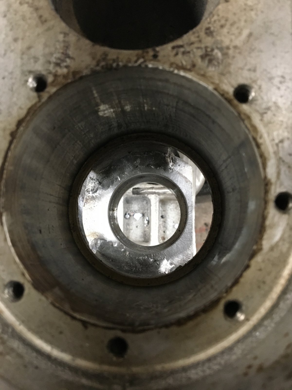

    B0072B08-906E-4C02-BFEC-CE1964F7B08C.jpeg 2B408378-229A-4D10-9BF1-F14B8E640718.jpeg FBDBCD2C-B31C-428E-A03C-9DD90497F617.jpeg 58D6CF24-1379-4258-AC6D-EC532AD38FA7.jpeg 2A5FFB15-FB0A-47CE-B3F7-42C3A3A052CE.jpeg 940AD28C-04B5-45F0-AC77-1E8D4A4D0607.jpeg

    Yes I can see that it would be labor intensive however as a welder I wouldn’t be able to leave that job as is showing in the pictures.
    I see un welded spots in that repair that as nice as it looks would lead to breaking again under stress over time.

    You must be mistaken or just not seeing all the pics. The joint is fully welded around the entire perimeter inside and out. Welding up the portion on the inside of the pinion cage was a bit of a trick.

  24. Blue One
    Joined: Feb 6, 2010
    Posts: 11,524
    Blue One
    from Alberta
    I bet it was a trick. I’ve got a small tig torch with a short back cap to get into small places and it’s still tough.
    I circled a couple spots where I would have tried to join the inside weld to the outside.
    Whenever we were doing high stress structural welds the inspector would not allow un welded corner transitions like that they had to be fully welded to eliminate that stress cracking point.
    I can’t see how the job turned out looking in from the opposite side because it’s not posted.
  25. thunderbirdesq
    Joined: Feb 15, 2006
    Posts: 7,091
    thunderbirdesq
    Ah I see what you mean, that pic was taken after the exterior welds were finished but I hadn’t pulled the pinion and welded the inside yet. I did the outer welds with the pinion installed to keep everything straight and square minimizing distortion. It worked well, after everything was wrapped up you could easily spin the pinion by hand.
    Here is a shot from when we started polishing it, you can make out that the weld continues around that corner and into the pinion cage.

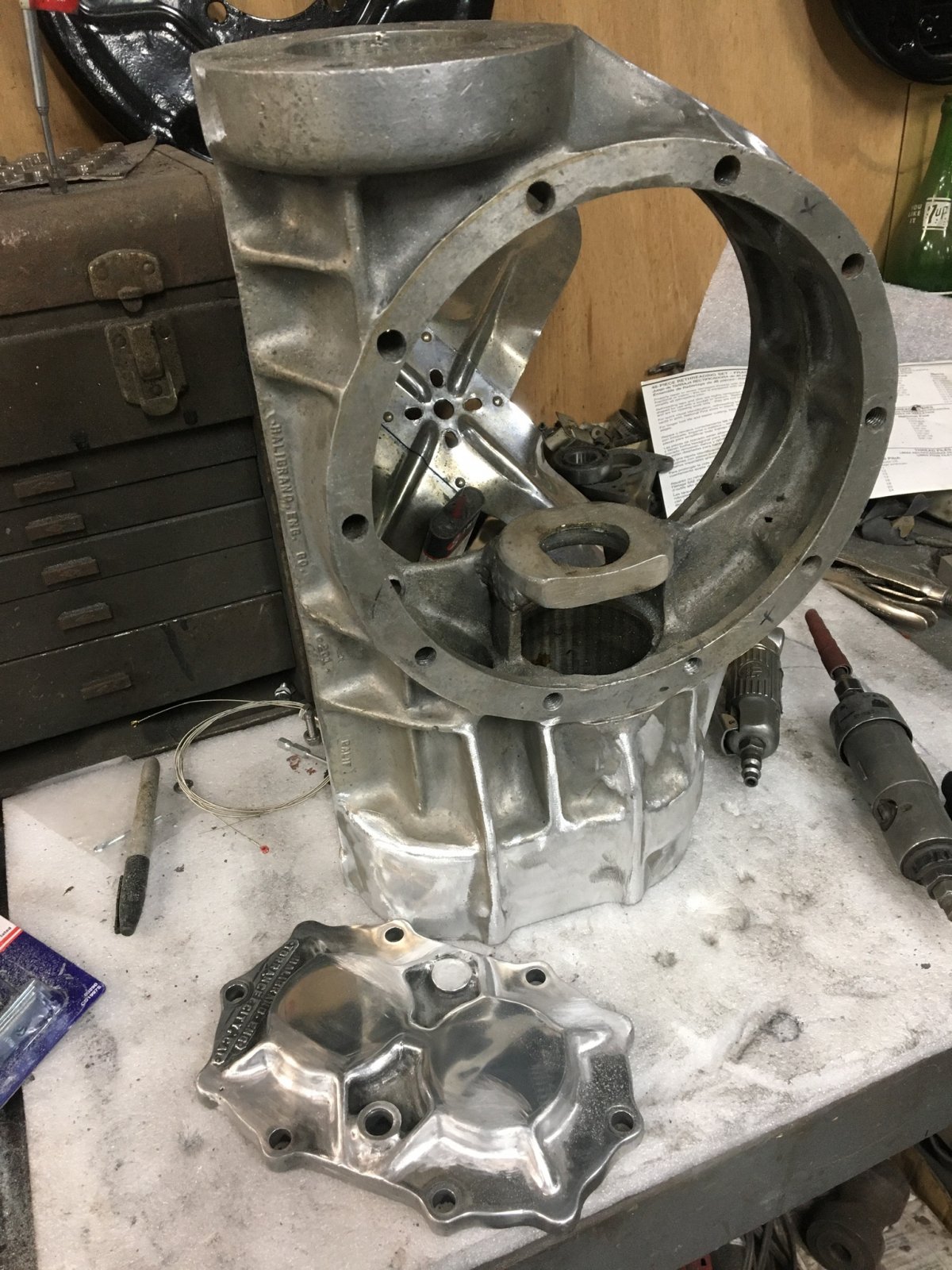

    Looks good with the welds wrapped around the corners it’s probably stronger than it ever was even new.
    That shows that even the housing posted earlier could be saved.

    I would think so too. This one is going in the restoration of the bob hamke t, original hot rod raced at bonneville in the 50s.
    CF372D13-B953-45AD-A009-B8600F27DAFA.jpeg F6AE9773-B4BF-4B56-A89D-CC935B4EF346.jpeg
    I’ll bet you are, Winters makes a great qc, I know this because I’ve had to fix a bunch of halibrands but never a winters haha

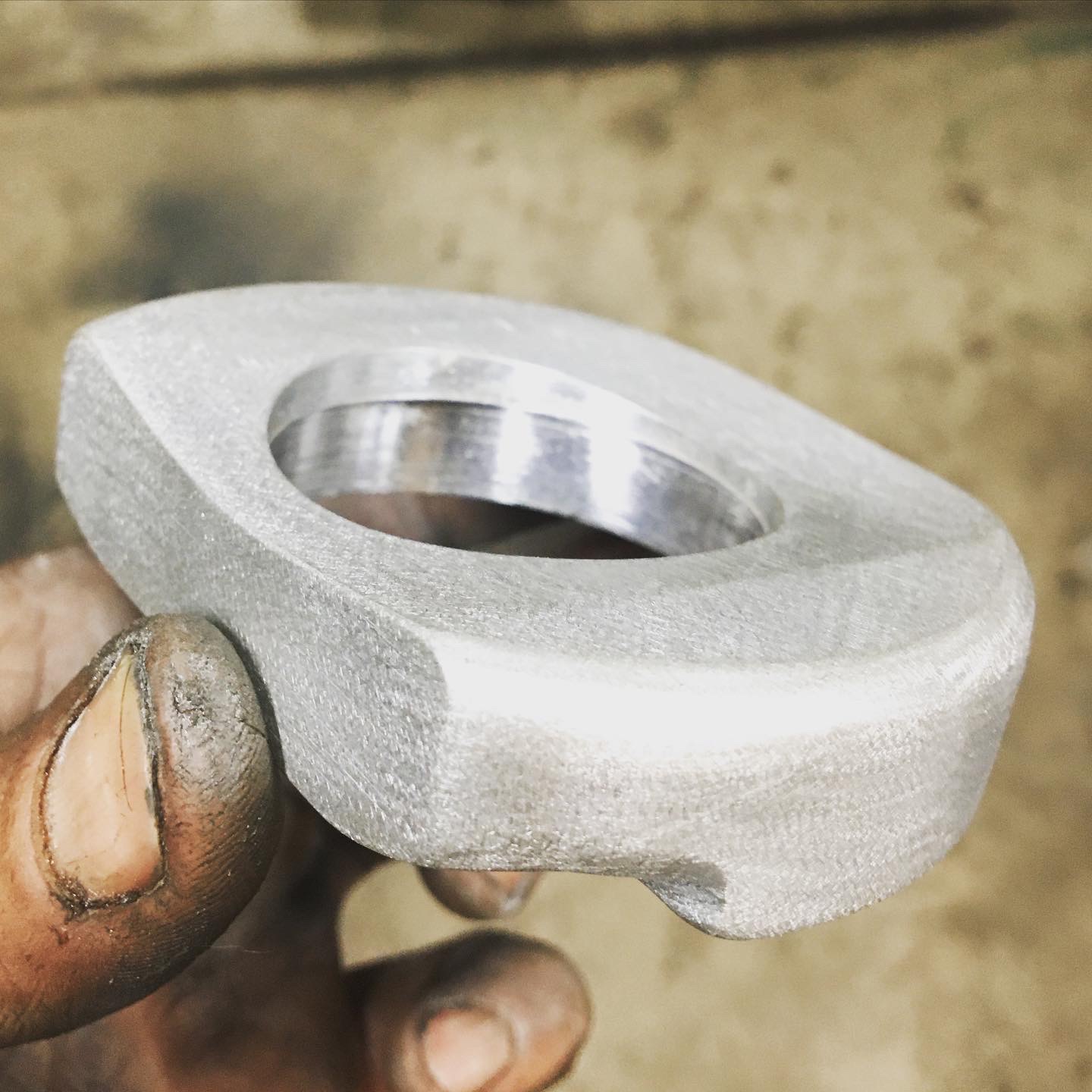

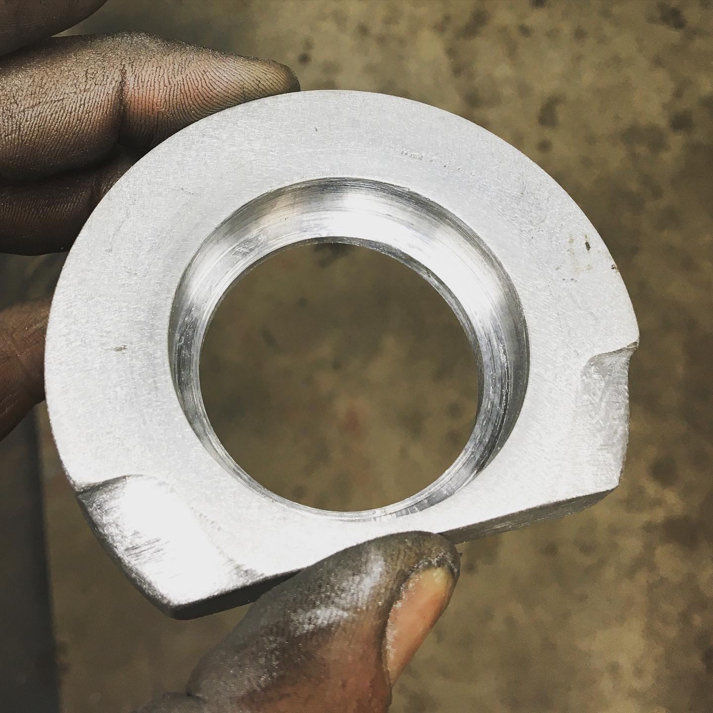

    that’s why I started tossing the old battered bearing supports and machining a new one and then welding it in, much easier to do the machining first on a small hunk of aluminum than on a big housing. I use an early ford pinion and bearings to hold everything in place, weld it all up on the outer surfaces, pull the pinion and weld the inside of the gear cage. Every time so far after reinstalling he pinion it can be spun by hand after all welding operations are done.
