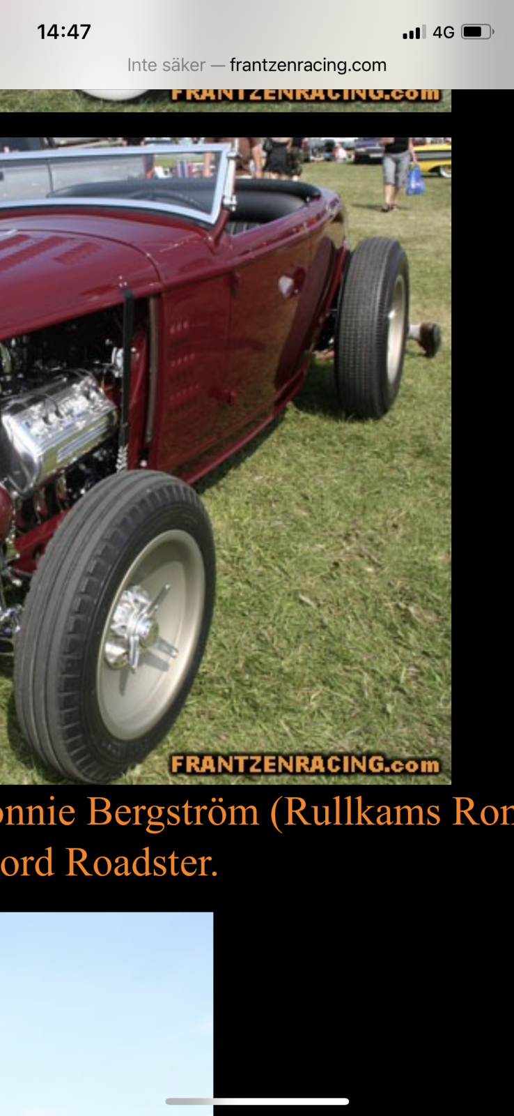

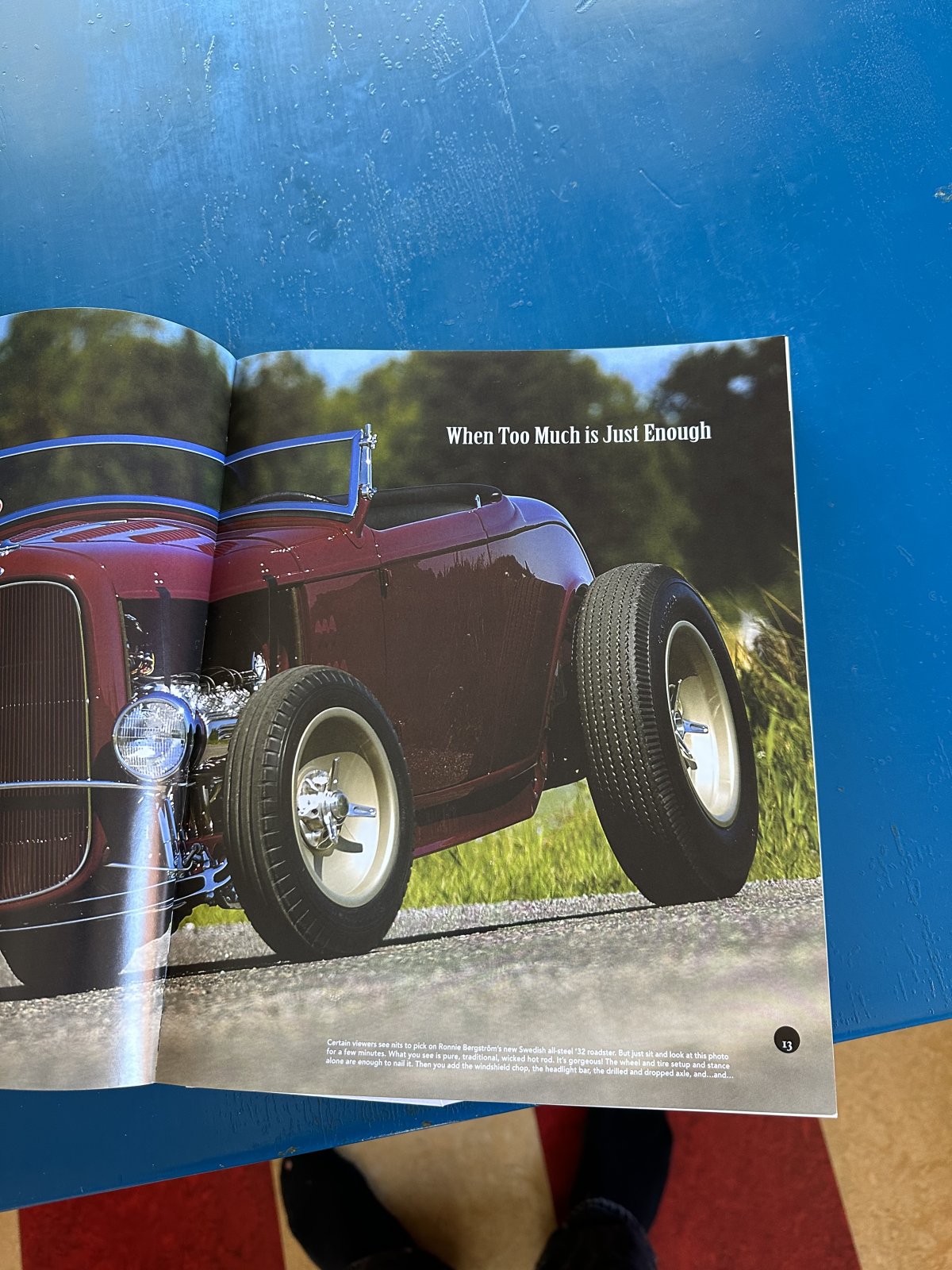

    I’m about to get a set of smooth side Halibrand wheels ( 16” )
    My idea is to keep my 16” x 4” steel wheels in front ( no hub cap ) as I start get that racy feeling just use the magnesium wheel at rear ( and it does fit perfect to my Halibrand magnesium banjo housing )
    This is a 3.5” chop 32 5W coupe no fenders in black.
    Its a all Henry car pre 1952 for ’LA street racing sceene’.
    Maybe some afford the rear wheels and Wing gauge and a Bell steering wheel ?
    I might get the Adurn head as planned a rest as they might not ’fit in here’ ( all according )
    If so it will be Merc 49 heads on the 59AB block and a GMC blower and a 8BA cam cover and a Scintilla magnet ( dual 97’s )
    As I plan chrome the heavy front axle but not much more but car will has Lincoln brakes so its on the edge vs the era...
    Anyway, what do you guys like that wheel set up ?
    This wheels is repaired and painted ( not shore whats behind ) so a idea, what about paint them in black ?
    I heard they came out ’gold coated’ from factory, or ? )
    Nice is the magnesium patina grey look.
    But it might be hard get there !
    ideas ?

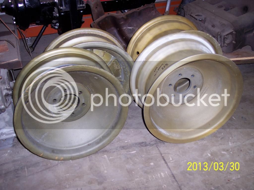

    Now I first saw a set of wheels that had the std Dow 7 on pictures.
    I guess this wheels came on race cars and few hot rods in the era.
    I don’t like paint them in a ’look alike’ Dow 7.
    Its said be a good undercoat for paint.
    The wheels I look at was painted 30 years ago and no corrosion.

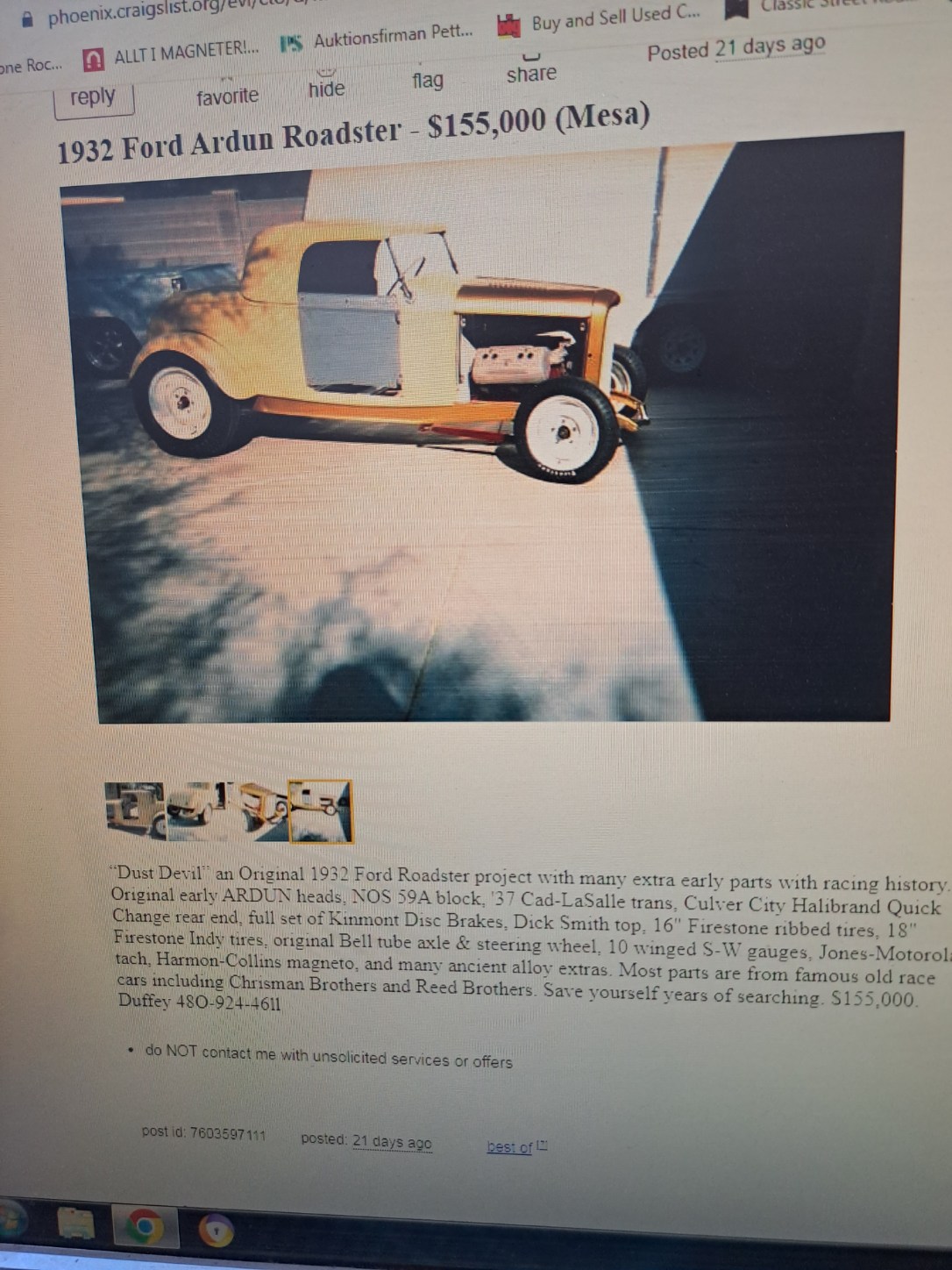

    Duffey’s roadster there is a collection put together from many different sources. He has been building that car almost as long as I have been alive. He knows his way around vintage hot rod and racing parts.

    Ok so its not s old car build up or stranded from early 50’a ( when this parts was for sale ) and I read the add and he say that it was collected but not ’when’.
    I wonder if he gets the 150K.
    I can get a Kinmont here and then I’m at near 100K, and a bunch of old junk parts on floor ( its kind of odd )

    Duffey lists his roadster, his 32 pickup project, and his fibergl*** phaeton on Craigs list every year during auction season.

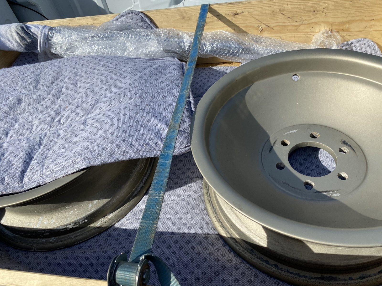

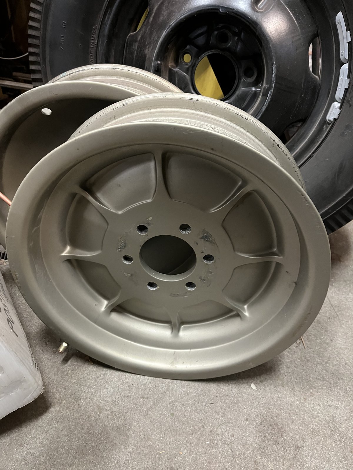

    I bought the painted set ( no blurr from metal after 30 years )
    No clue whats behind.
    5” x 16” and 6” x 16”.
    I can’t say now if in 4 corners of just rear.
    -Are into polish them and see what happens.
    Need to get rid of paint first then I must plug and re-drill them ( I like 5 bolted )

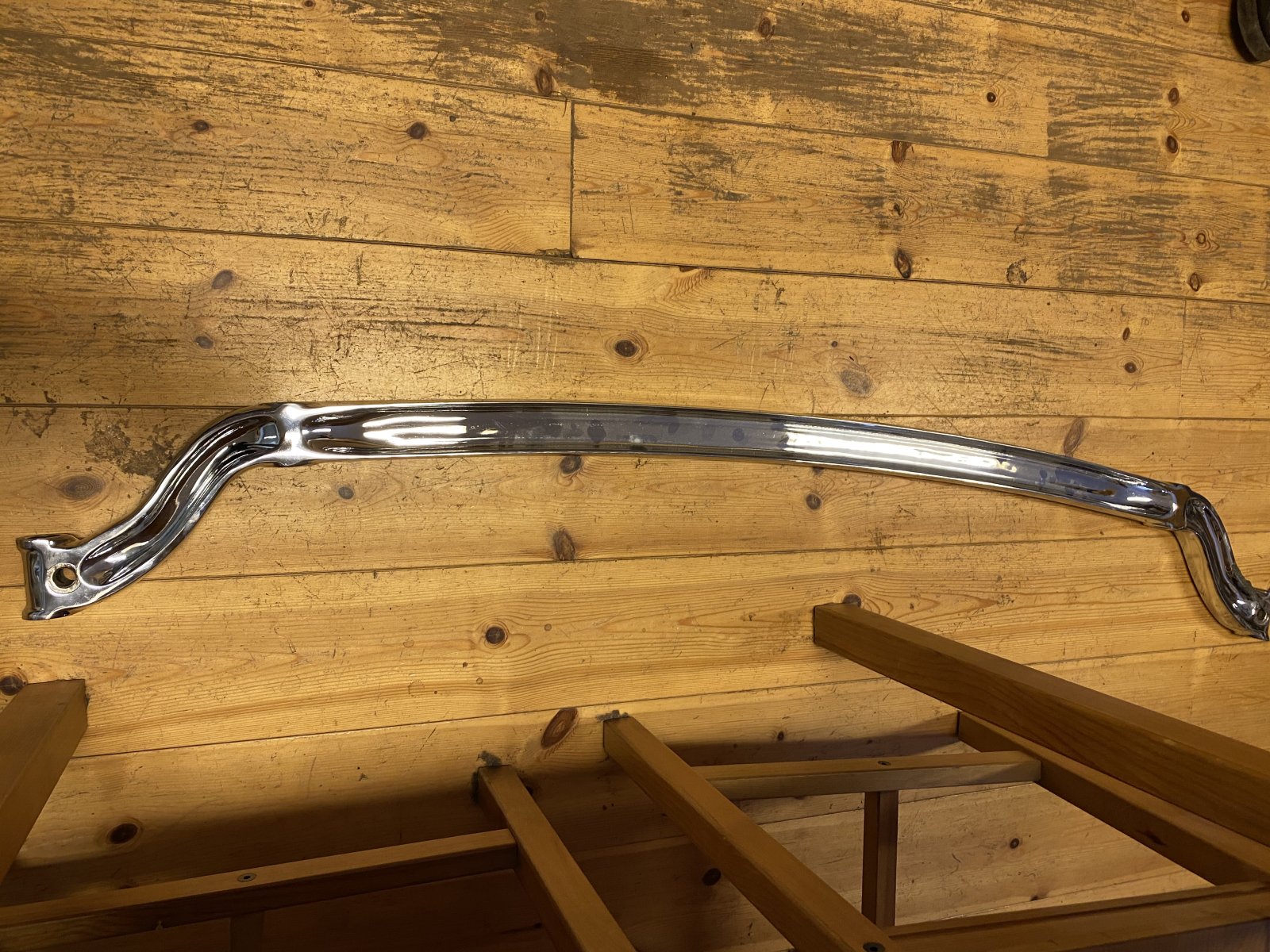

    -Also got home very cool dropped A-Ford old chrome axle.
    Now I has a dropped 34, a dropped 32 and this.

    why not get the correct hubs and 6 pin pressure plates instead of redrilling them? you can hold them on with a large hex nut if you're not a fan of the 3 wing knock off

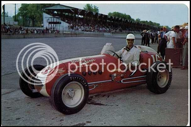

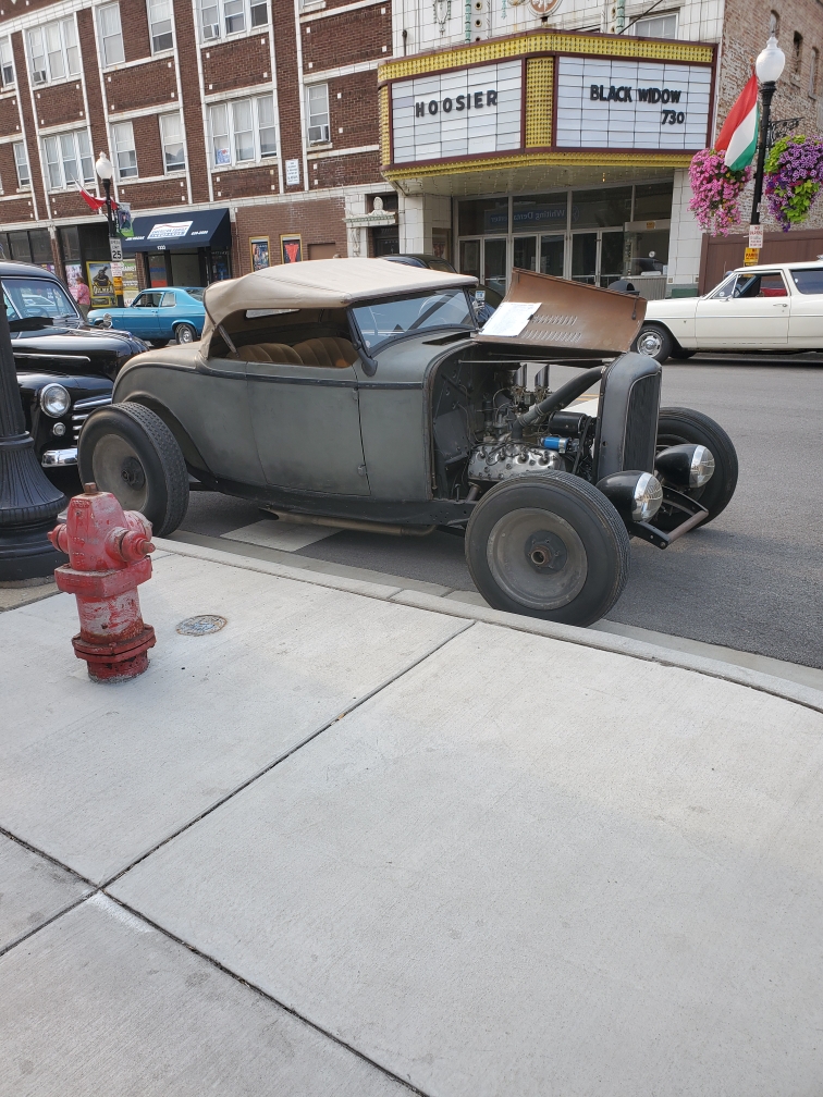

    wheels you posted above are pics i took, same wheel with firestone cheater slicks mounted

    a 6 pin wheel plugged and drilled for 5 lug and then converted back to 6 pin and held on by pressure plate and hex nut

    sorry for photo bucket watermark
    one last photo of roadster without the watermark

    Issue holes is both 5 lug and 6 pinned and a mess.
    Feel more ’dragrace’ 5 bolted.
    Will call company tomorrow use dry ice etc.
    Will start there.
    Paint is decent but some freight damage and I don’t like it fake Dow 7.

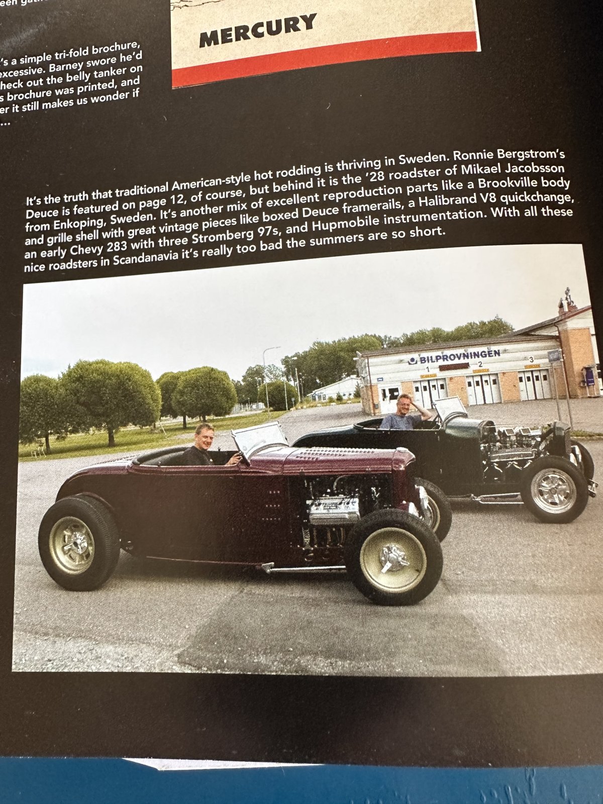

    Here is the roadster that was on 30 years ago.
    It was replaced with 50’s styles Halibrands.
    A Very cool car.
